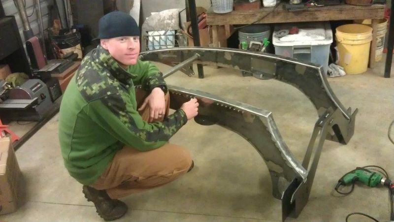

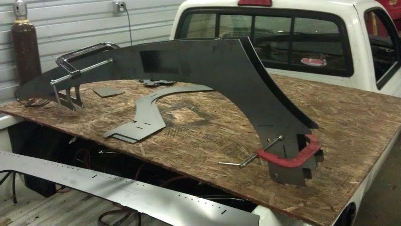

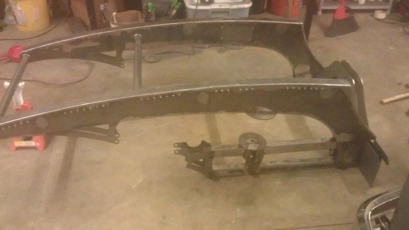

Started a customers ride FEB 2012... We are now great friends because of it!

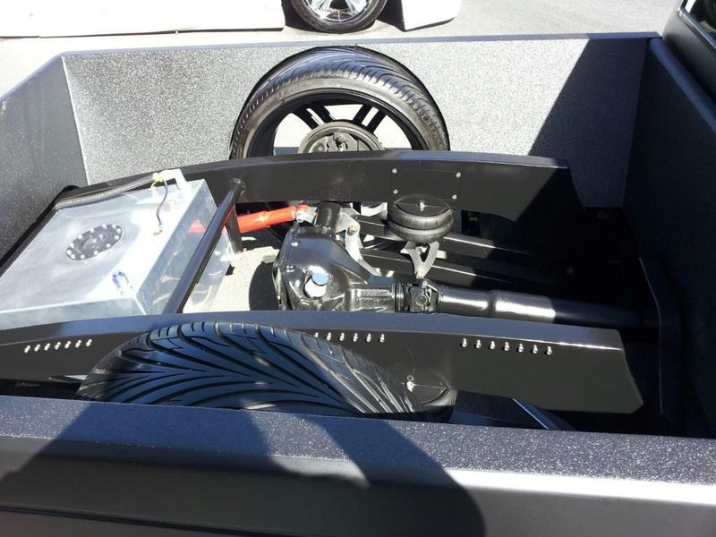

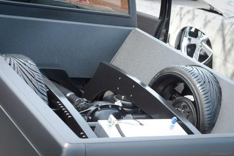

Thats a pretty sweet back half.
juicedwagon
awesome work! looks great!
mjavy7's avatar
mjavy7
Sick frame!
Love the finished product!
tre5's avatar
tre5

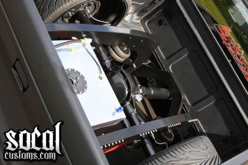

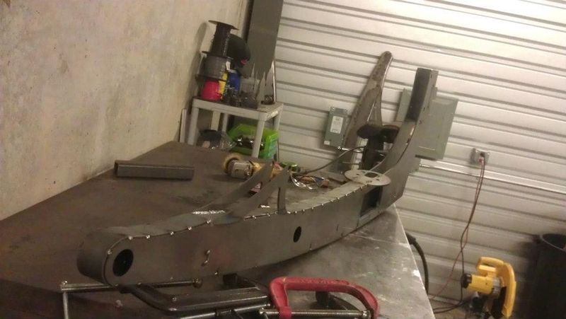

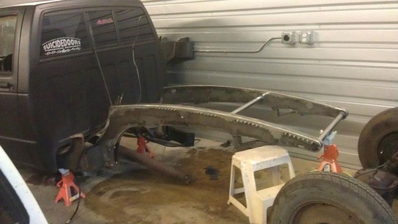

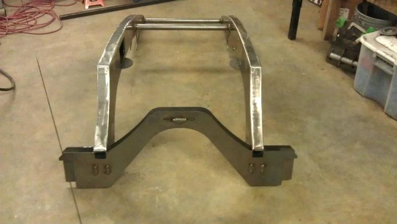

That frame is very cool and unique!

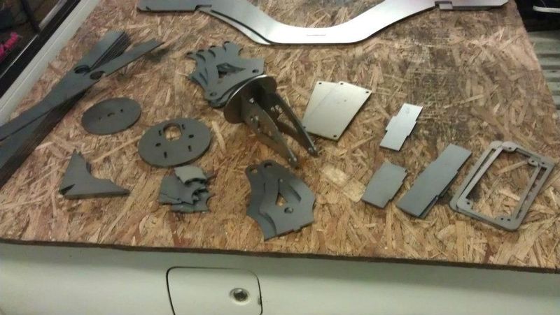

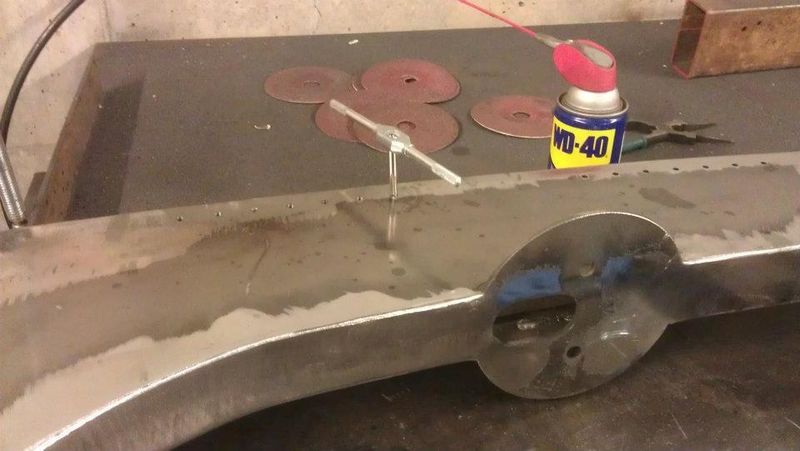

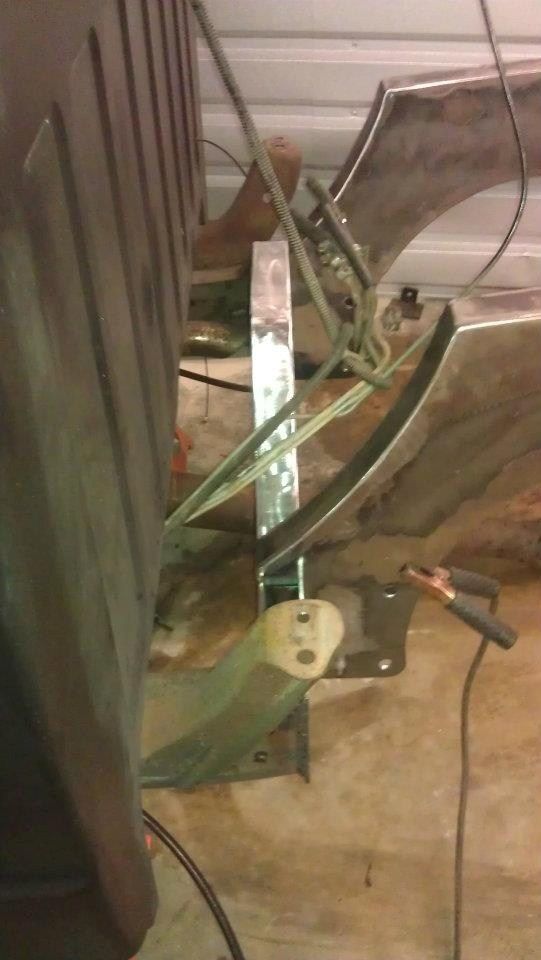

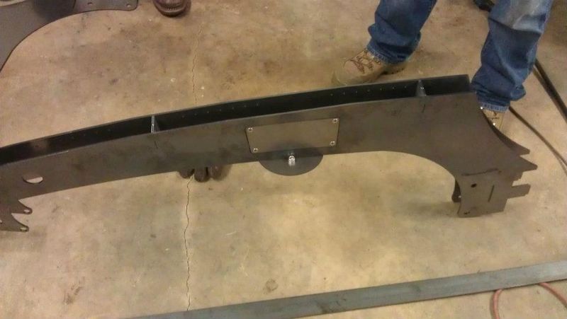

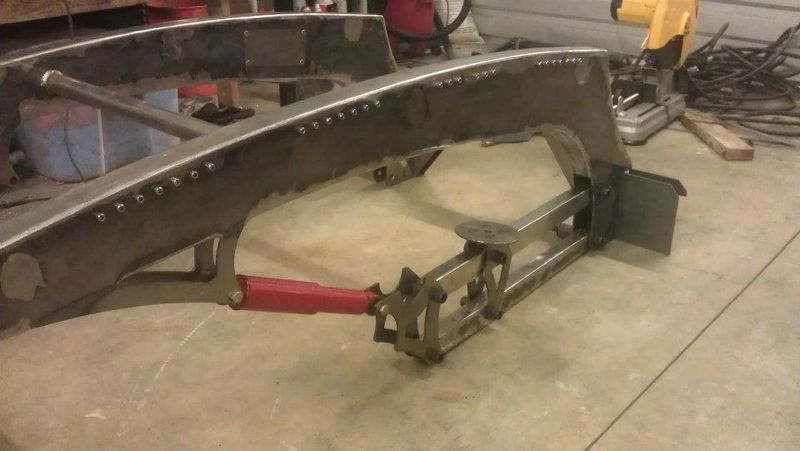

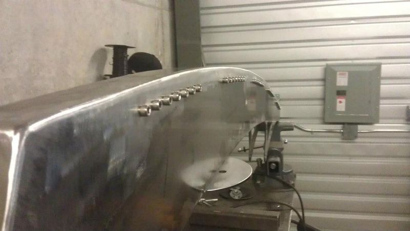

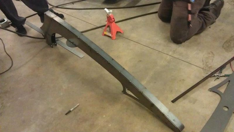

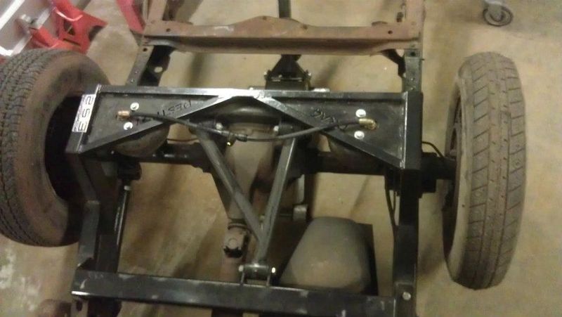

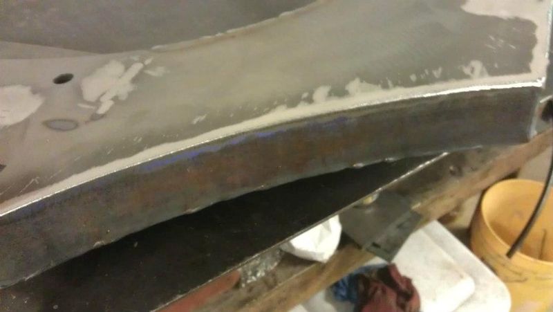

I have a suggestion for you though... Look into P&O plate. It's not much more than the hot rolled you're currently using. The nice thing is that it doesn't have that scale on it that is a pain to grind off.

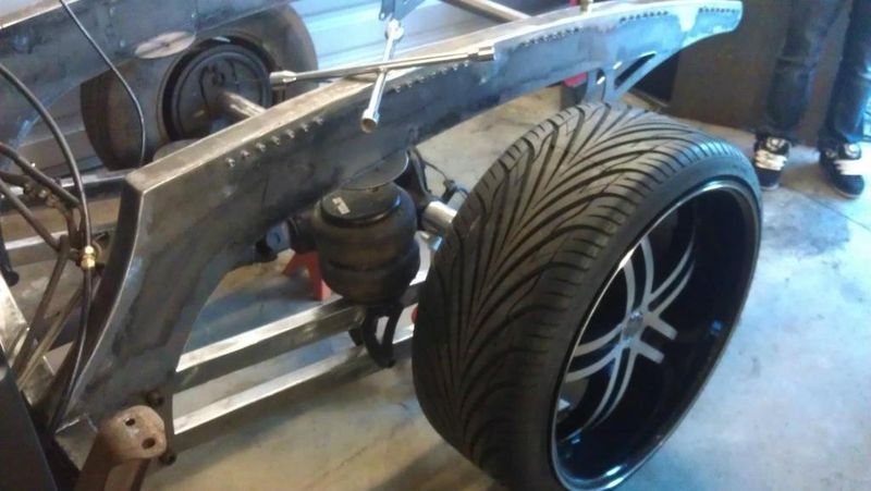

I'm guessing those shocks really don't do much for ride quality being they're past horizontal when the truck is laid out. Other than the shocks, I think that is one of the cooler backhalfs I have seen.
tre5's avatar
tre5

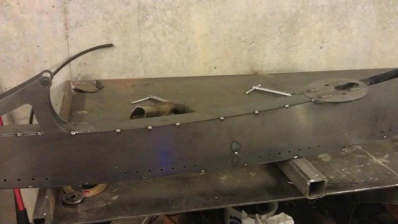

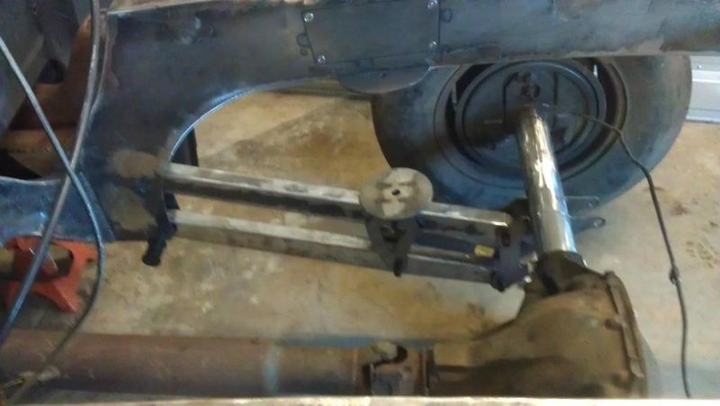

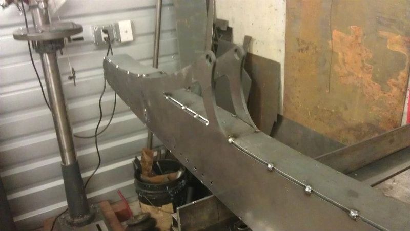

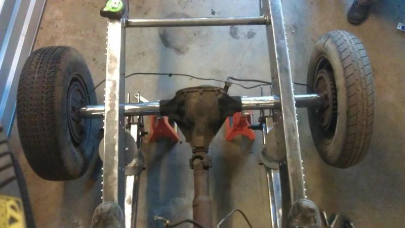

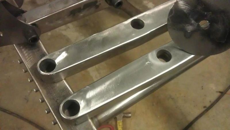

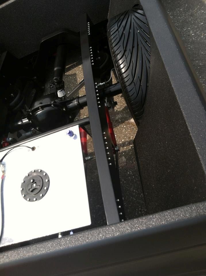

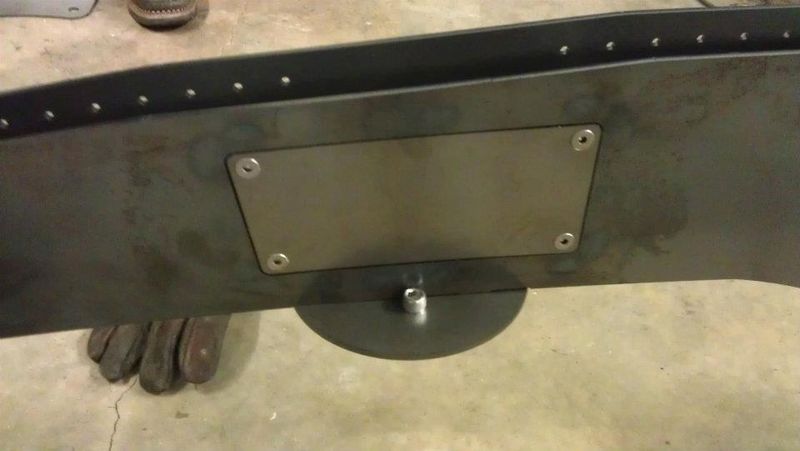

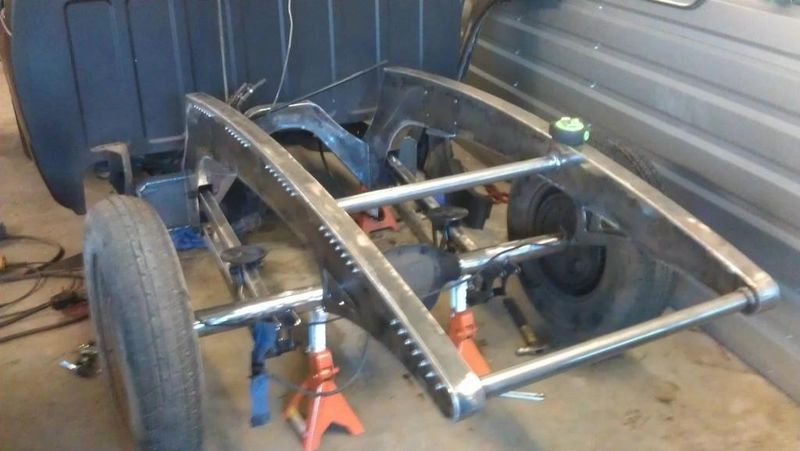

Oh yeah, what are all the screws for? And how are you keeping the axle centered?
Bentlay's avatar
Bentlay
in the third to last picture(looking into the bed from the back), it looks like there is a diagonal bar running from the front of the passenger side link bar to the back of the driver side link bar.
