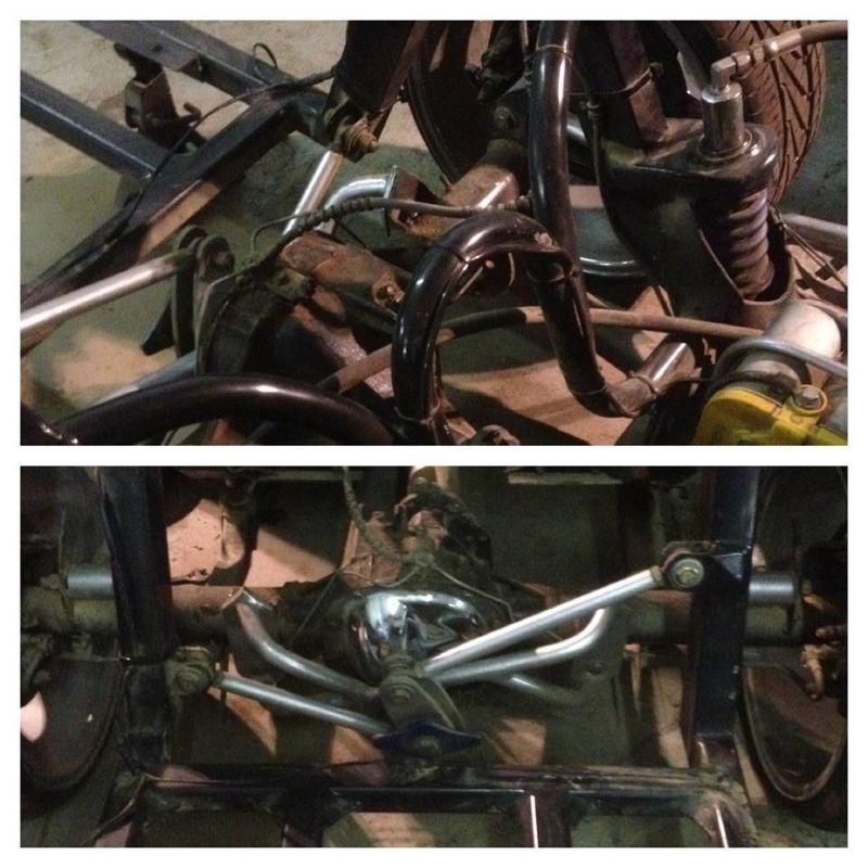

love how low the bedfloor is..what is it running a 2 link or what out back?
tuckinlugs06's avatar
tuckinlugs06
irs i think

I have to ask.. where's the gas tank? Awesome truck. Can't wait to see it painted.

Master Fabber

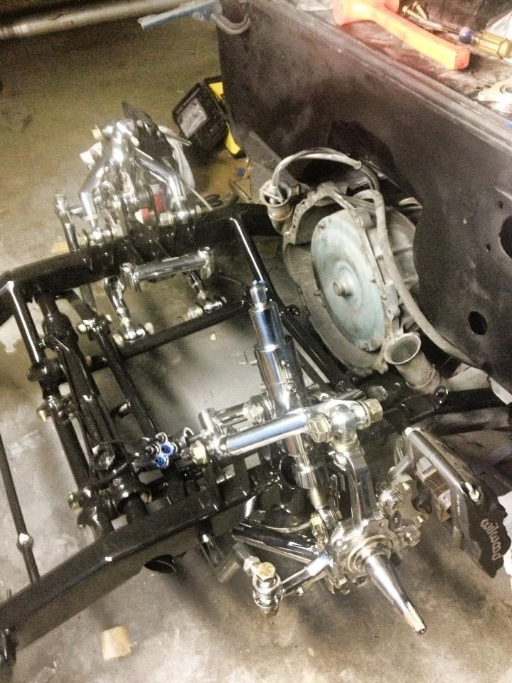

Hey there, I can answer any questions about this truck, as my boy Jonah pretty much master minded the thing. There is a 60s ford fuel cell in the cab back wall with the filler in the roof. No 2 link. It has a 4 link with a watts linkage and the upper bars run up through the frame rails. Yes inside the frame rails you heard correct. Also the front suspension uses a rack and pinion cradle setup and completely one off front suspension. So Crazy and Innovative. Glad to see someone is going to finish it out and maybe get a little credit for what was done to it. Later

In the 5th picture upper left you can barely see the clear tubing for the fuel filler

Bad ass! I like the idea with the gas tank. Definitely not an IRS, no camber at all.

only pic i have of the rear setup right now
