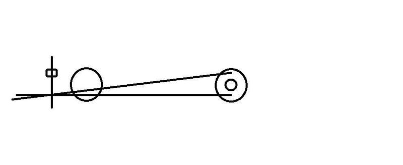

Got another question regarding the instant center.
The lower link bars are suggested to be paralell with the ground at ride height, but if they are set truely paralell with the ground then it seems to me that the bars would intersect lower than the bumper... are you guys pointing the lower bars slightly upward to compensate for this or is it commonly overlooked?
flnole78's avatar
flnole78
You want them to intersect at the bumper as viewed from the side. So you keep the lowers parallel to the ground at ride height then you angle the uppers down to where the intersection is at the same point as the bumper. You don't worry about the height of the bumper. See if this drawing helps at all.
