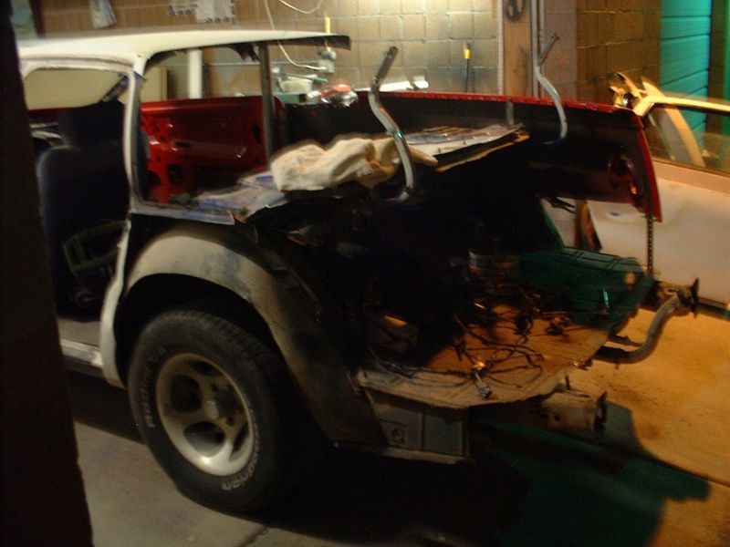

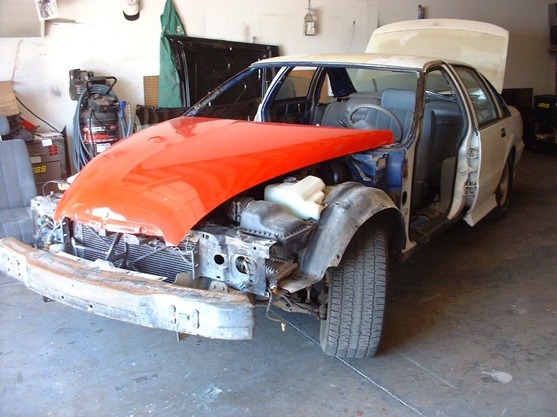

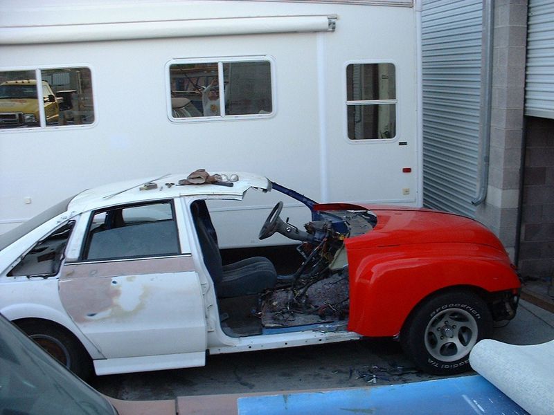

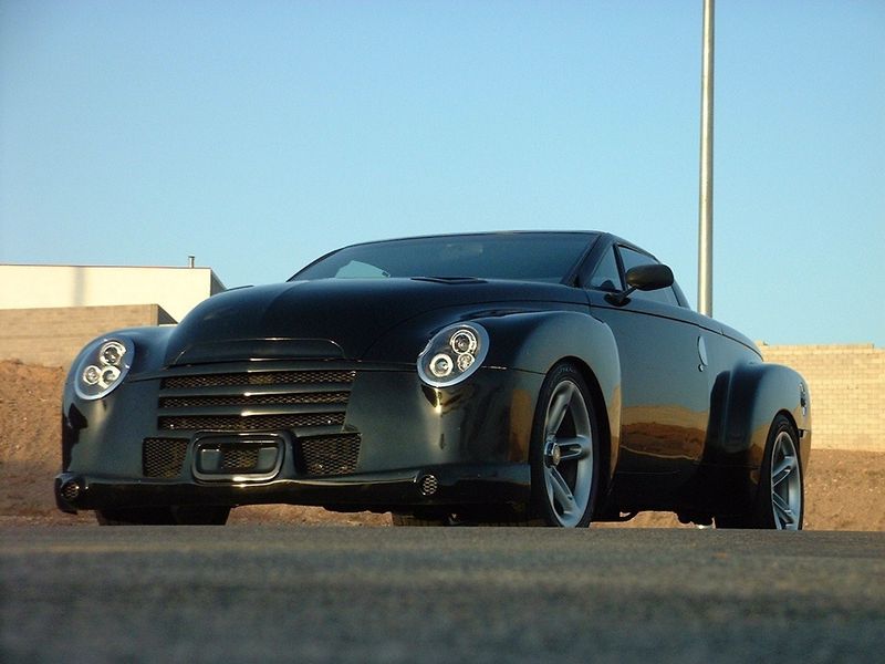

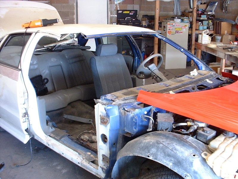

ZZR is not a truck, it's a 94 9C1 , but it looks like a chopped SSR.Quick run down:top is 11" lower than that of a real SSR. it's not retractable, just a lift off.Hood is 8" longer. 1/4 panels are stretched 1.5" to fit the longer 9C1 wheelbase.The front end is all custom, Mini Cooper headlights are used.The front spoiler is retractable http://www.youtube.com/watch?v=c_wWS_EblH4&feature=plcpThe overall design is of course continuation of fabulous work by GM, who did SSR in '48 truck tradition. http://www.youtube.com/watch?v=qJkJi12687s&feature=context-cha
The rear rims are widened by 2" therefore 335/30/20 are in place http://www.youtube.com/watch?v=Ak0P6Z45PnY&feature=plcp I see the links I posted are only can be used as ''cut and paste",still learning the site..
ZZR's avatar
ZZR
Stilll trying to work the site, my pics did not appear in the first post, and when "Edit" there is no option to add some.
So, try again:
couple of pics before and after ( 3.5 years in between).
