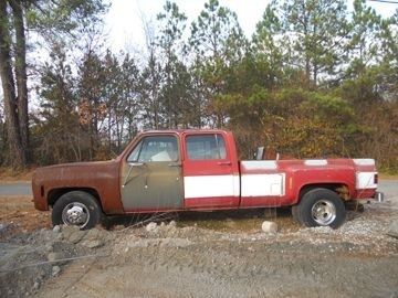

Hello everyone, i have a simple question. What's involved in getting an old old body c30 dually to lay out possibly on semis? I have had the perfect project truck insert fall in my lap this morning. An 86 chevy with a fairly new rebuilt 454. Plenty of real patina going on. Its running but has been sitting for years. Hoping i can get it home this weekend. If bagging it is as straight forward as i hope i may be sidelining my ranger project yet again to have a cruiser for this summer. Thank you all who respond

I guess im just fishing for info to help me come up with a game plan. I KNOW its gotta lay frame and be on bags. Semis wont be inthe budget yet but based on info im seeing i will probably look for a shaven set of 22's. I read somewhere a long time ago that a rear from a cab/chassis or box truck is narower... Any trueth to that? Without getting into the 2or4 link debate, ive seen in posts duallys done both ways... So could i go economically the cheapo route? Are the dropmembers and arms the same as a c10?
