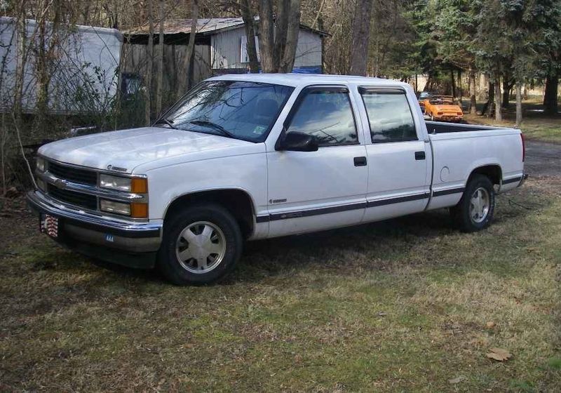

just look for a centurion conversion. they take a regular cab and make it into a 4 door short bed. they've been doing it since the 60s I believe with/for GM and Ford. my friend just bought a 97
they didnt make many, so you will have to search a lot to find one. the one my friend found was on CL in Nevada. he had it shipped to south FL
a sample from searching google images
