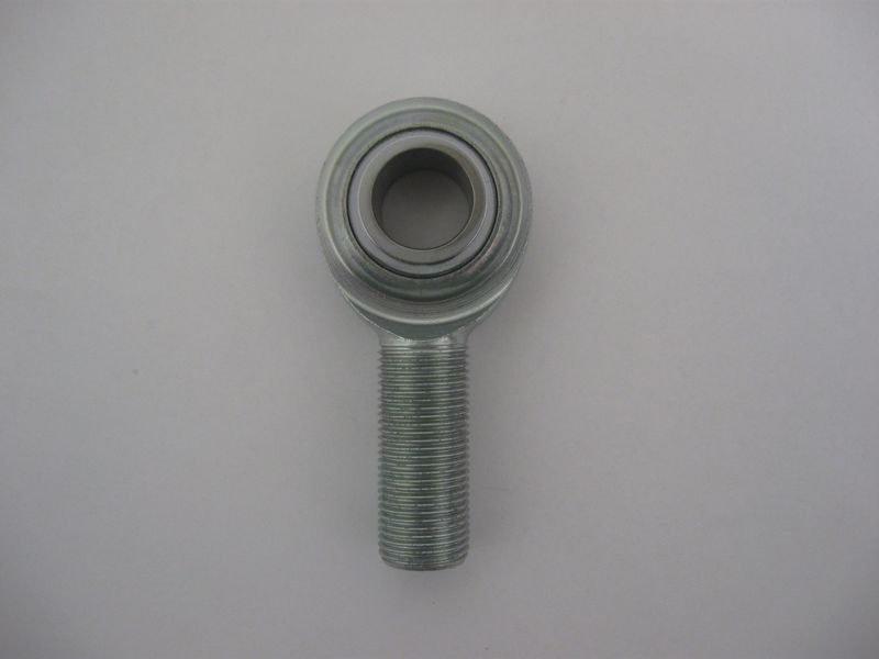

I need a bracket for a heim joint, roughly 1"wide.All the brackets I've seen are for heims with spacers...
I don't need spacers.Where can I buy a premade bracket to weld to flat tube?

I have 3/4 x 3/4 rod ends.http://www.qscomponents.com/34mr.html
I'm looking for a bracket that they will fit in without the need to buy spacers.(And an inexpensive one, say ten bucks each or so, not $50+)Is there such a bracket, or are they all designed to use spacers?

In most cases, they are intended to use reducing spacers that will take that 3/4" bolt size heim, to 9/16 bolt or 5/8 bolt, then you can use any bracket you want that anybody sells.
If you want a pair of brackets, to work with your .750 heim joints and use .750 brackets, you will more than likely have to drill out a normal 9/16 bracket.

Hey bud. Chassisengineering.com C/E 3897 3/16" tab with 3/4' hole and no notch . Hope this helps ya out. JR

I can enlarge the holes easily enough, it is finding a bracket roughly 1" inside width that I'm having trouble locating.

The brackets are seperate pieces, you can weld them to any width you want. Its not a 1 piece bracket, its a tab on each side of the heim, welded to what width you specifically need.
