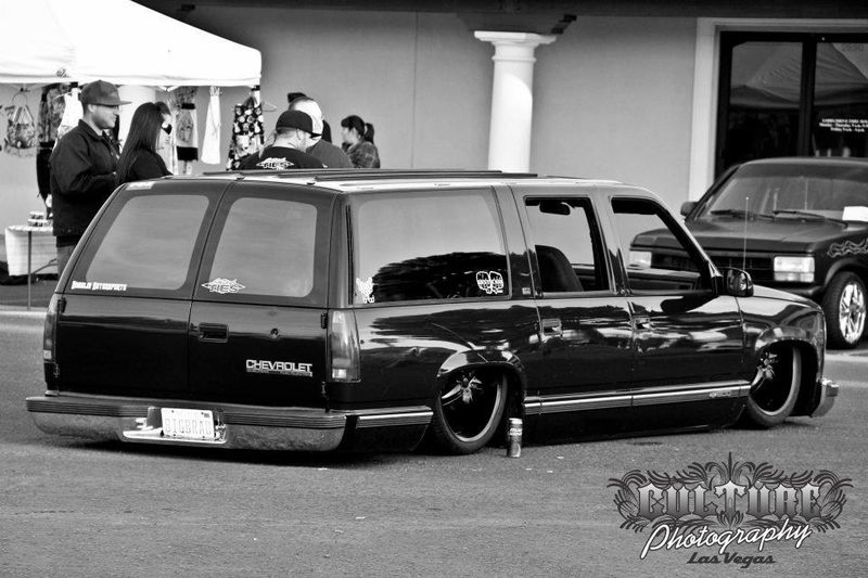

my 92 has a 3 inch z and is stock floored had to relief cut the floor for the trans and had to build a full driveline tunnel. also 2 linked mine to save the floor and the bars come thru the floor just a little under the backseat. i know mines a newer body but hope this helps to convince u to body urs while ur at it...
