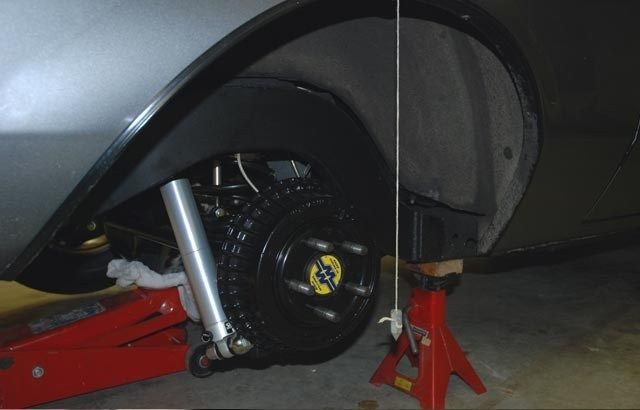

Well not sure if it will help but the best way i've found is something like this. you'll want to mesure from where the wheel mounts to the edge of the fender.
this is just a pic i found on google. that is one way of doing it the other would be to tie a wieght to a string and hold it at the lip of your fender then use a mesuring tape to see how much space there is from that string to the hub where the wheel mounts. for example say you have 3 inches from the lip to the fender and the wheels your looking at are 8 inch wide. a 0mm offset means the hub mounting point would be 4 inches on the front of the wheel and 4 on the back. something to remember is that there is 25.4 mm in a inch. so with the wheel and space you have you would need at least a 25mm positive offset so that the wheel would have 5 inches on the back and 3 on the front. in a case like that i would try to find a 30mm positive offset so that the wheel tucks in the wheel well almost a half inch. you will find that not all wheels will be made with the exact mesurements you have so you'll have to find the closest thing to it.hopefuly this all makes sence.

This is more what i was talking about. once you have that mesurement you'll know how much of a offset you need. just remember theres 25.4mm in a inch. every wheel company puts there mesurements in mm for some reason.
