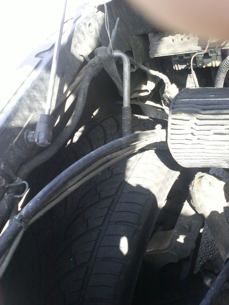

ok so ive raised my control arms front wheels arnt all nasty camber anymore but now my passanger side tire is ohh bout a half inch from hitting my high pressure ac line laid out . does anyone have a fix for this and maybe some pictures of what they've done . and getting rid of my ac is not gonna happen !!! im fat i sweat !!!

i got a fitting from napa and cut my line on my 02 ram and re routed it
jeebus @ mmw's avatar
jeebus @ mmw
I used a swagelok fitting that converted the line, to a JIC fitting, and ran a stainless braded line around.
But to be honest, i drove my truck with the line zip tide up out of the way for the longest time. It worked fine, but it looked terrible. when i painted the truck, i made the new line and made it look pretty.

KRZYTRN02
what im dealing with ! need to reroute it so i can put tubs in .

You have to remake the line...I took mine to an AC shop and had it the line made out of rubber...they brazed everything together and it worked flawlessly. Just make sure you keep the Orifice tube in the line. That section of line has an orifice tube in it.
