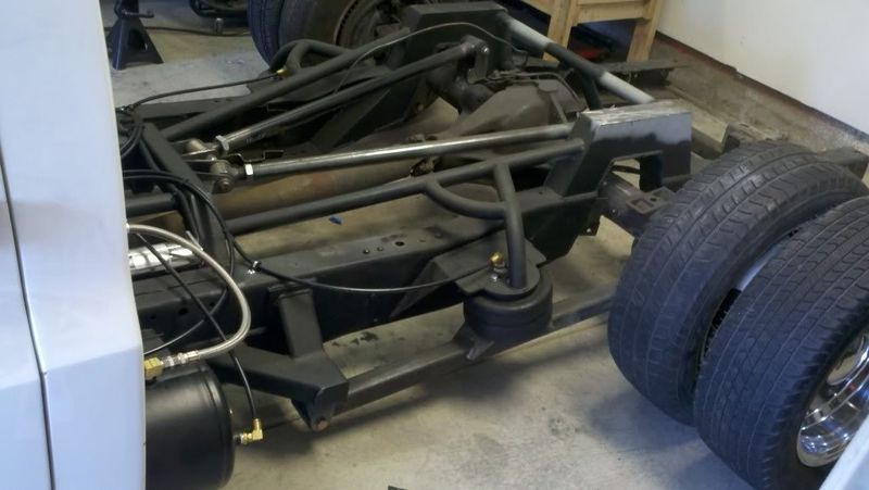

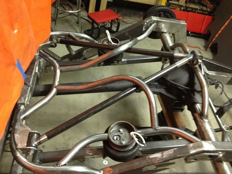

Just try to keep the bag as center in the bar as possible. Best lift and best ride, like stated above. Also, if it's round bar you're gonna wanna gusset the length of the bar since all the pressure is there. Here's 2 that I've done and I really prefer this method honestly. Good luck.

My link bars are round both top and bottom. The bar gussets are one of the only things I haven't gotten yet. But the pictures help a lot!
I like the tube work in the second one. I think I may need to get a tube bender now.
