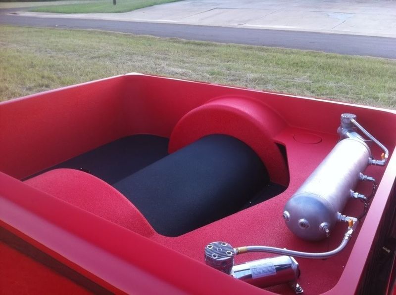

this is over body filler that was primered with no problems
as far as the rust goes use some rust cure or rust converter to kill the rust then prime it and sandIt will adhear to any painted, primered surface just as long as its sanded well
