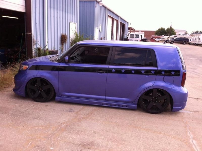

IMLOWER's avatar
IMLOWER
heres my wifes xb bagged on 20's used slam re6's out back and universal air strut bags for the front and just modded the strut to get as low as posible with it
