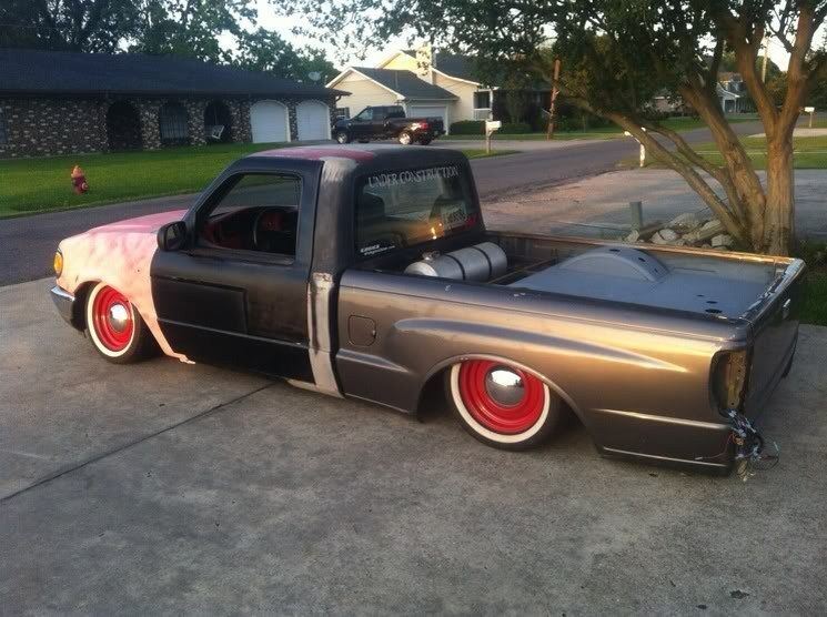

I've been building my Ranger over a year now and I thought I would start a thread to show the progress of the build. I bought the truck in June or July 2010. Since I've had the truck it's gone from stock, static drop, wrecked, rebuilt, bagged and eventually it'll be sfbd with a 5.0 motor swap. This entire truck so far has been built by me along with some help from my father and friends. All the work has been done with a 110 Lincoln welder and an angle grinder, haha. I am proud to say that this truck is 100% drive way built. Anyway this is how far I've come and I still have so much further to go.

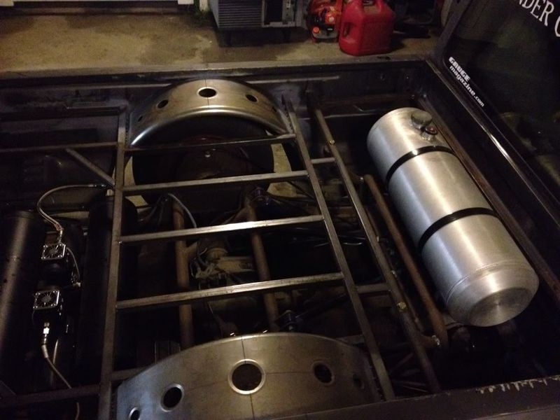

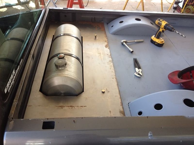

Fabbed up a fuel cell mount
Fuel cell mount all welded up
Before the fuel cell was bolted down
Ran some temp air lines and relocated the battery to the rear

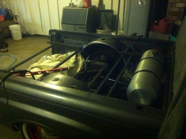

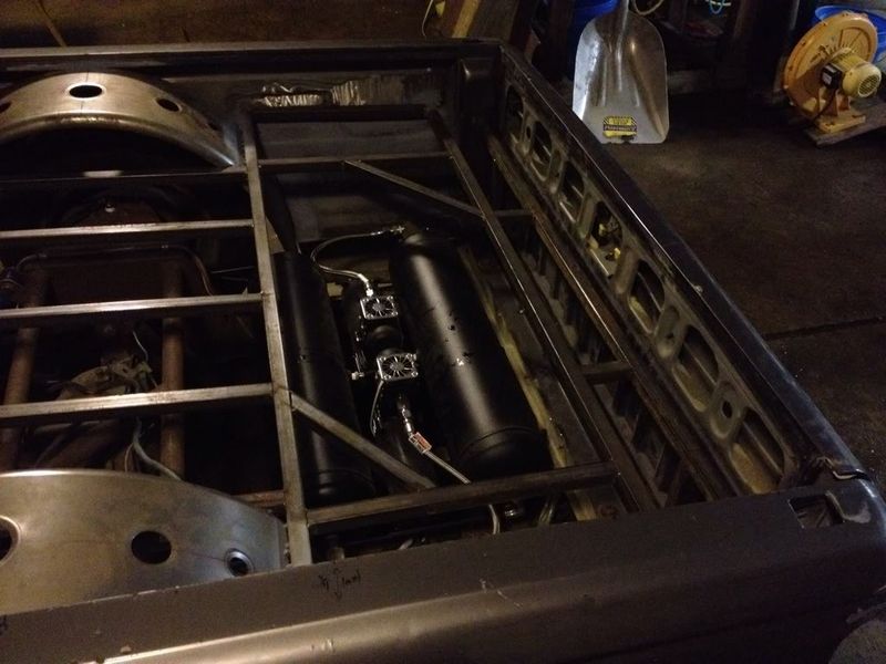

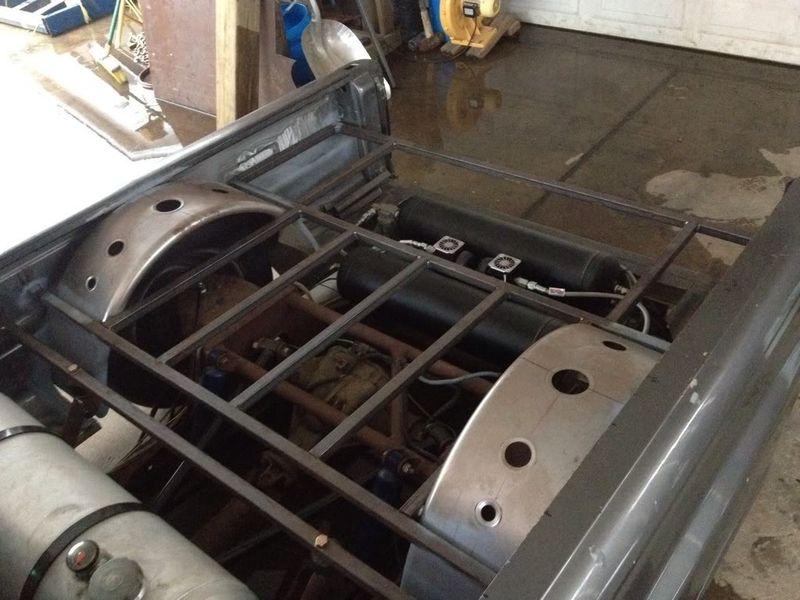

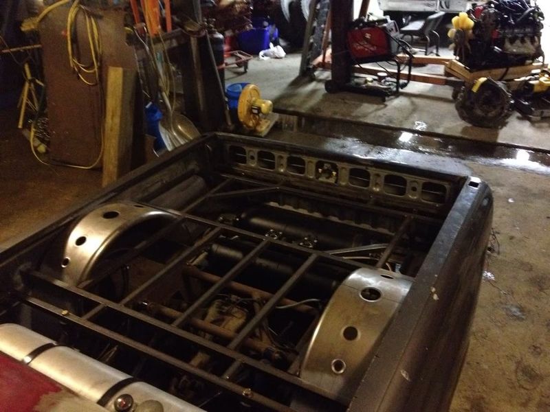

I had to cut the bed out to make room for the air tank, notch, and fuel cell. Pretty much the entire floor was cut out. Ignore the horrible cuts. They will be fixed one day when I sheet metal the bed. They were done with a sawzall and an angle grinder, pain in the ass.
Bed mounted and shaved gas door.

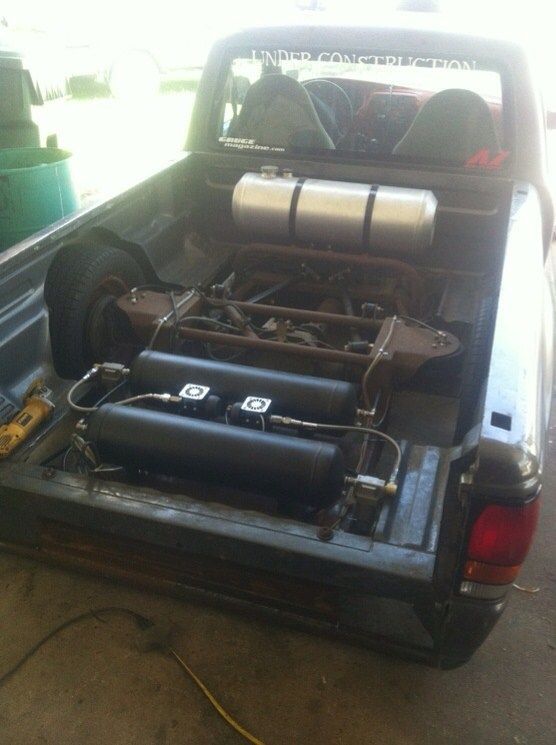

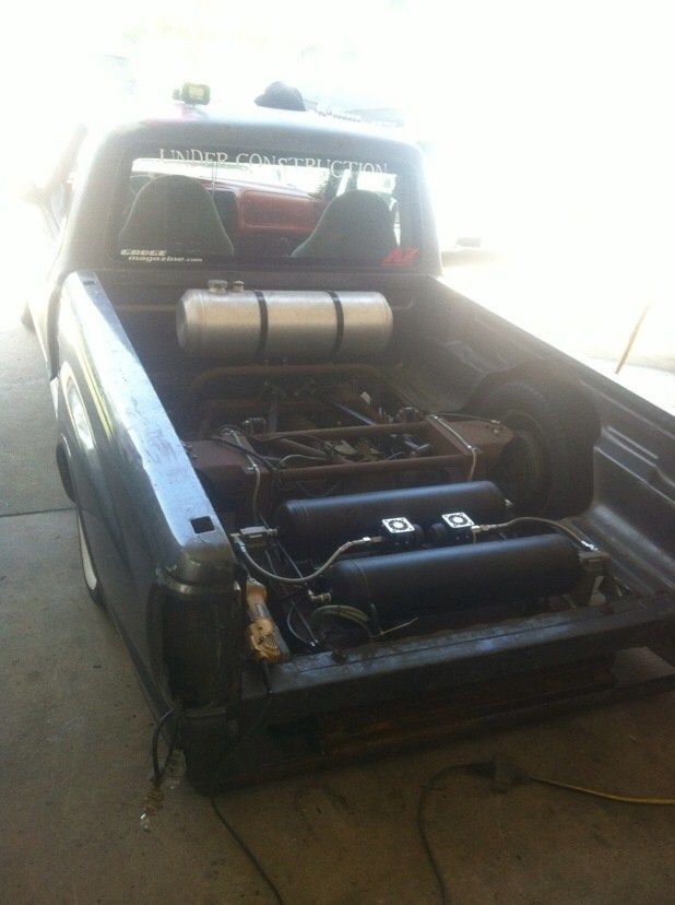

The new rear set up. Broke down the other one and moved the compressors and got rid of the eight gallon tank. Just gotta add the second five gallon tank. I think it's cleaner this way. Also moved the battery back under the hood.

That's the progress of my ranger build as of 1-23-12. It's come a long way from a little over a year ago and it wouldn't have been possible without the support of the FPC Crew, friends and family. Everyone that has supported me and helped me out in anyway through out the build so far, thank you, you know who you are.
As far as future plans go:Finish up the suicide doors and install my shaved door kit along with the suicide safety latchesStock floor body dropOne off full custom chassis5.0 motor swapUpgrade to air zenith compressorsMisc. upgradesAir gaugesRight hand driveFull sheet metal bedCustom dash and interiorDifferent wheels maybe?Shaved body linesPaint
Who knows how it'll end up only time will tell but I will keep this thread updated as the build goes on. Thanks for looking.

Your four link is all wrong! Your upper bushings are at two different angles and your instant center at ride hight is at the back off the cab.
Edit if you need some motor mounts i sell some that bolt to stock 4.0 motor mounts.
drpitlo's avatar
drpitlo
Good work on making repairs and doing your suspension but like strada said your 4 link is off your forward end off the bar ends need to intersect somewhere around the front bumper if you draw an imaginary line. How yours is set up now they will not ever intersect because your upper bars are so high.

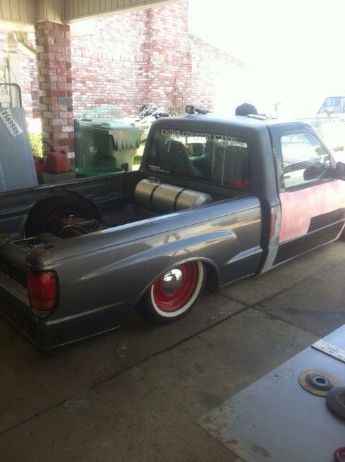

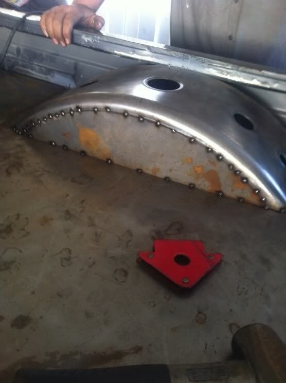

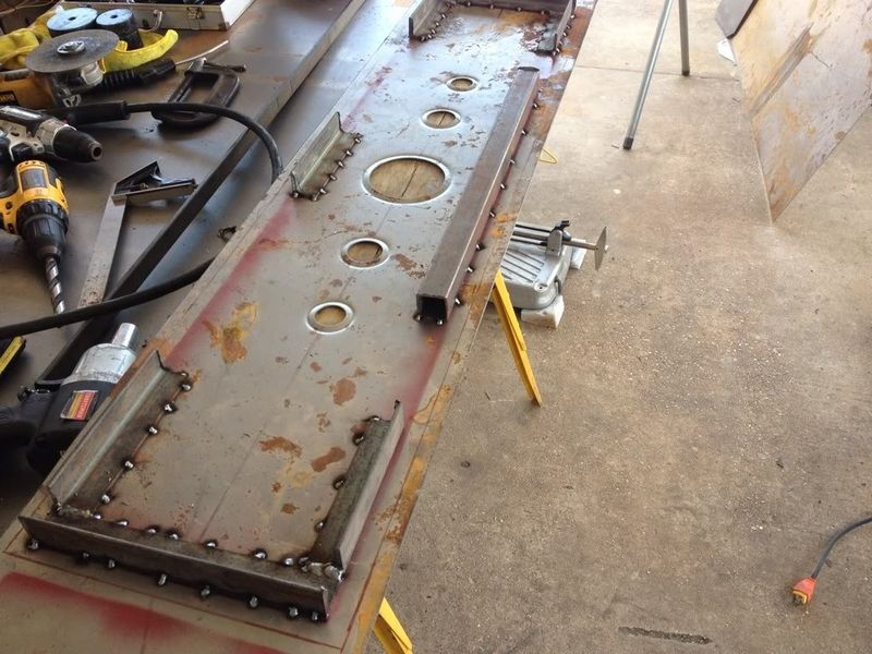

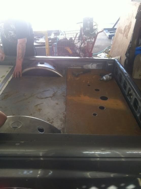

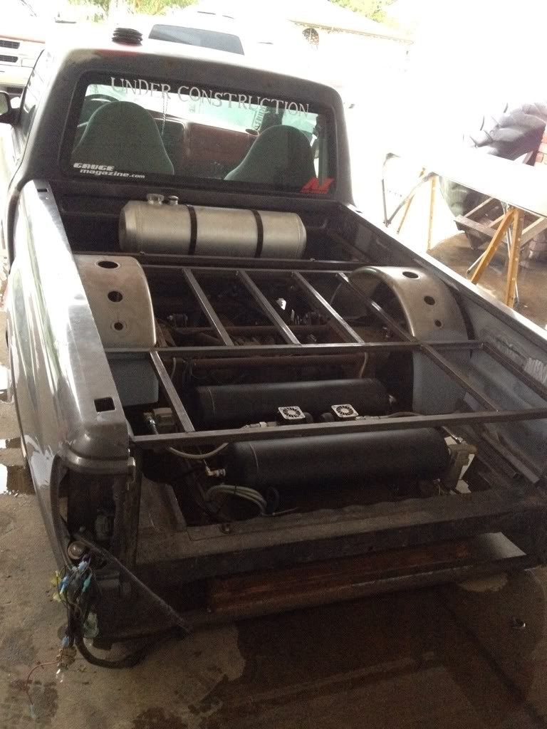

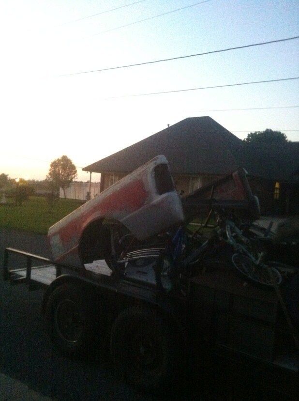

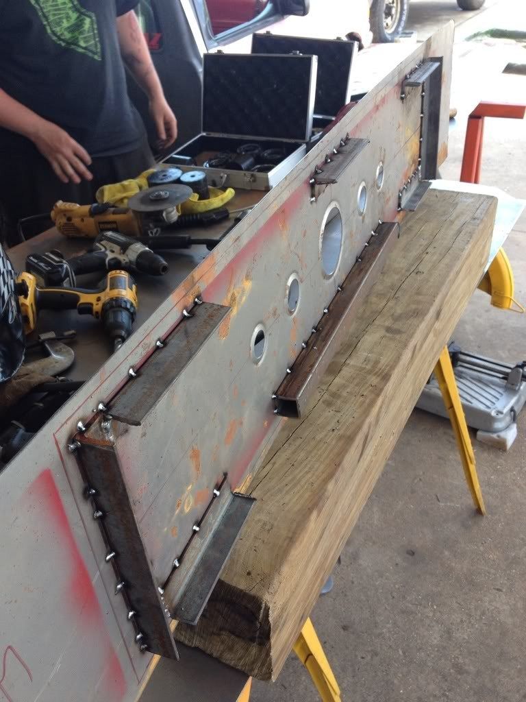

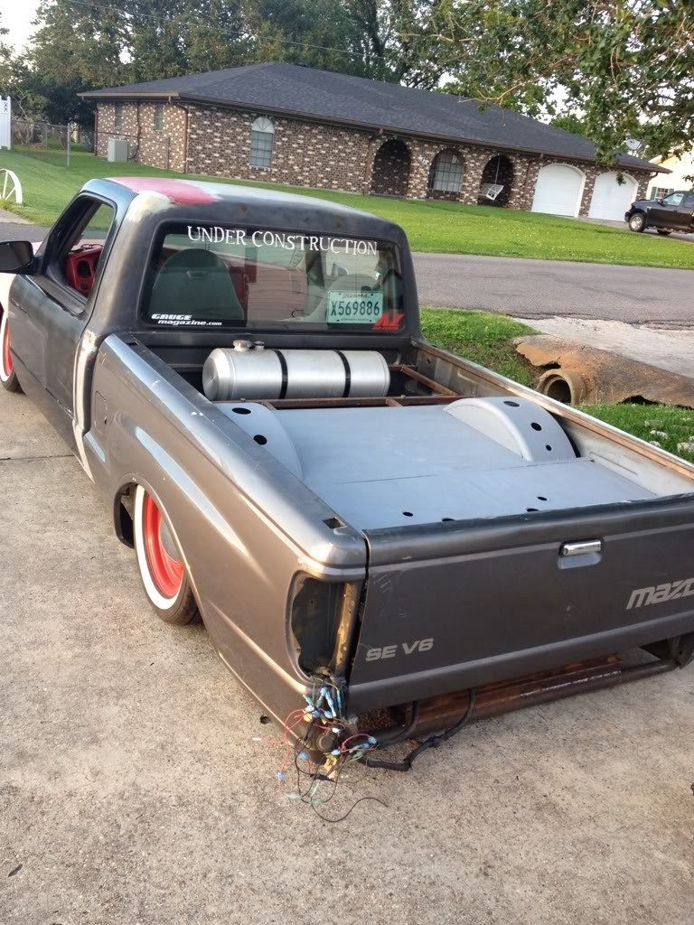

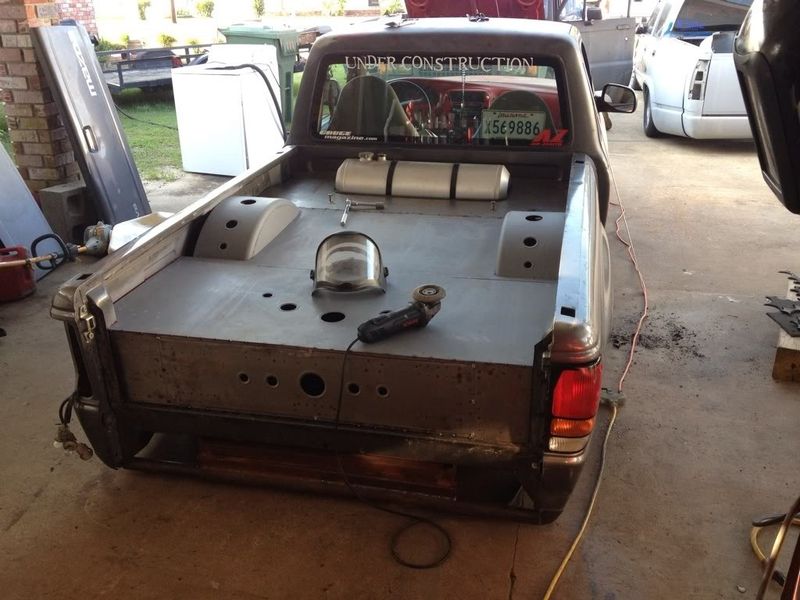

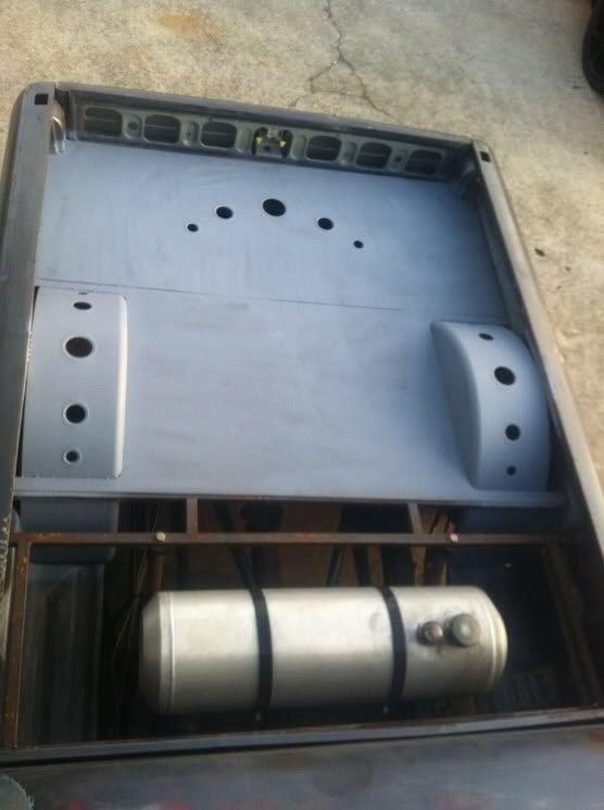

Recently decided to scrap my stock bed and go with something a little bit different. A Mazda bed. Cut out the bed floor and raised it and currently working on sheet metaling the floor and all that good stuff. I've got a good friend of mine whose doing the work, without him the bed floor wouldn't have come out as well as it has. Also upgraded to the accuair switch speed as well as dual AZ OB2's. Upgraded my alternator to a 220 amp. Cold air intake. Finally got my 5.0 just in the process of saving money to rebuild it the way that I want. Future plans for the near future hopefully.. stock floor body drop, motor swap, MMW control arms and notchless tie rods. Paint maybe? Waiting on my grant kustoms roll pan to come in too, should be in sometime this coming week. Here are a few pictures of the bed and the bed floor. I'm loving it.
The trucks has now been dubbed "Frankenstein" since it has so many different parts from other trucks.
That's all the progress pictures I have now. I pulled my transmission yesterday to change my clutch because it's completely shot. Should have the bed finished up by next weekend and it'll be Line-X'd whenever it's finished. The tops of the tubs will be painted so you will be able to see the dimple dies.
