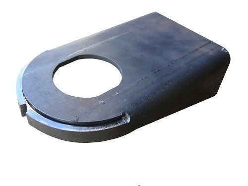

I make a new mount that uses a stock S10 body bushing and just weld it to the frame.

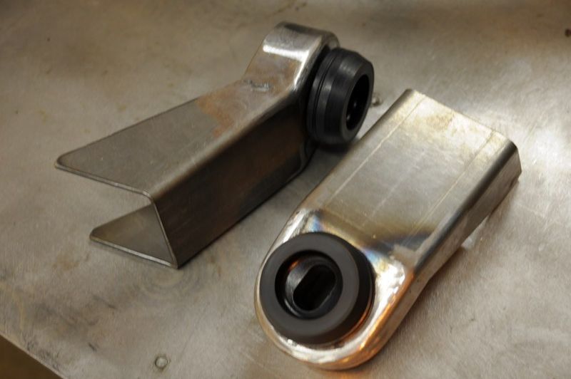

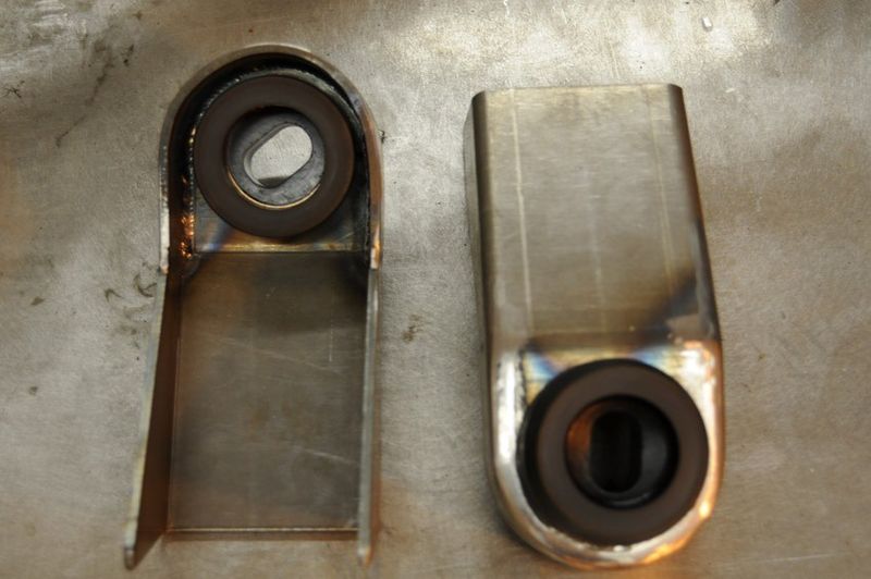

I like bbt fab low profile mounts that they use on most of their projects and use the same rubber u guys were refering to I believe

Pics of BBT bushings? I use S10s as well but would like something a little more low profile sometimes. Ive used the low pro urethane mounts but Id rather it be rubber..

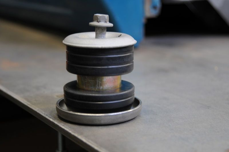

This is what I used on the blazer roadster I am working on. I just cut a mount similar to the ones pictured above, but made them fit this size bushing.
http://www.jegs.com/photos/300/355/355-9-4101diagram.jpg
http://www.jegs.com/images/photos/300/355/355-9-4102R.jpg

Energy Suspension makes some universal body mounts as well.
