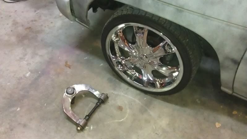

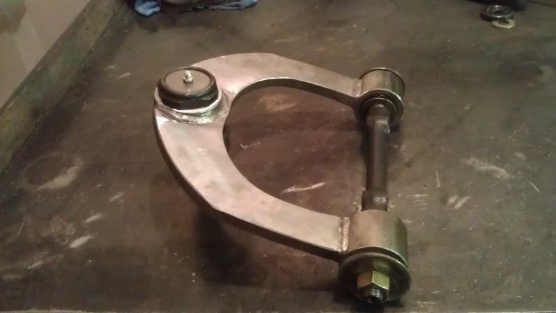

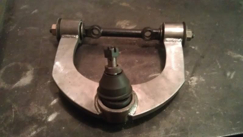

Ive been doing some thing and decided to take some time and build a set of arms from every ones suggestions!
Lemme know what you guys think!!!

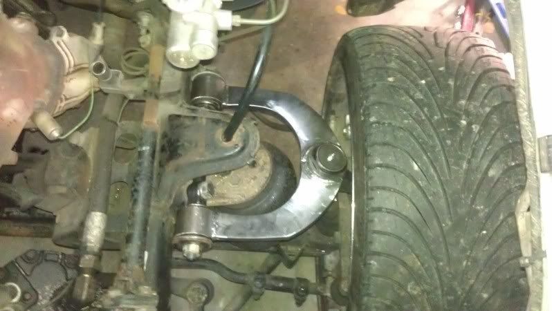

Have you had them on a truck yet? is there any diffrance with these like camber issues?

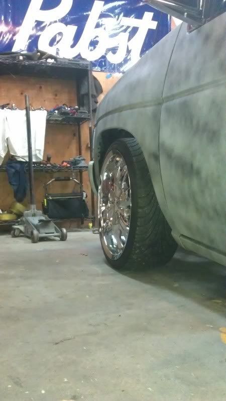

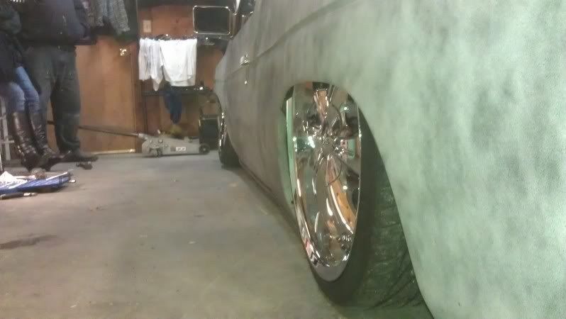

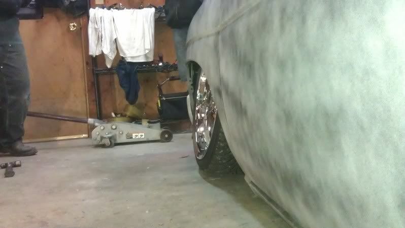

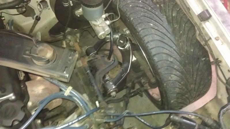

Np, I bolted up a set, and drove on them, there exactly the same as flipping your uppers upside down. nissans just have a butt load of camber. I kinda like it. To get rid of the chamber, add shims.
