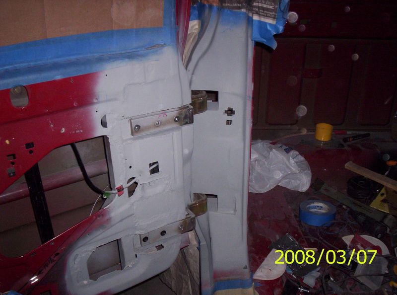

i did mine on an 02...i dont have write up, but the only important things that come to mind are, Z'in the hinges, extending the wires, and since I didnt want to "platte the door sheel , i crafted a support out of 1x1 ..i think a picture wiil be better...I also used the factory latches/strikers..i put the latch in the lower portion of the B piller and fabb'd an adapter to accept the factory latch cable and a 10 speed derailer cable so that I could use the factory interior door handle...shoot me your email, i can send pics..its been over threes years, and I only had to replace the screws that came with the kit, the jeads strip out way tto easy during adjustment....
tmiit71's avatar
tmiit71
Edited: 12/7/2011 2:22:45 PM by tmiit
also, recess the area to the inside of the jamb to allow the door close completely..
i ran the wires and door release cable through the two stirker holes you see inthe jamb.. still to this day..:-) Im thinking of sendthem throuh the hinger itself for a cleaner look..don't know yet...

Looks good!

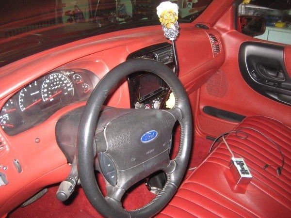

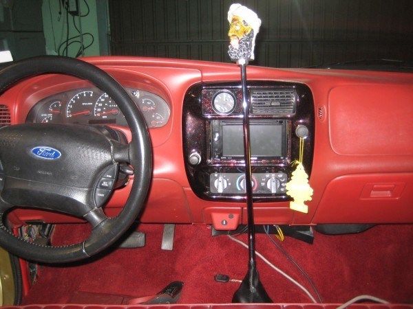

Thanks...but yeah, any Q's.. hit me up...i also finished an AMericanSHifter.com floor shifter (automatic Trans)..
Where's you get your red carpet homie? I'm going with an all red too hah, I just have my dash and radio bezel painted right now though
tmiit71's avatar
tmiit71
THe carpet is form Stock Interiors....being in Germany, it;s more cost effective to order on line... the carpet is good for the price, only neede a little more persuasive manipulation around the trans tunnel area..
