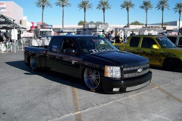

My new project was lated out by choppin block when and I guess was their guiney pig. They raised the front a little and made new uppers but the stocks are on bottom with bad camber, their new kit looks much better and uses their own spindles, I am sure it, Ekstensive's, or MMW's are great, but dont use any of the stock stuff, its a waste. Look for mine in tech build-ups in Truckin'... not going to let any secrets out but I hear that Tre5 might have his hands in my build....... dun dun dunnnnnnnnnn.
