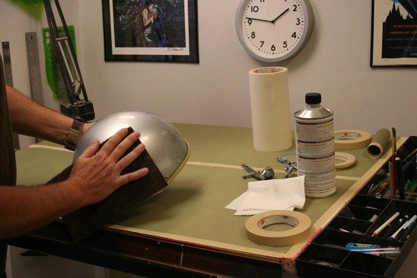

This is a little simplified, but here's a step-by-step of doing a small pinup like the one on the helmet above. I've omitted some things for the sake of space but you get the idea.
Step 1) Prep the helmet by scuffing it with a scotchbrite pad after you wipe it with some de-greaser. You may need to remove some decals and remove the gum.

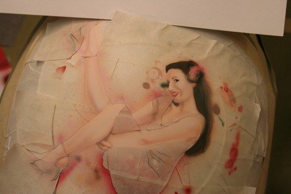

Step 4) A re-cover the area I painted white with more transfer tape and trace my pinup over the area again. Now I can use an xacto to cut out the dress shapes. I remove shapes and keep them handy so I can replace them once I have my color down.

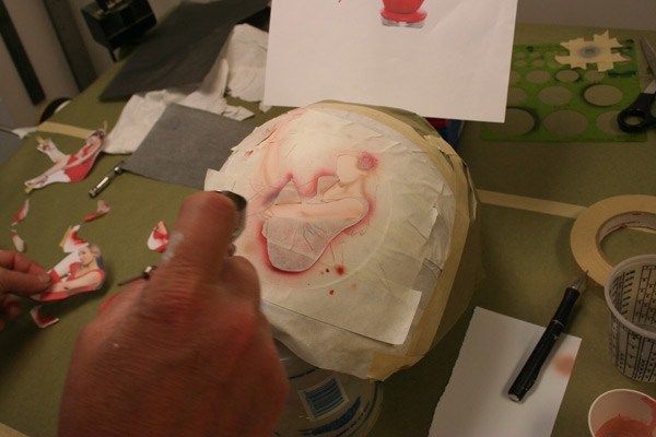

Step 5) I cut up duplicate copies of my reference photo and use it as a hand-held shield while I spray in details. For a hard edge, hold the shield right up to the surface and for softer edges, hold it further away or wiggle it slightly while you spray.
Step 6) Once I get all the dress areas painted in, I cover those back up with the tape I had cut out and removed earlier. Now I can start spraying the skin tones in.

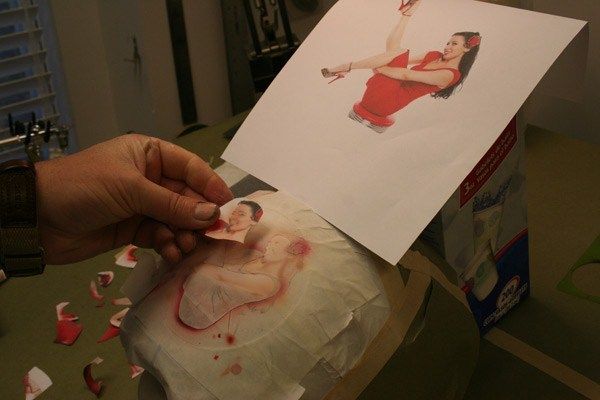

Step 7) Once again, I cut up extra copies of my reference photo to make shields with. Around the face I like to cut out the nostrils, eyeliner, and lips which help establish landmarks on the face so I can fill in the rest. Don't overdo it. Go slow and build up the face carefully.
Step 8 ) Once the facial features are put in, move on to the hair area. Keep your spray somewhat soft around the face.

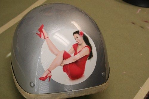

Step 9) You can use your xacto to lightly scratch in some stands of hair where it's highlighted. Don't try to paint every single strand. All that's left is to remove the masking and spray your clear over the art.
Hope these steps can help anyone out there interested in doing small subjects. By using these simple masking tips you can control your spray better and thus end up with a better product. Have fun and practice often.
