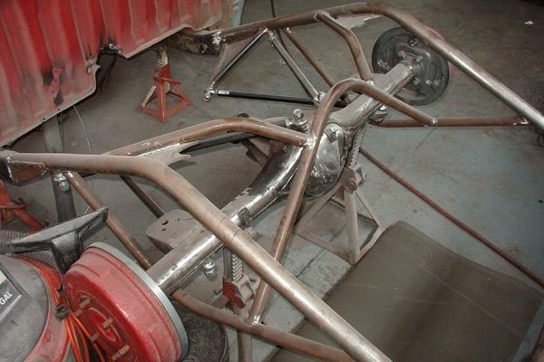

My old Nissan had one. I wasn't too crazy about it because it seemed to me to limit your maximum lift height. But I'm no suspension expert and the guys using it thought it was the greatest. Progress pic:

Like mentioned, i'd have to say the lift would be the biggest con. Max lift you'll get is the bottom of the axle to the ground minus the frame height. The smaller the diameter wheel and tire, the less lift you be able to get. If you go over the axle but keep the rails tight to the axle tubes it shouldn't be any higher than the differential, if it is higher it won't be much. You'll have to have clearance for that anyways.
