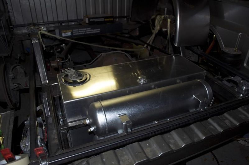

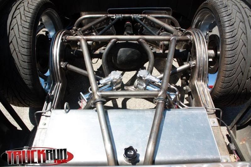

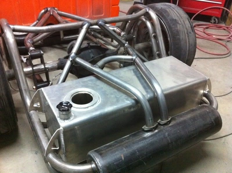

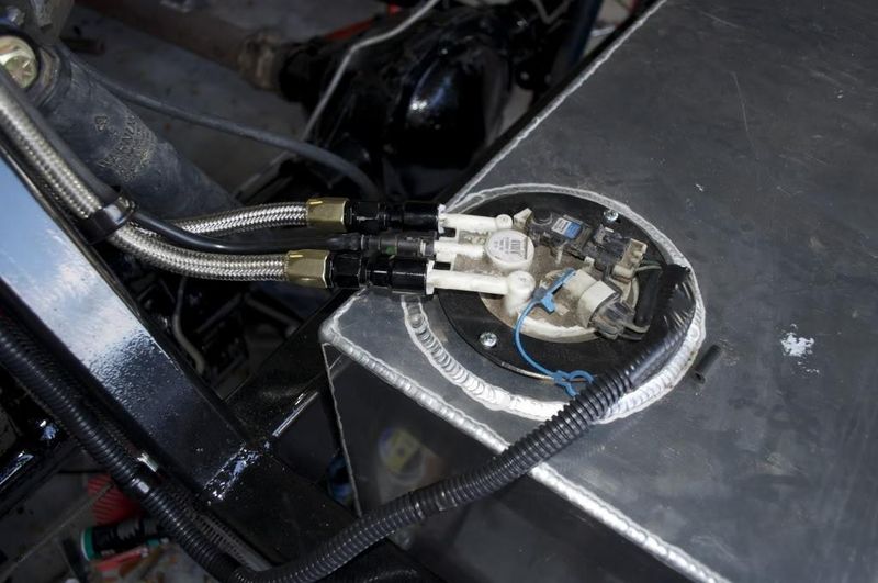

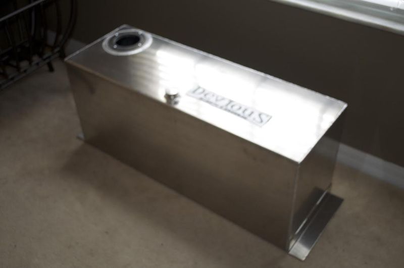

When i did my buddy Scotts 03 Sierra he ordered a custom cell from Devious. I do not recall dimensions but we gave him the length and width and told him to make the depth the same as the raised tank they make for the factory unit. Here is some pics:

Thanks man. That's a nice cell. Do you recall the volume??? I'm looking for something just like that!!! I appreciate the help too.

if your using your stock pump and sending unit, you want your cell as deep as your stock tank. my stock tank was i think 12in deep where my pump was, so i got a 12in deep cell so my pump would go to the bottom of my cell.
