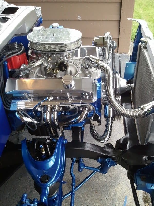

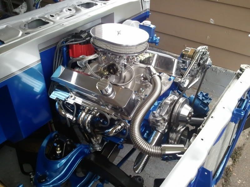

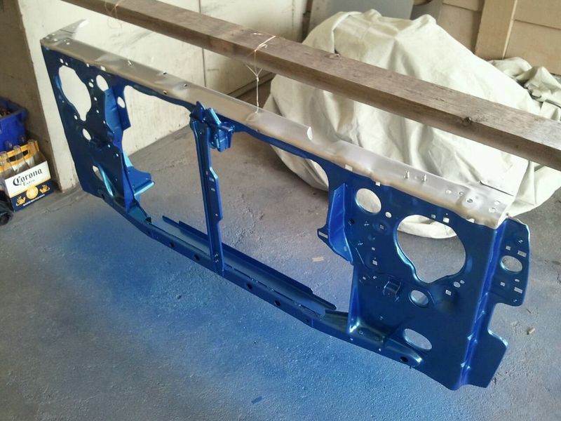

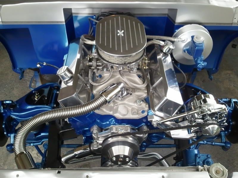

Heres my mazda in the process of getting a sbc, hope its alittle helpfull
Notched out a section for the filler neck and used some round tube that i cut in half, modified the bottom and just made a tray to hold the rad, theres a thick piece of rubber that lays down on that lip so the rad isn't just sitting on the metal
side view, sorry man not really the greatest of pics

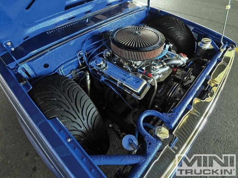

I haven't posted much since getting rid of my truck. Here's a picture of my custom tubed radiator support I made.

^^^sweet,love the bedliner & the hoop around the radiator cap!
bick that's a very clean engine!what kind of valve covers are those?
