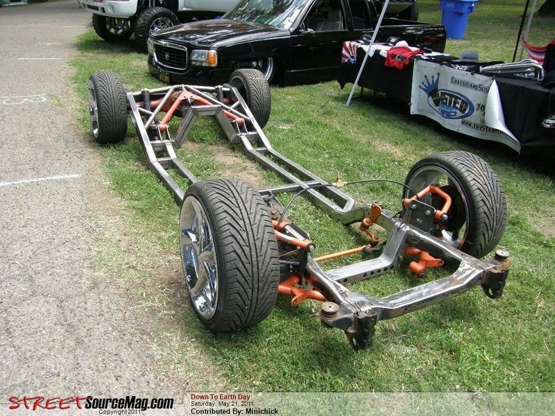

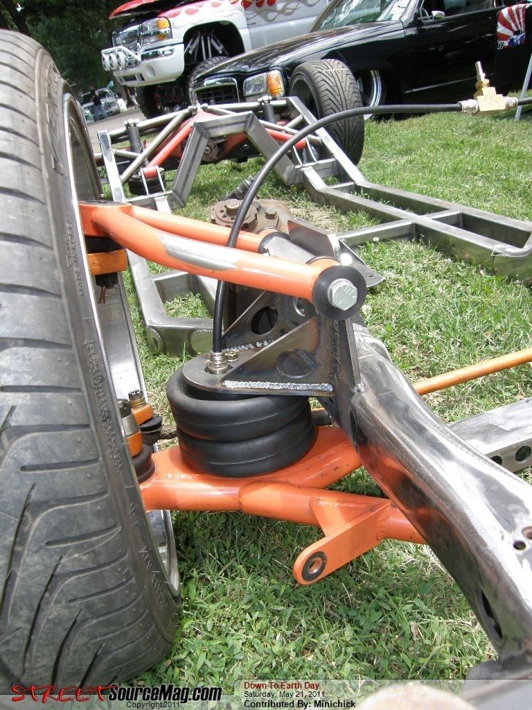

2.5'' frame z cut the coil pockets out and put torsion bracekts,reangle the upperball joints if running a 25'' or taller tire, relocated or trianglulate lower arms to get rid of the strut rods is what we did to mine
low87mmax
sounds good man any pics?
