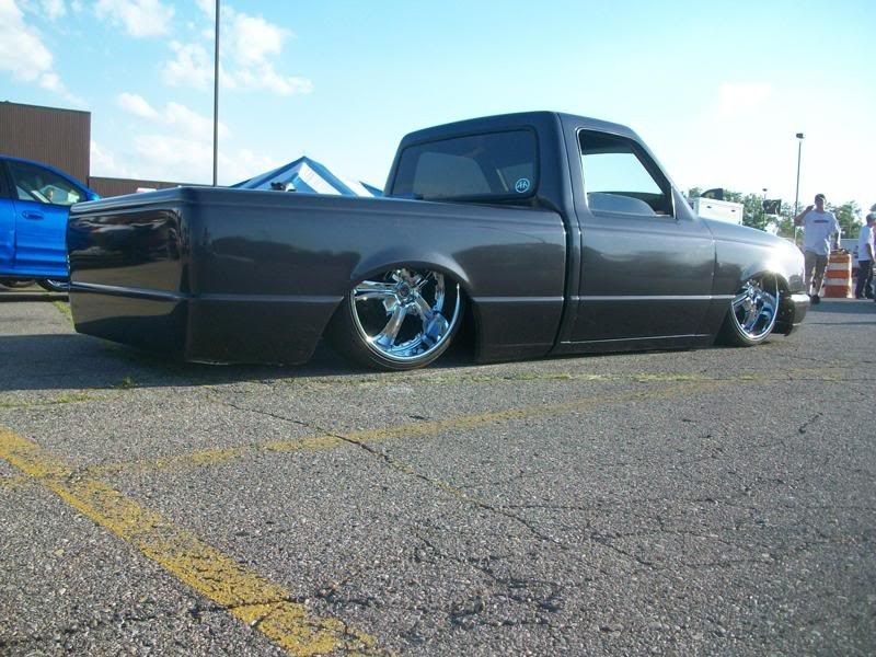

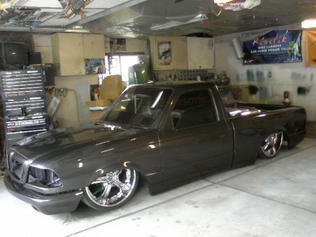

Im getting close to being done with the truck and wanted to share my Adventure. lol. Garage built going on about 6 years now. The truck sat untouched a couple times for a year or so. But any way heres my truck. Thanks for checking it out.

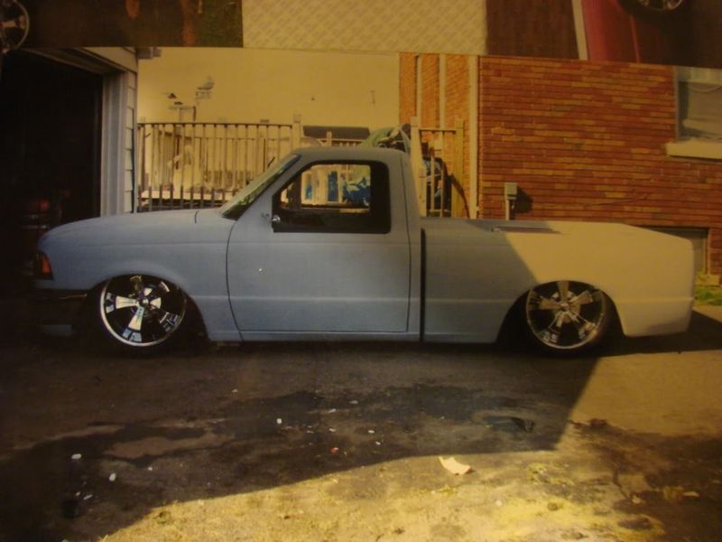

Where it all began.

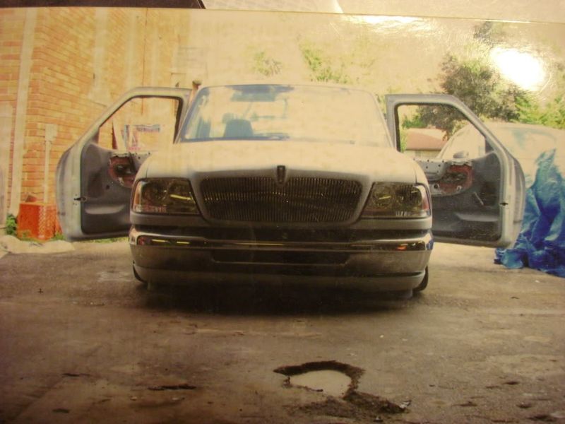

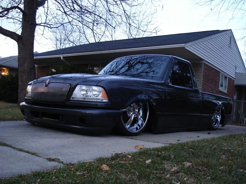

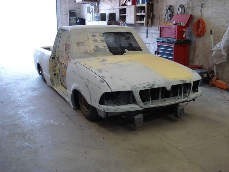

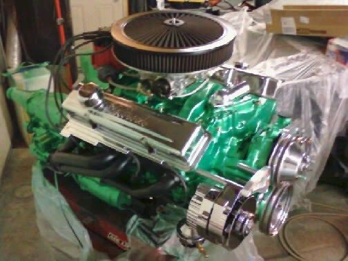

2005 Lincoln Avaitor front swap, narrowed 3 inchesnon each side. Shaved everything. :)
KLOCKWORKmike's avatar
KLOCKWORKmike

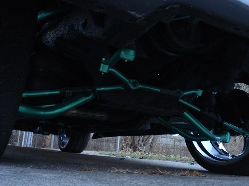

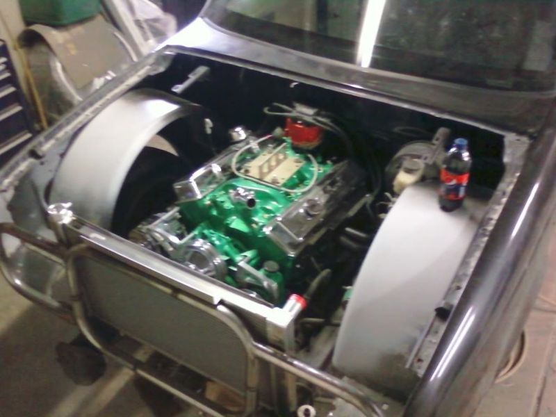

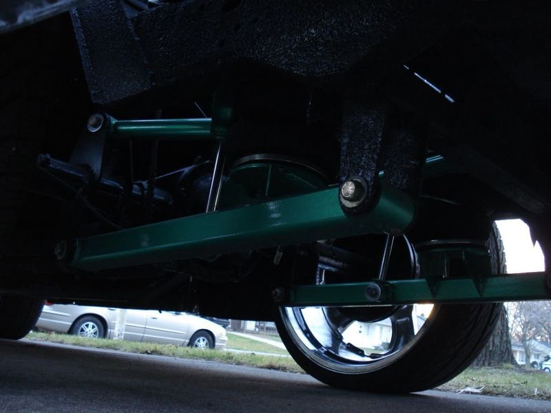

black sealertube core support and engine in.s10 front clip w/ Suicidedoors control arms and BelleTech spindlesTriangulated 4link cantilever

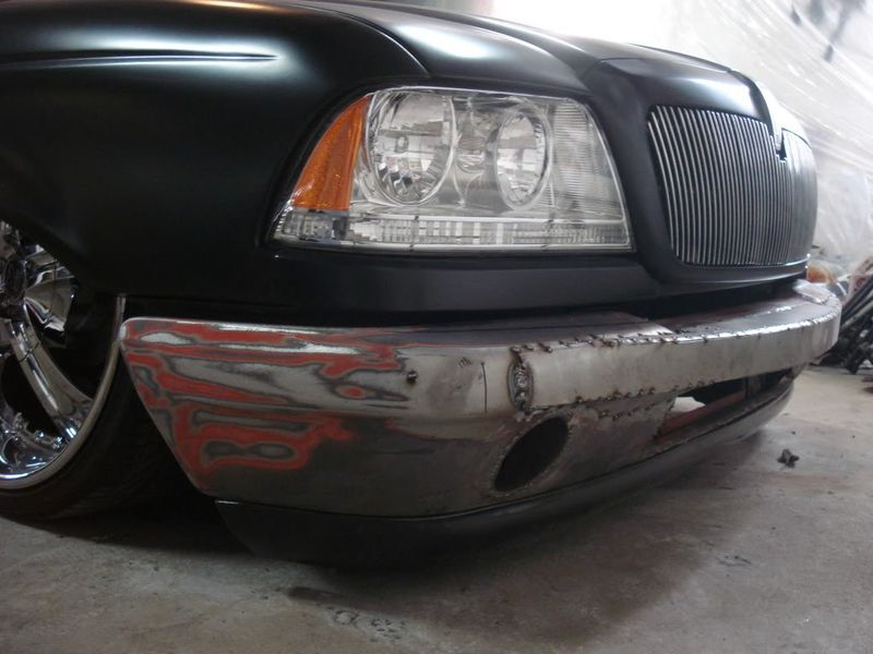

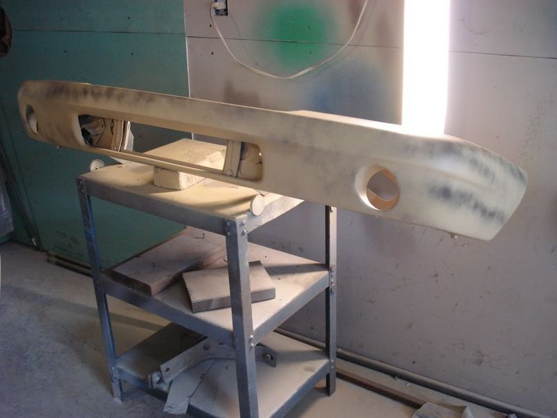

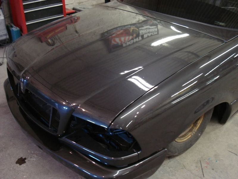

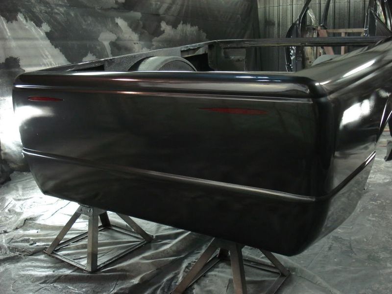

custom bumper w/ fogs and grill opened upready for paintdamn truck too :)home from paint
KLOCKWORKmike

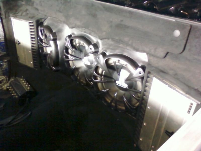

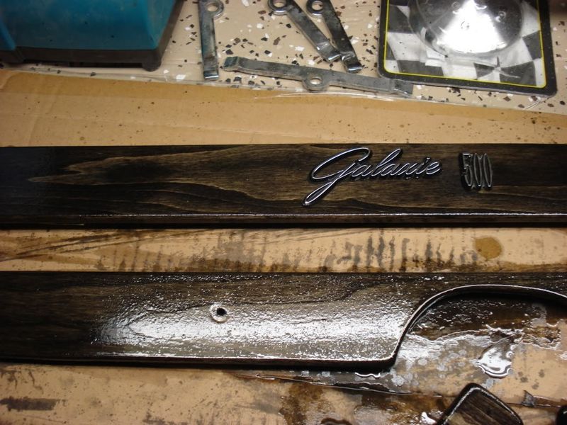

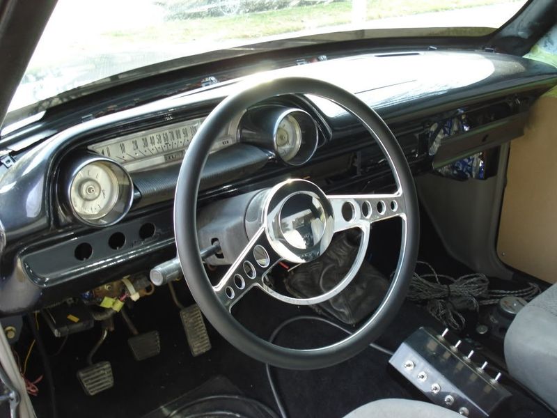

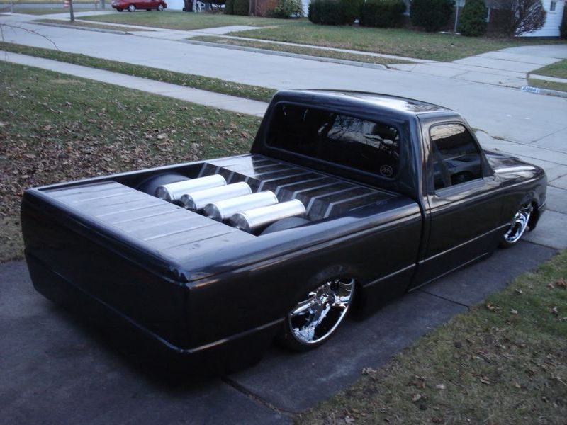

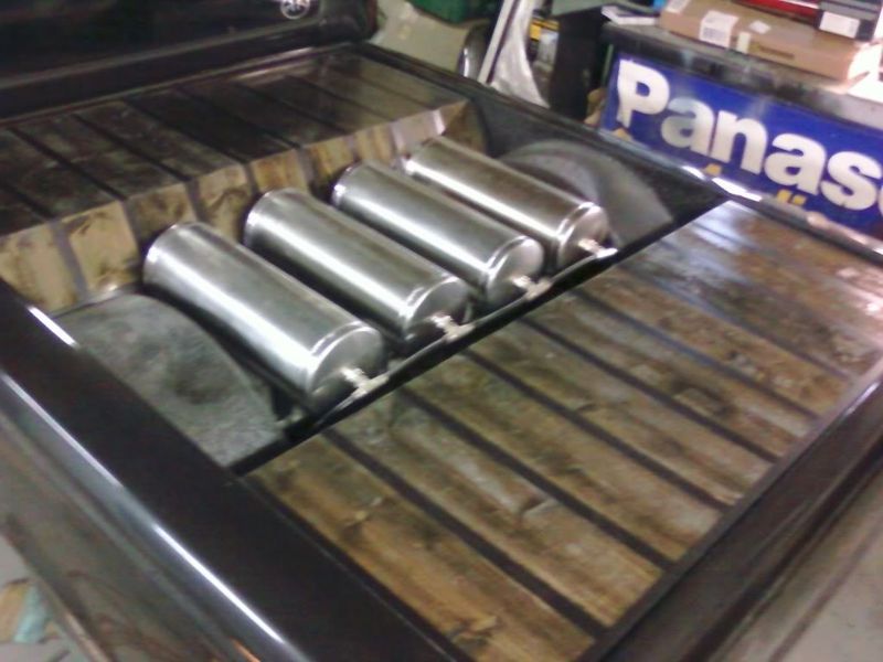

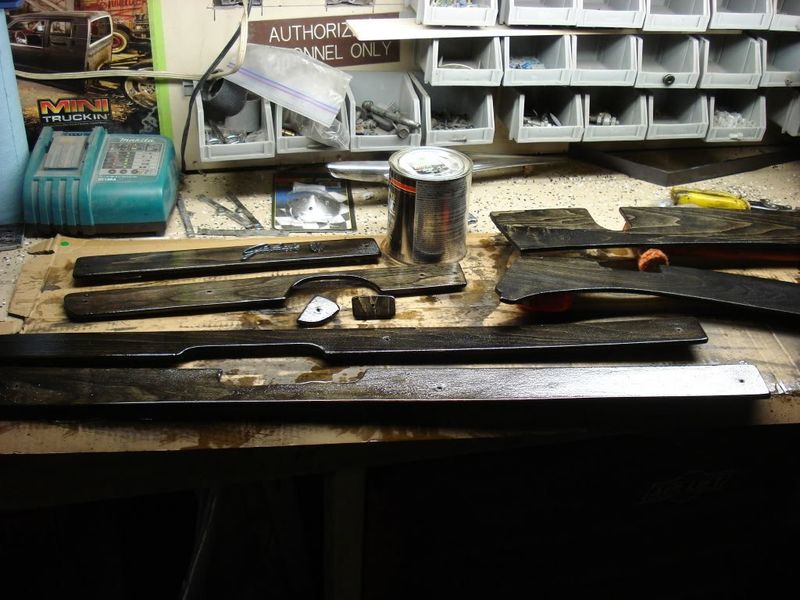

bed wooded.interior started w/ narrowed Galaxie dash3 ten inch JLs in a cut thru, w/ Amps glassed and flushed where stock 5x7s were
