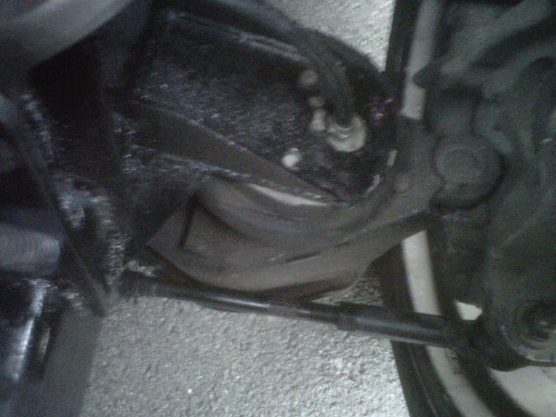

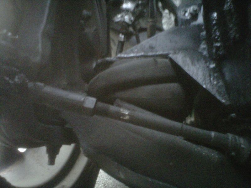

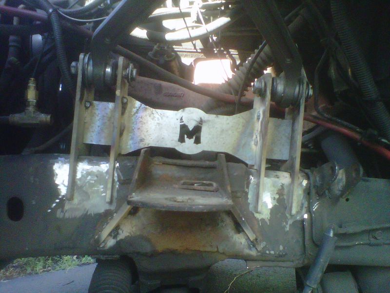

not the best of pictures but the upper bag bracket needs to be redone. a shop called area 51 in fredericksburg va did the bag set up before i bought it had problems ever since . had to redo the rear last winter and the front drivers side bag bracket ripped away from the frame coming back from north carolina a month after i bought it.

Looks like the bag is mounted too far away from the frame I think moving it in closer to the pivot poit would give u more lift using less air pressure.

yea, you got a lot of issues there to work with...
the upper bag mount is way too far from the frame, and its totally not in line with your lower bag mount that is why your bag is so twisted, and it takes so much psi to lift,
It probably rides badly because how the tie rod is setup currently. being that you have stock lower ball joints right now, in the stock configuration, the tie rod should be in the stock location as well on the top of the spindle. When you flipped that tie rod to the bottom side, you took it out of line with the lower control arms, and created some serious bumpsteer, these trucks are bad for that as well, and that only makes it much much worse.
