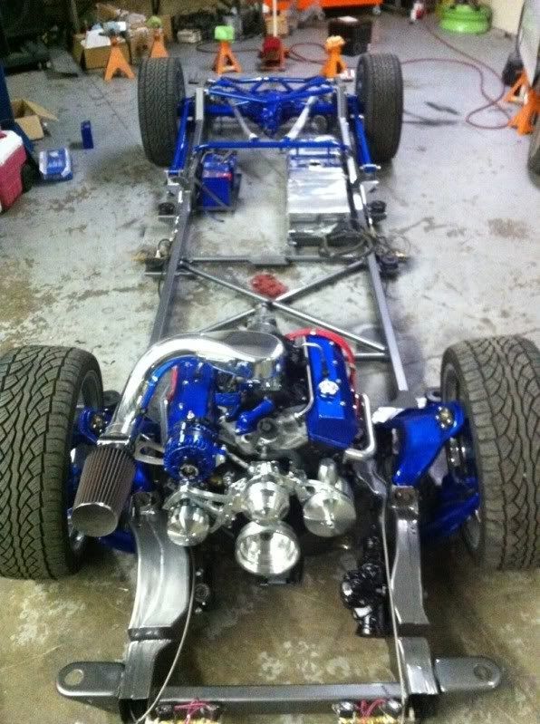

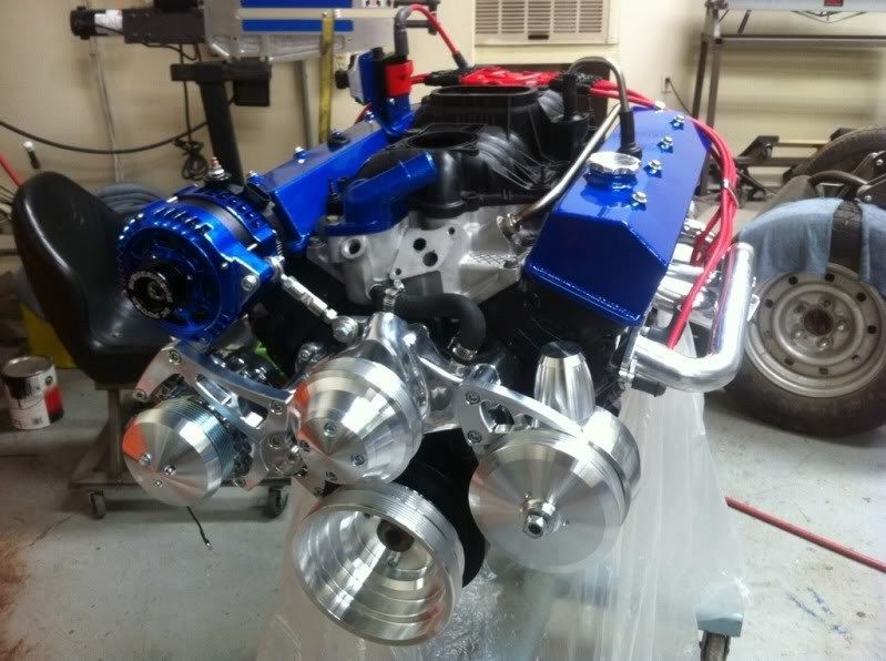

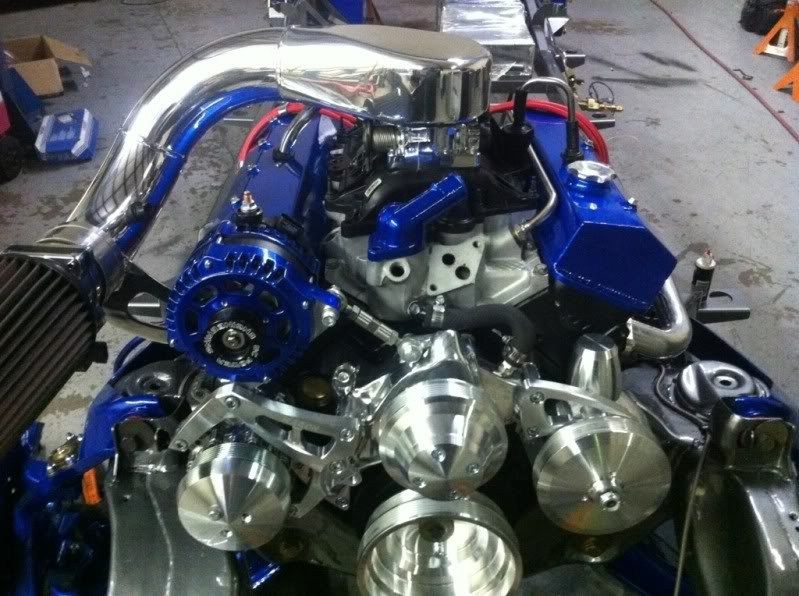

Well, took me a while to finish mine up, but here's by attempt at cleaning up my vortec 350 as much as possible. Custom valve covers, rerouted stainless EGR line, custom intake, march performance front accessories, custom aluminum spacers to move some sensors that interfered with the valve covers, all MSD ignition parts, custom aluminum throttle cable bracket, aluminum radiator hoses, fuse relay center moved under master cylinder and computer mounted vertically infront of master cylinder, eliminated wiper motor and cruise control, completely custom plumbed ac system for relocated ac compressor under alternator. lots of little things i've left out but you get the idea.
