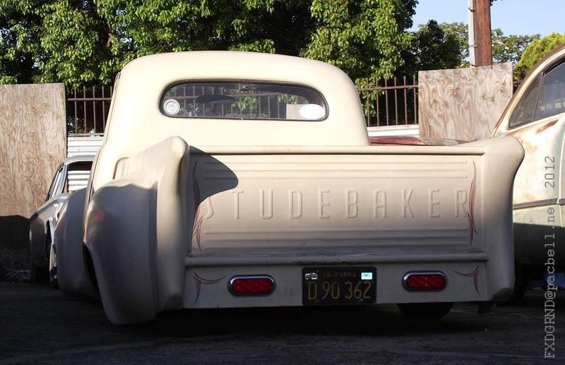

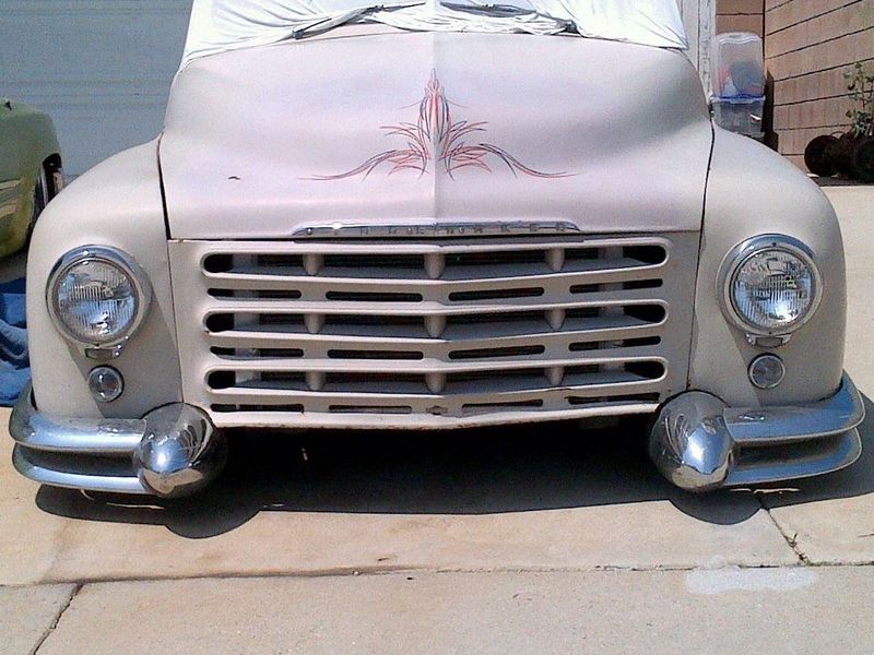

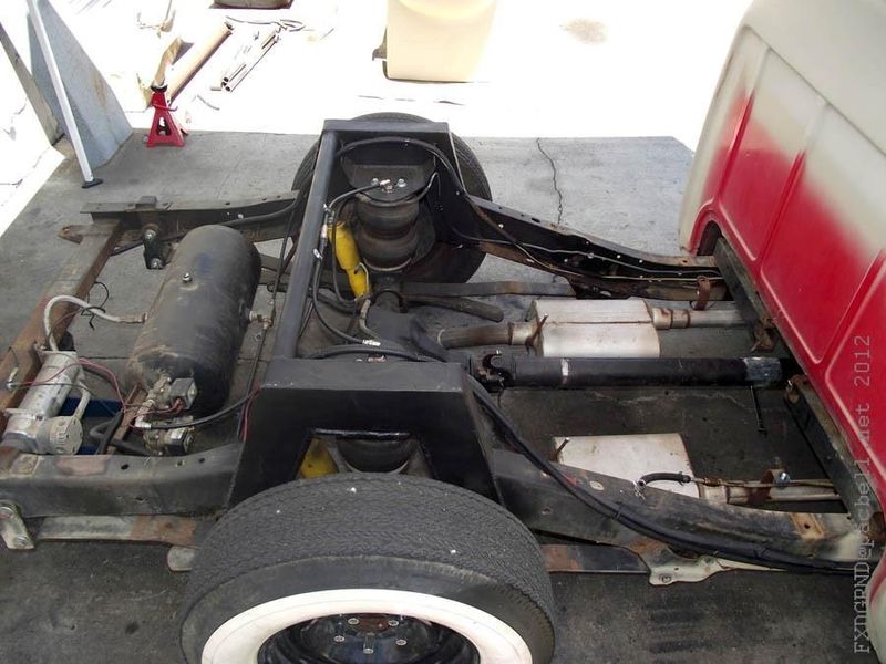

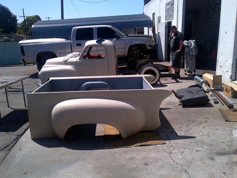

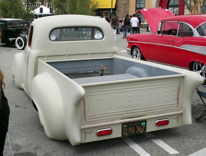

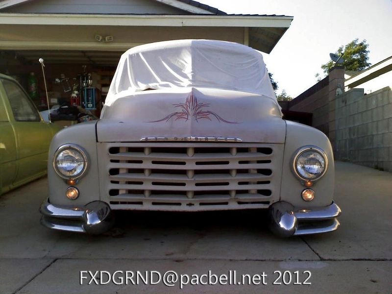

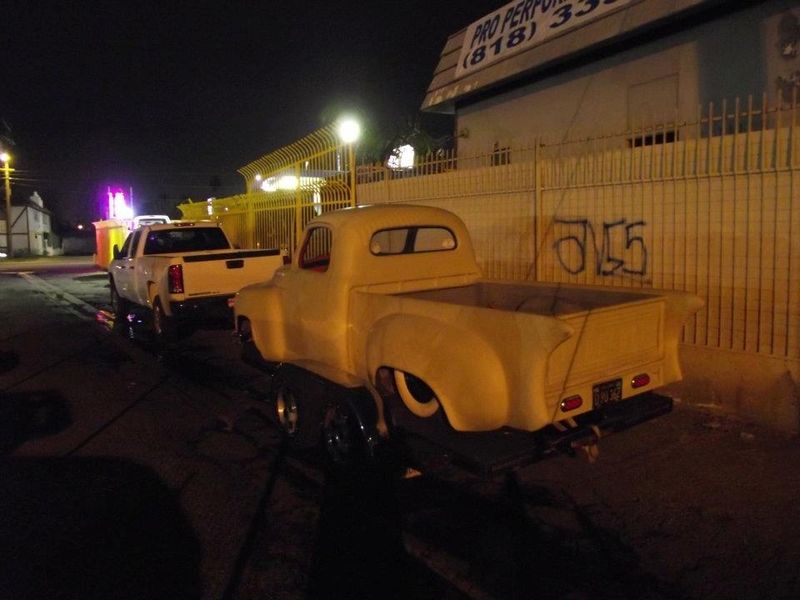

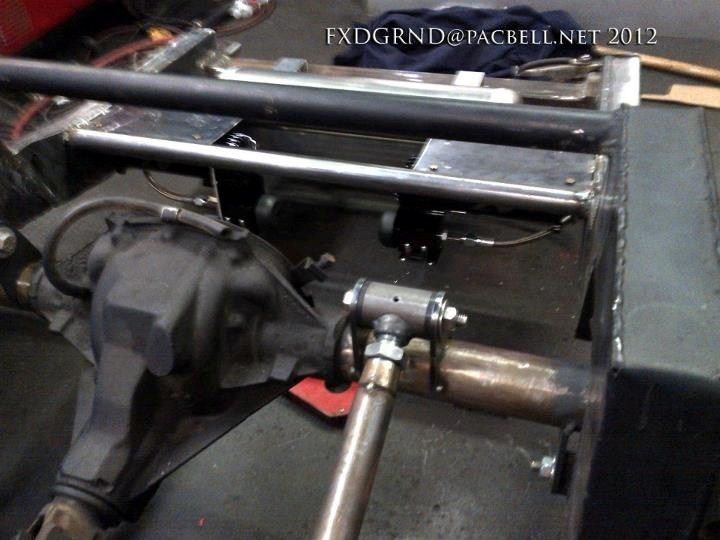

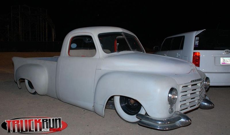

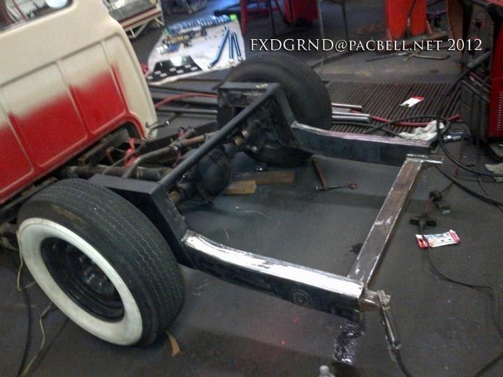

Picked up this Truck from another club member that has a few too many projects ~100 or so.
1952 Studebaker pickup1986 S-10 Frame1974 Camaro Rear end4 wheel bags.Plans:Convert to 3/8" airlines4 wheel disc brakes4 link rear Replace firewallHydroboost and power steering

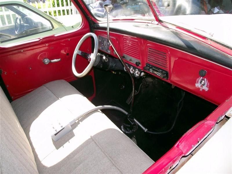

Right now is clean up and fix mode. As delivered

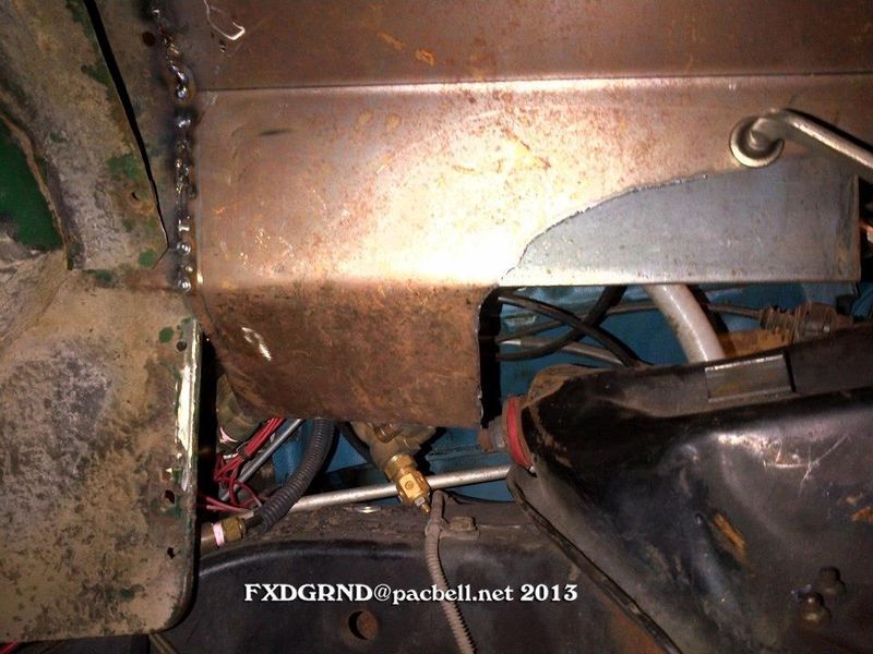

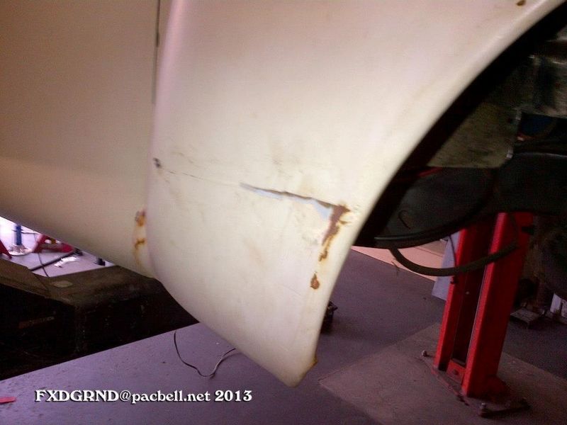

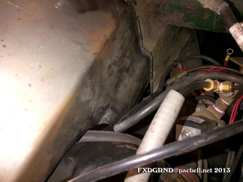

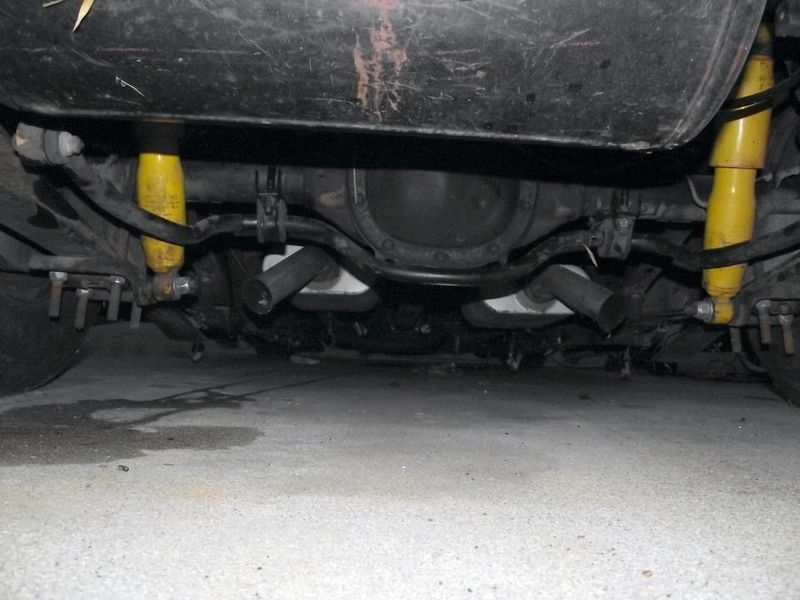

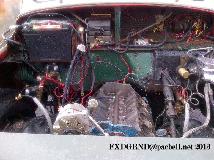

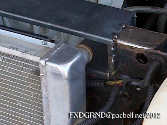

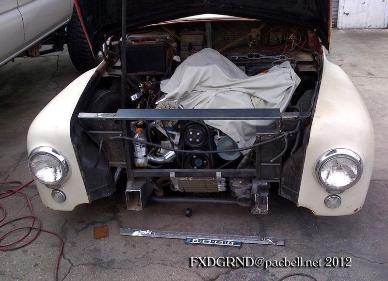

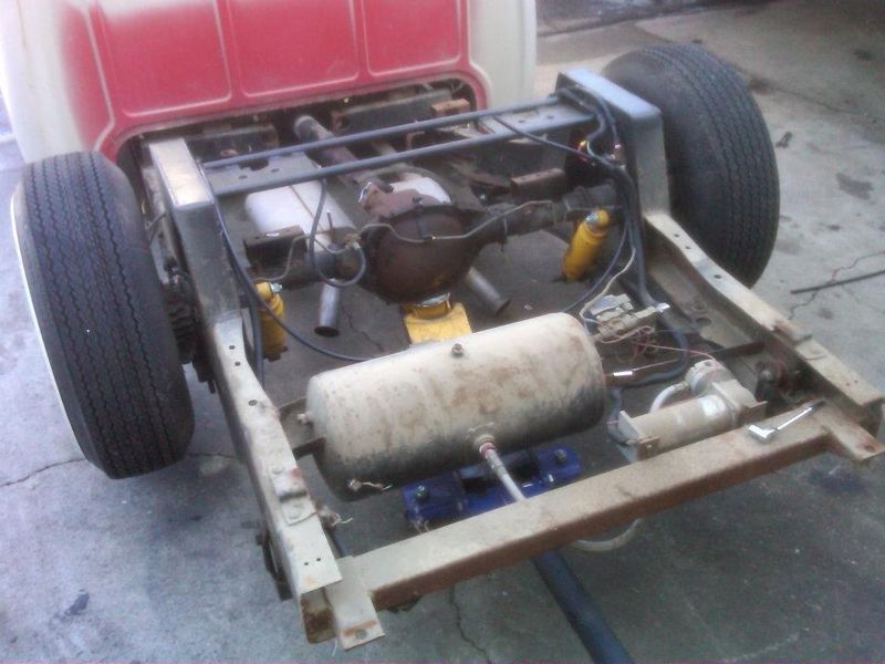

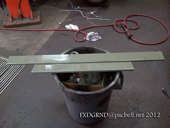

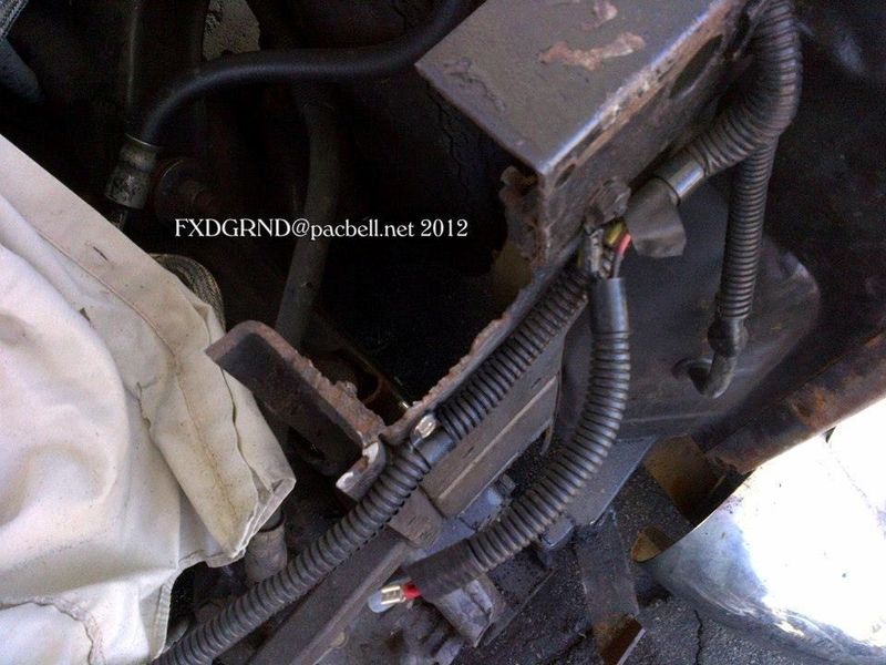

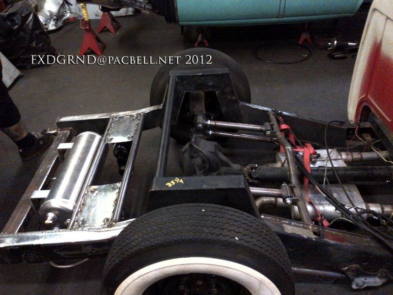

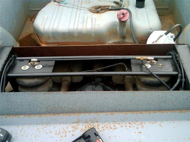

Taillights changed out to LED and relocated to the rollpanWiring fixed to the front lights and trim polished

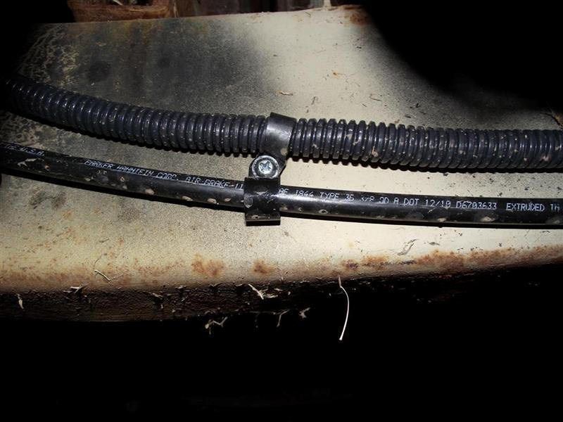

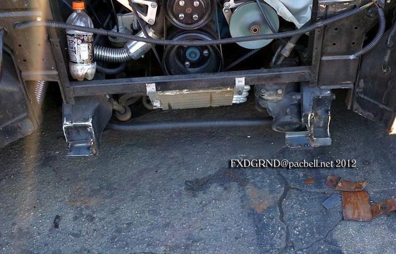

Rear wiring and lines secured and 3/8'' replacing the 1/2'' lines

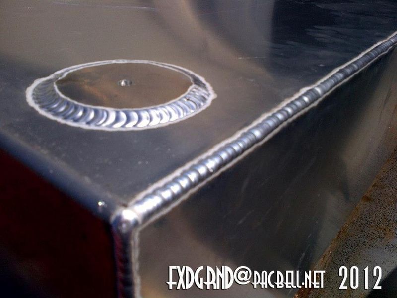

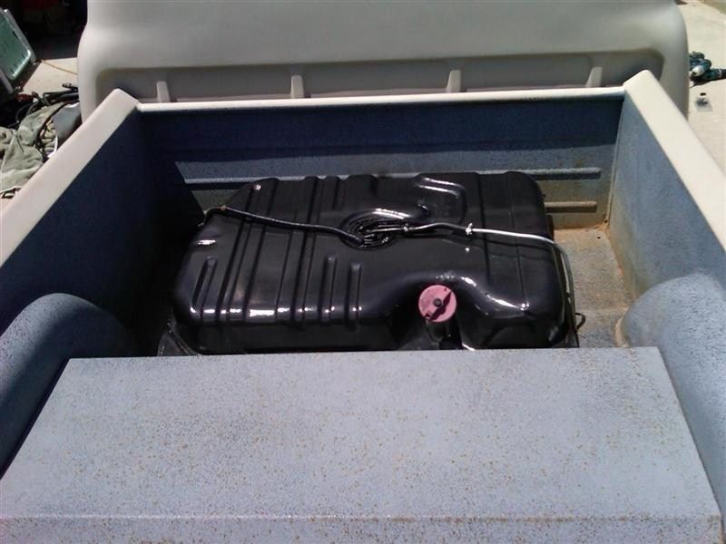

Fuel line rerouted and tank painted

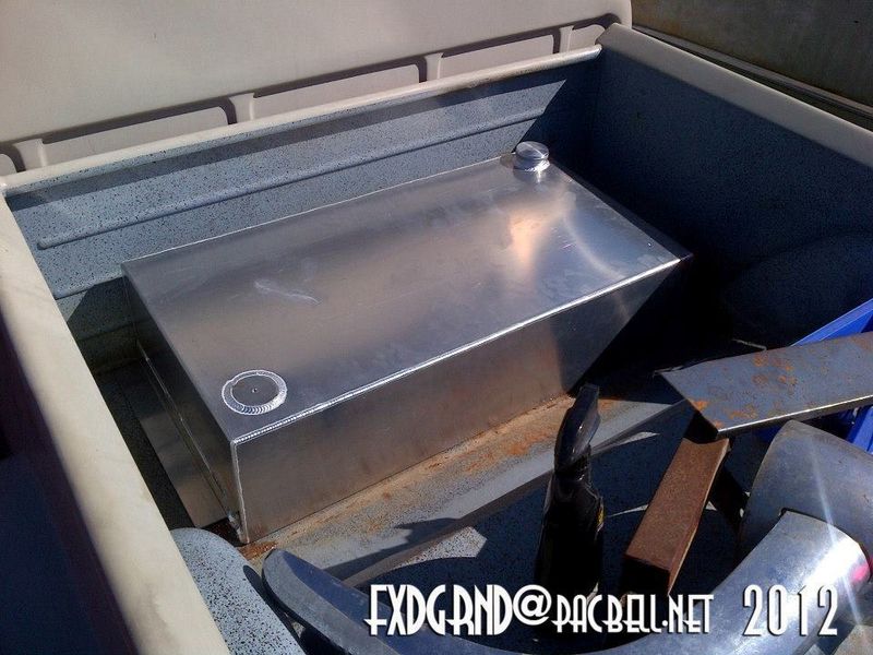

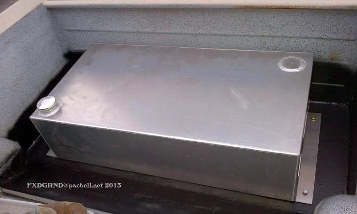

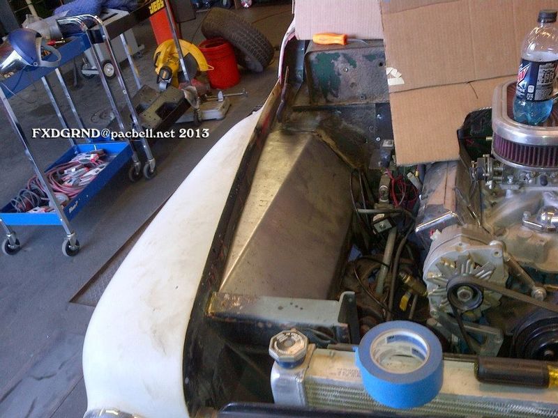

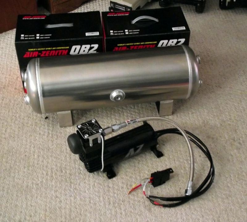

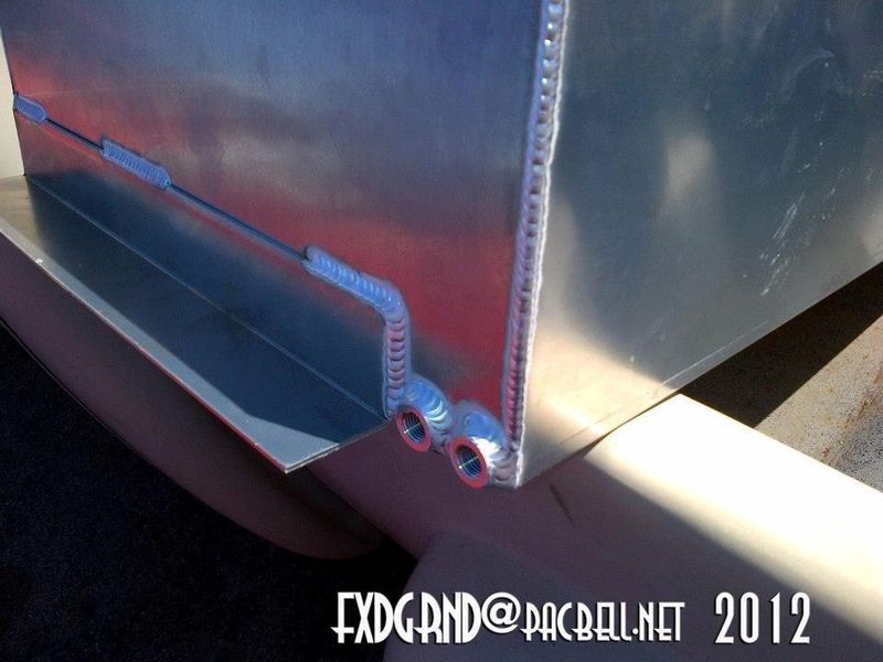

Gas tank will move under the bed and the compressors and airtank will move to where the gas tank is.

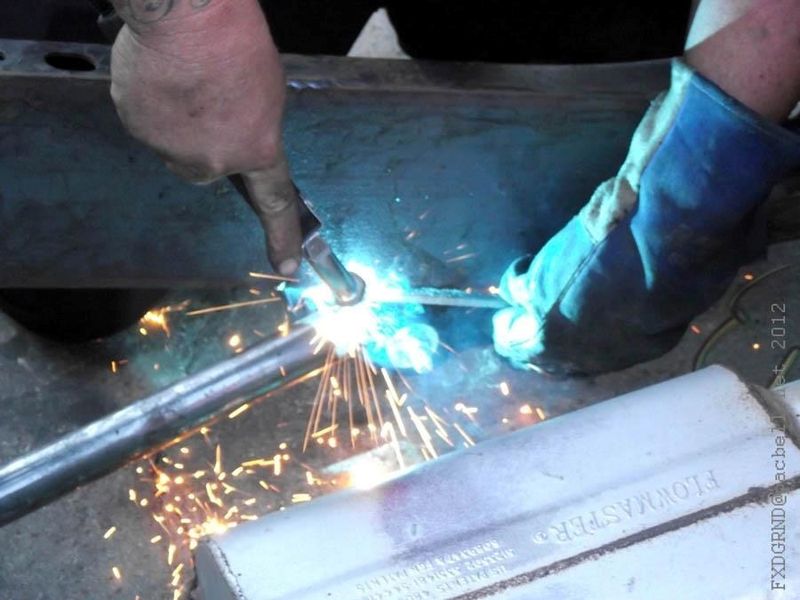

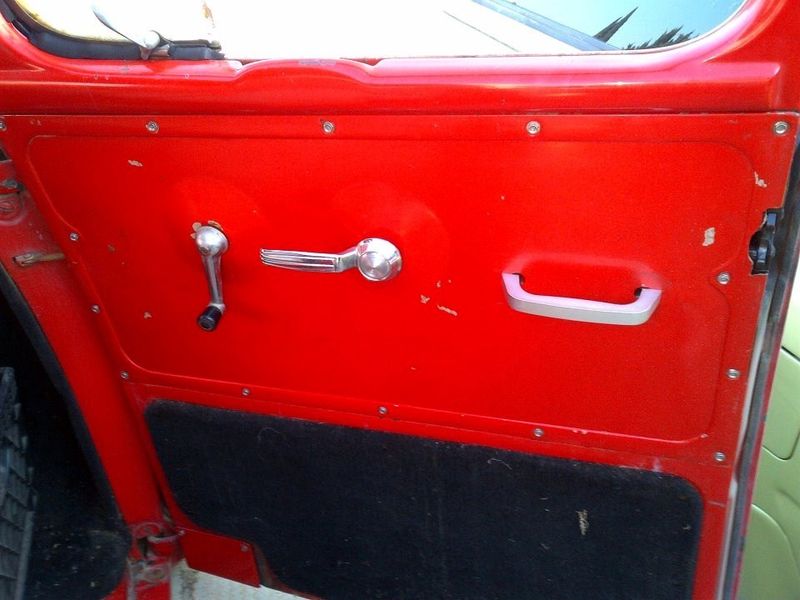

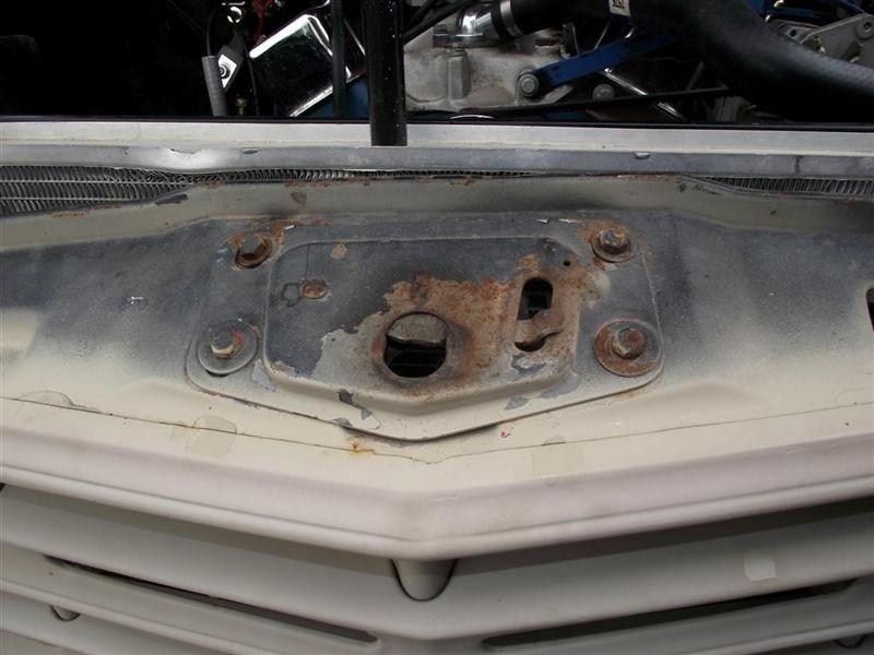

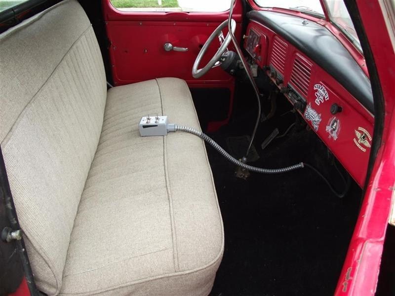

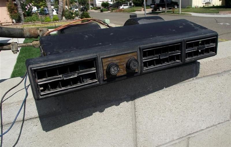

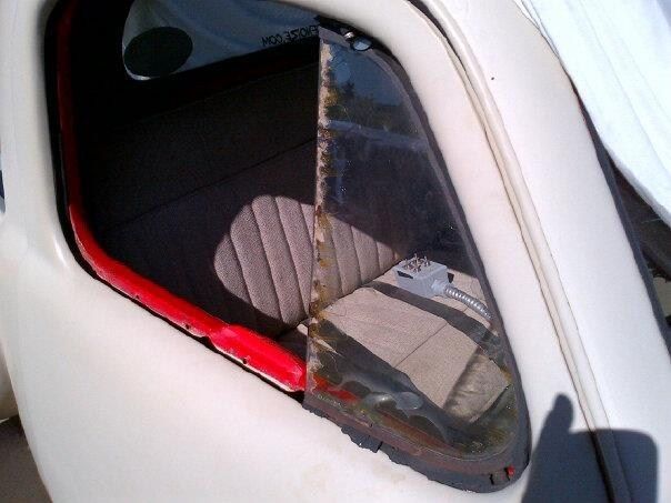

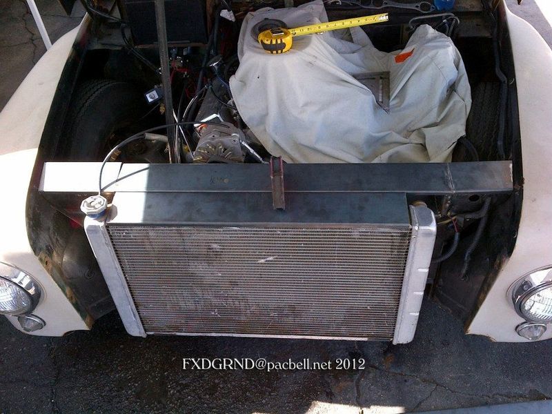

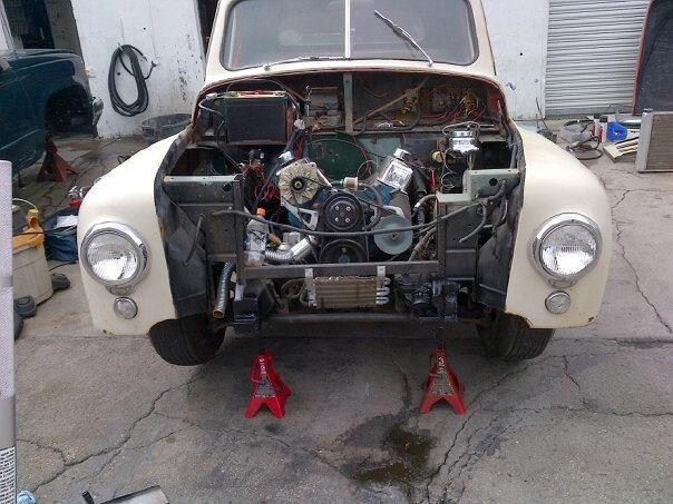

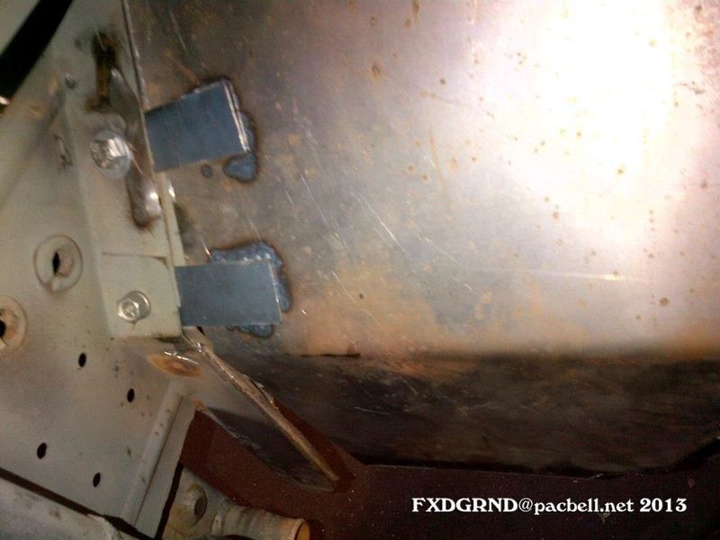

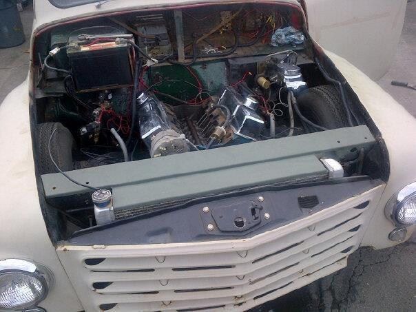

80's gm van door handles and mechanism for the Bearclaw latches. New switchbox. It had an underdash Sears AC unit but it was missing to many pieces to so had to go.

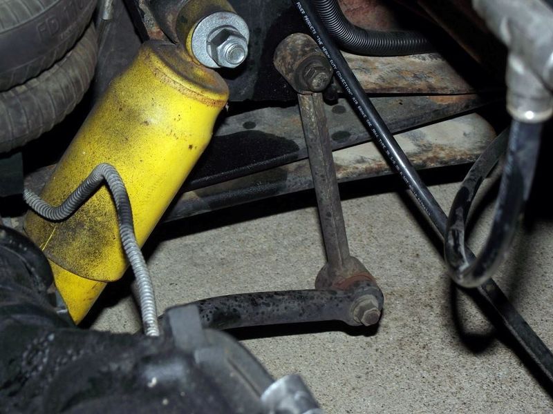

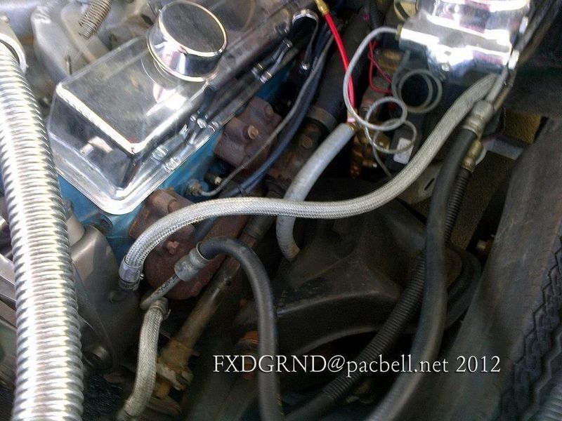

All lines underneath the truck are secured. Power lines in a wrap

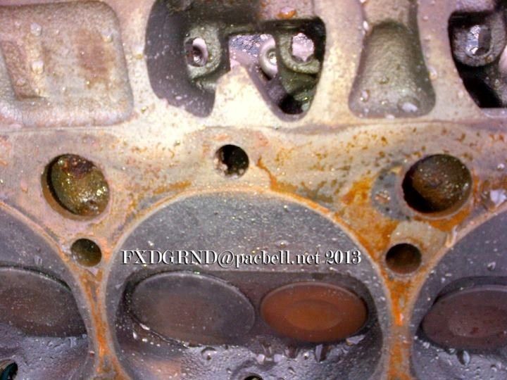

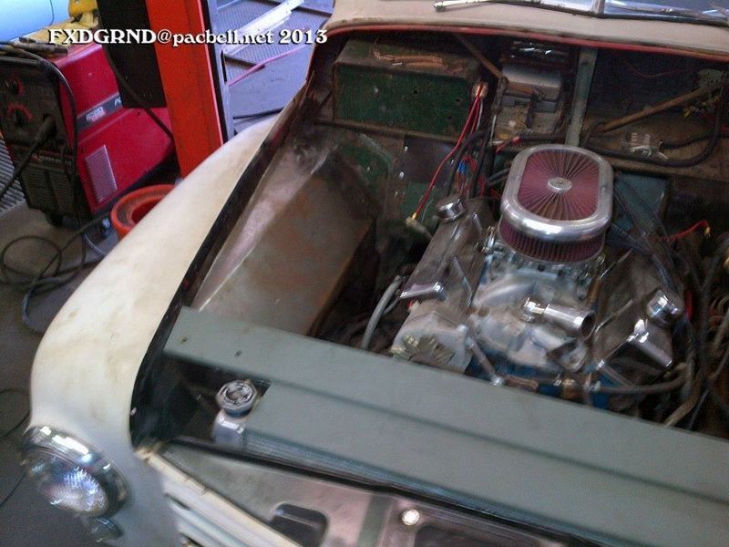

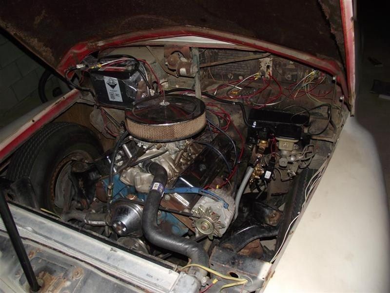

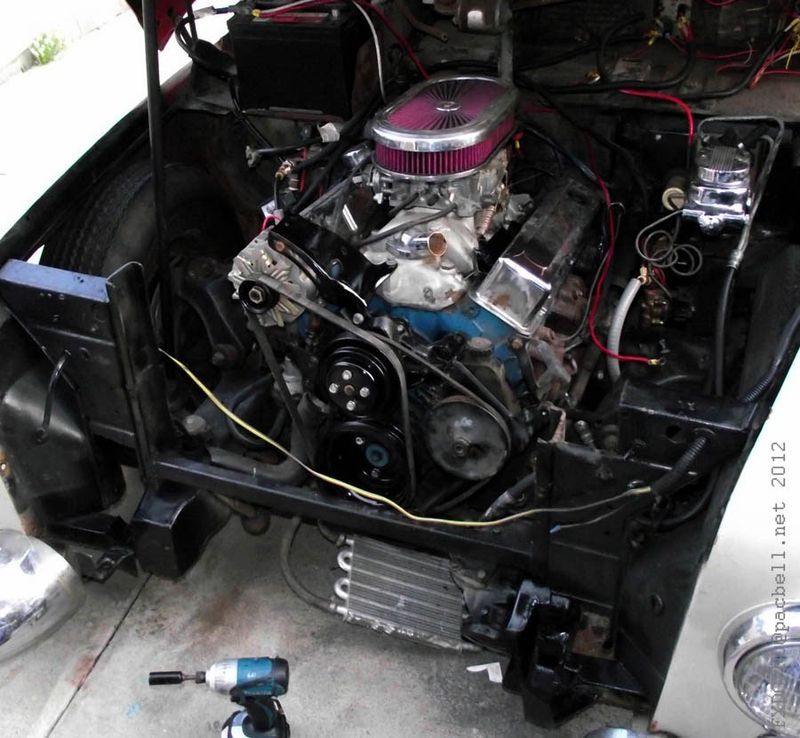

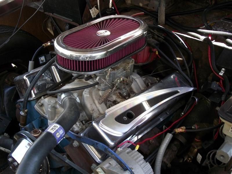

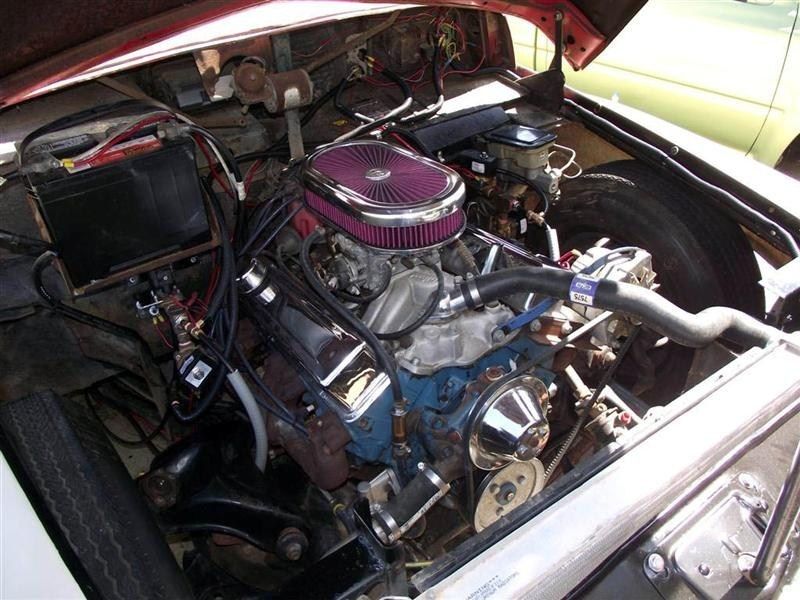

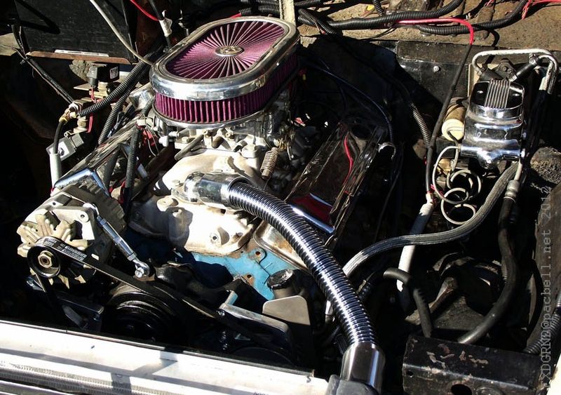

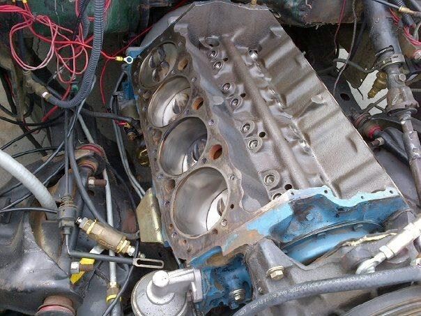

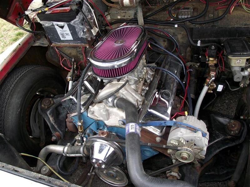

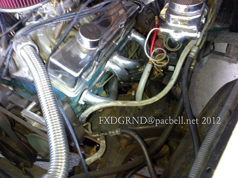

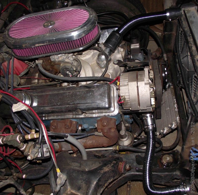

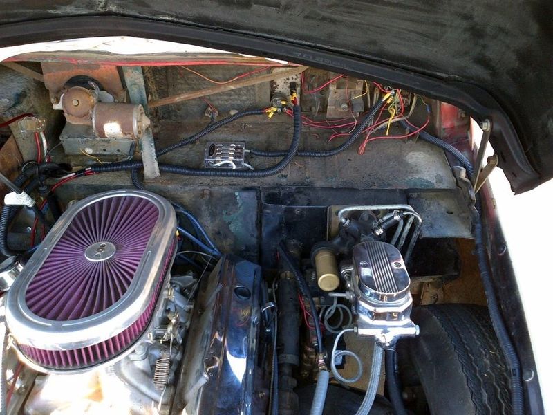

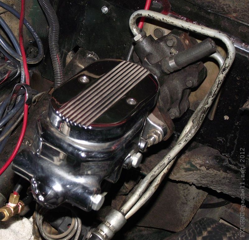

Engine
Valves mounted Wiring redone and loomed. Scosche 4 fuse block. Ebay special aircleaner.

i dig it! those Stude trucks are so cool. i'm not feelin' the fins though.
fknlowjeep's avatar
fknlowjeep
that is just a good looking truck - i'm not big on the fins but suit that truck just fine.
The Unit's avatar
The Unit
The fins are the best part that truck is sick. Jim don't listen to the peanut gallery those fins are awesome.
