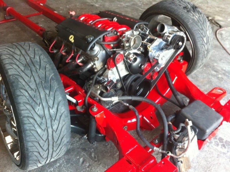

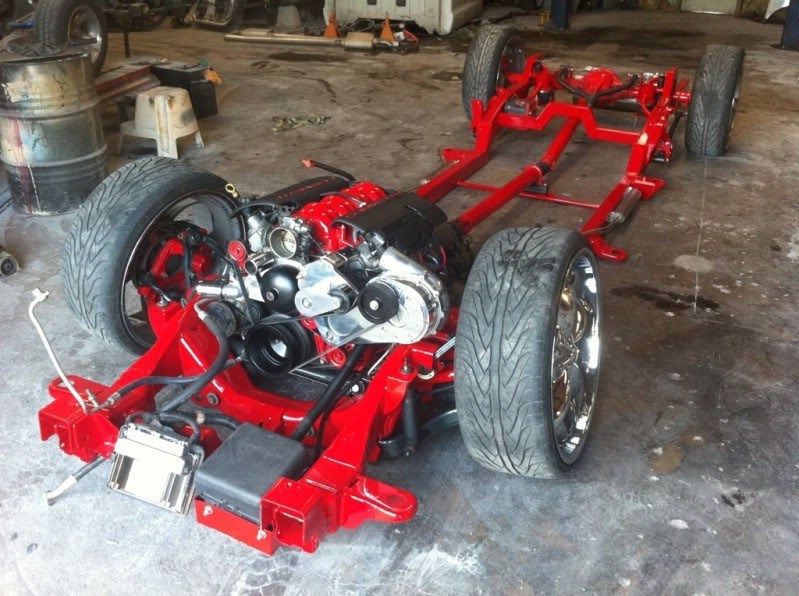

phat phabrikationz's avatar
phat phabrikationz
My fuse box is relocated behind the bumper along with the computer. The computer was able to re-route and stretch without being extended.
By using the LS1 intake, the motor harness was also able to stretch the the fuseboxes new location. The cab harness and frame harness were the only two that needed extended.
