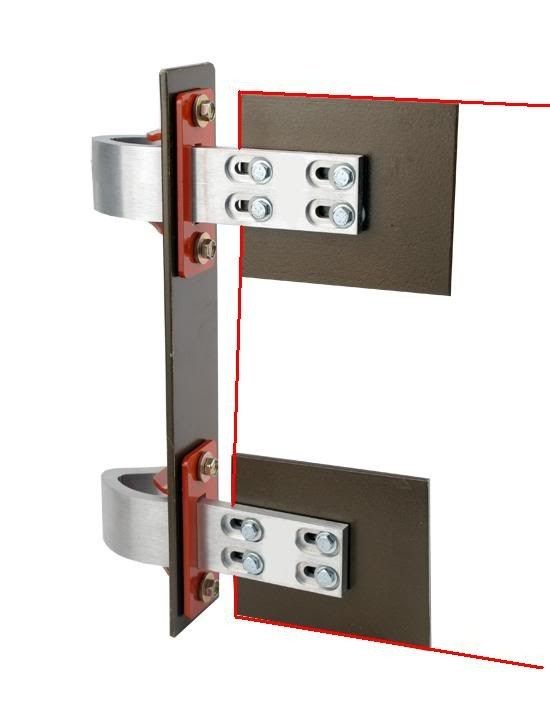

well, for the life of me i cant find clear pics of my old set-up. checked all 3 of my photobuckets and the 3 flash drives i have. these are the same exact hinges i used tho. will keep looking for pics for ya.

i have to apologize man, i have been looking everywhere i can think of and cannot find clear pics of the hinges anywhere. i have posted them up on many forums but cant seem to hunt them down. the pic below is the closest i could find. think of the pic as the gate closed. the side mounts would be where the tail lights bolt in and the flat pewter colored squares would represent the tailgate itself (inset by the red lines i added). i did have to shave my tail lights to allow the hinges to "self-intrude" into the body while closed. hope it sorta helps you in your efforts, if it doesnt, i apologize.
