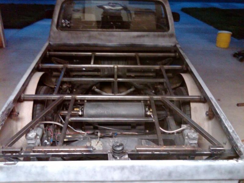

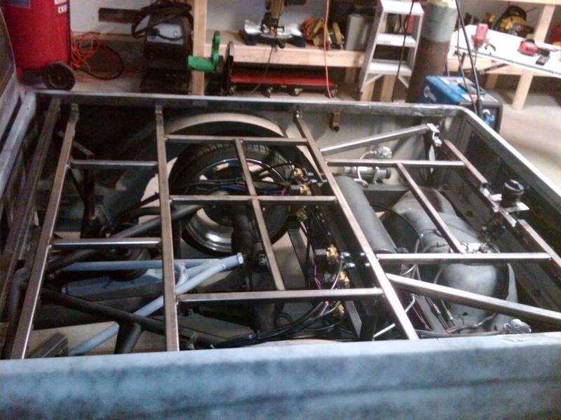

Here's mine on a 98 Tacoma. 16 ga. sheet over some 1x1 .120. I welded some square tube under the bed rail lip and then attached the bars to that. I could easily walk across this, but I built it to have a cover, not necessarily towing things. I'm sure yours would be plenty strong considering your skills.
