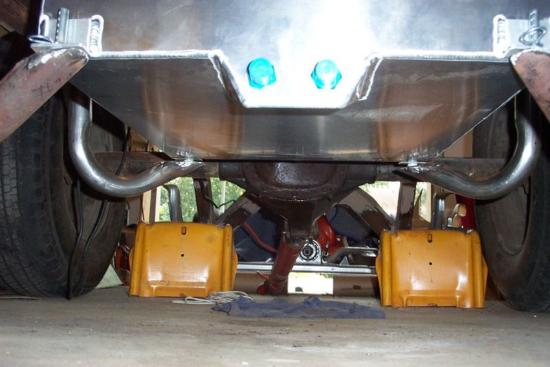

Here's what I made for my cell. It's a Jegs 20 Gallon aluminum.
onebadkota's avatar
onebadkota
I like the design....but do you plan on running any other supports under the tank? I dont think i would trust just the tabs as a sturdy mount..esp. with fuel in the tank...seems like the weight would end up putting a lot of stress on those and tearing them off...

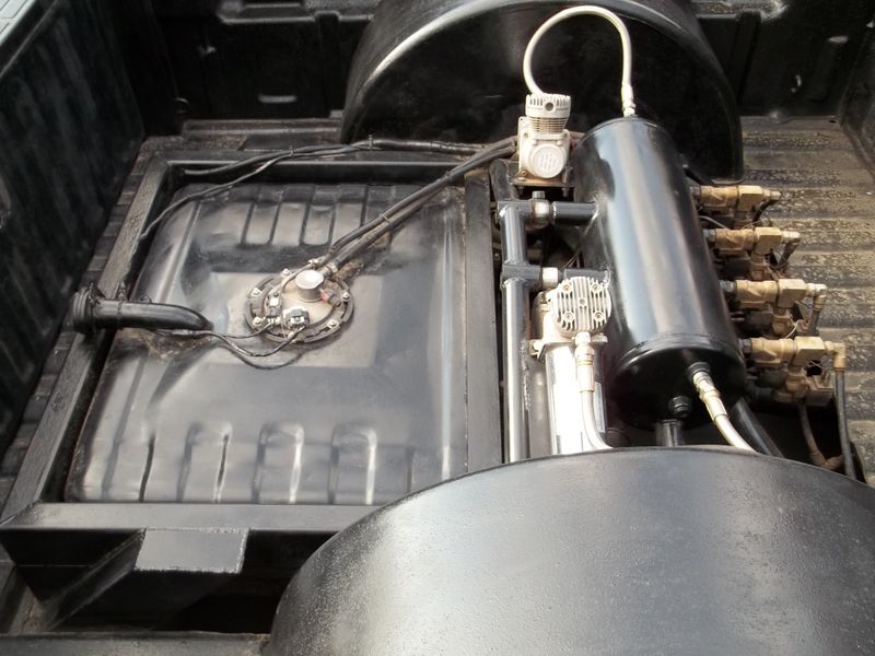

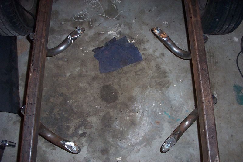

this is how i did mine its a gas tank from a k5 bronco

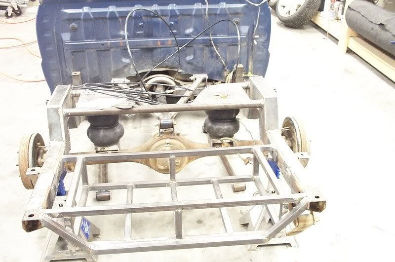

Funny you mention that because it just happened to a friend of mine a few weeks ago. The tabs ripped off the side of his fuel cell and it fell out of the bottom of the truck and drug on the ground, luckily he was pulling in the parking lot at his place of employment! I have also heard of this same thing happening to other people. Whatever you end up doing make sure to support the bottom of the fuel cell if it only came with those four tabs. I built an X out of square tube that mine sits on top of.

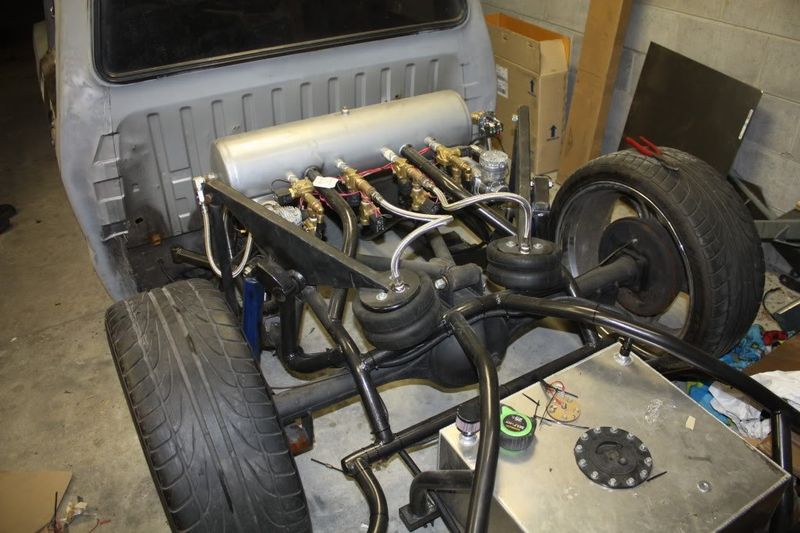

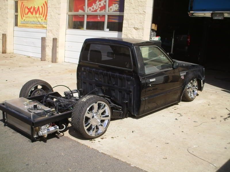

I went a little overboard on my 88 lolThis was my 92 not quite as beefy
