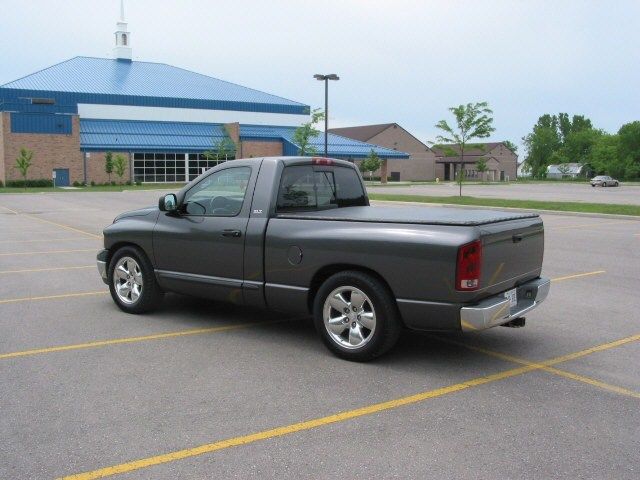

Heres the last picture of the truck I had before I put started working on it.... Just pretty much factory with a 2/4 drop.

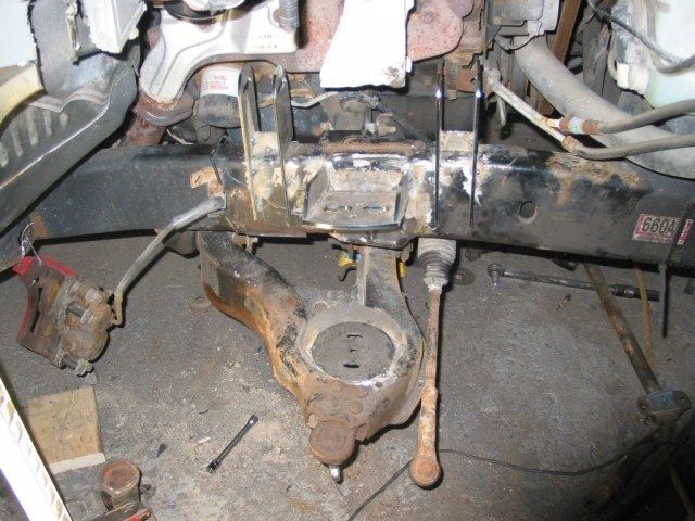

and here is a old picture of what I have of the front for a general idea what I did up there, it was unfinished in this picture.... Pretty much new upper mount and some raised upper control arm mounts...
