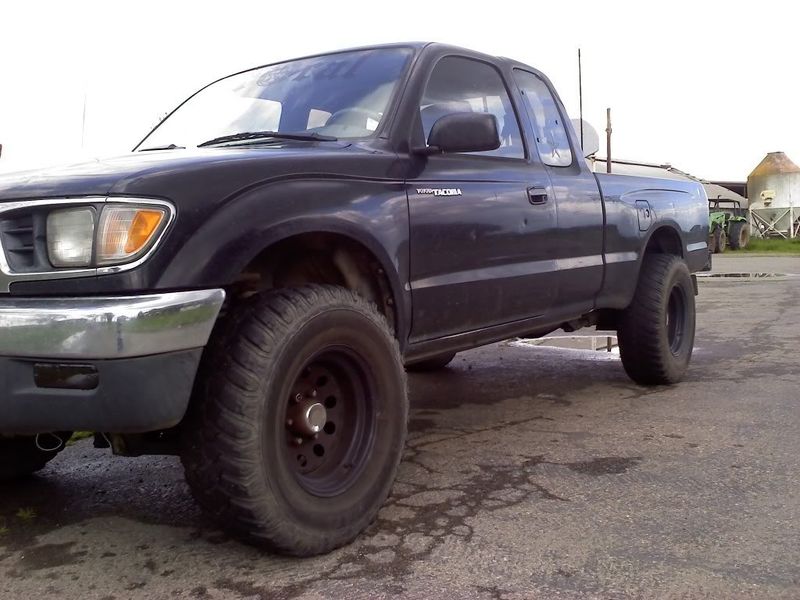

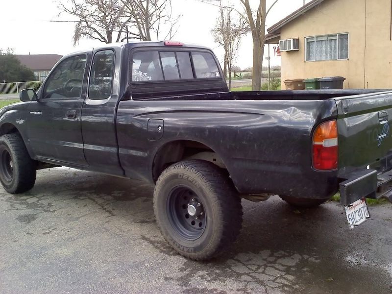

I had mine sand blasted and then painted them with black rustolium oil base paint thined out with astone and sprayed away. I go threw mud and everything else with them and no problems.
