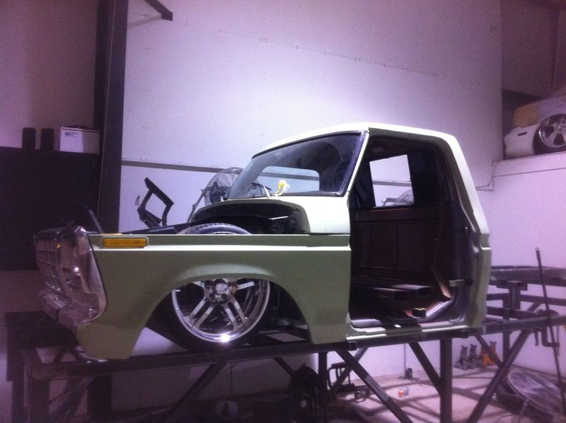

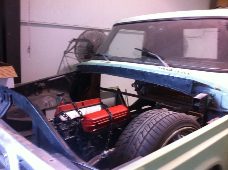

Hi my names is Teo . I am in the sacramento chapter of FREAKS OF NATURE. This is my 1973 F100 . I am building a new frame for it to lay body on 22s. I built the front crossmember and suspension using mustang 2 geometry with 3 inch wider tubular control arms. The rear suspension will be a t-bird irs.

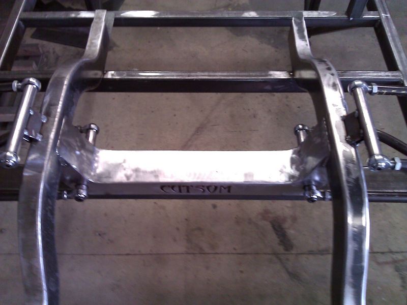

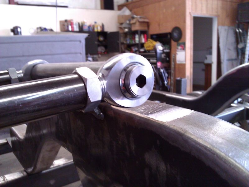

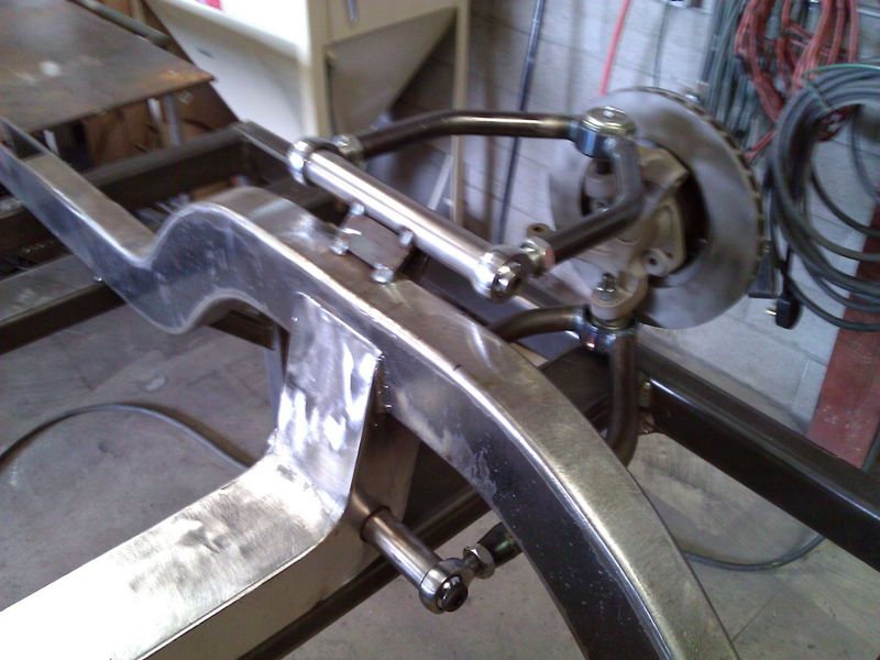

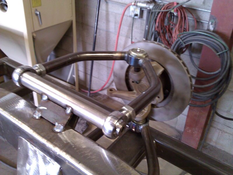

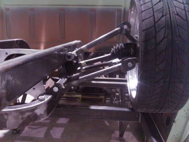

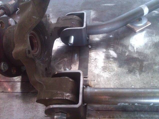

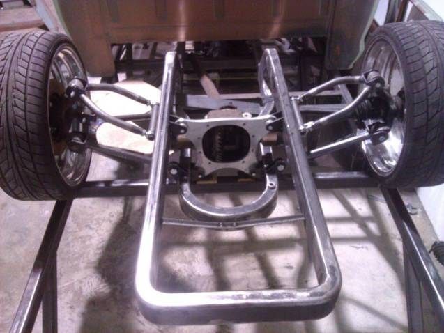

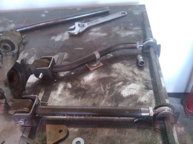

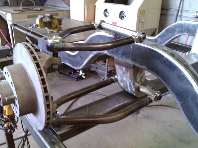

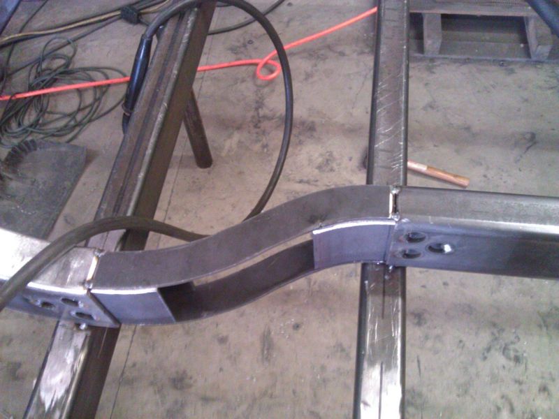

Thanks for the compliments. Heres is this weekends progress. The upper control arm mounts are temporary until we box them in.

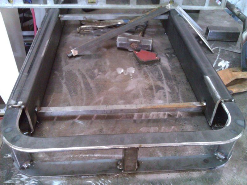

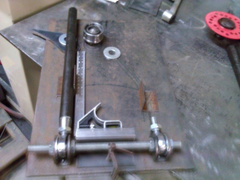

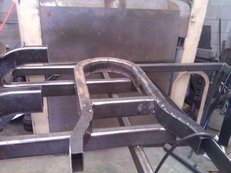

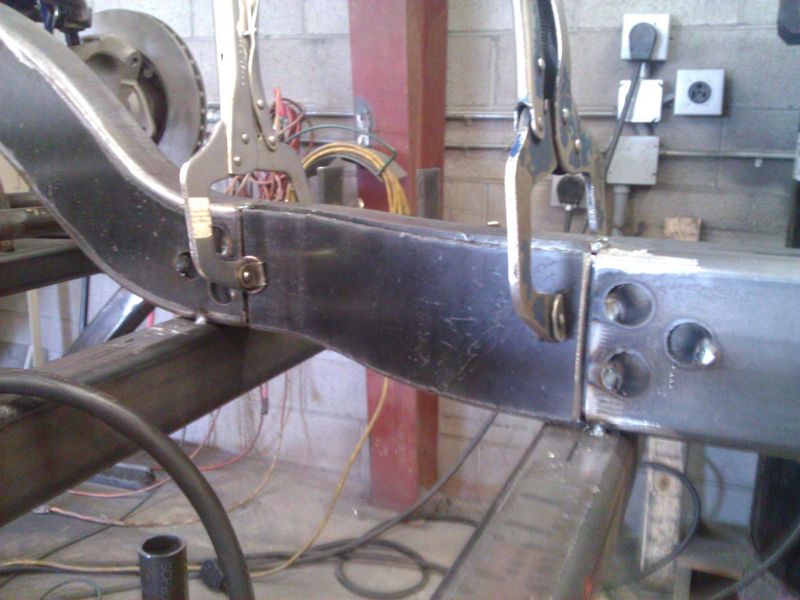

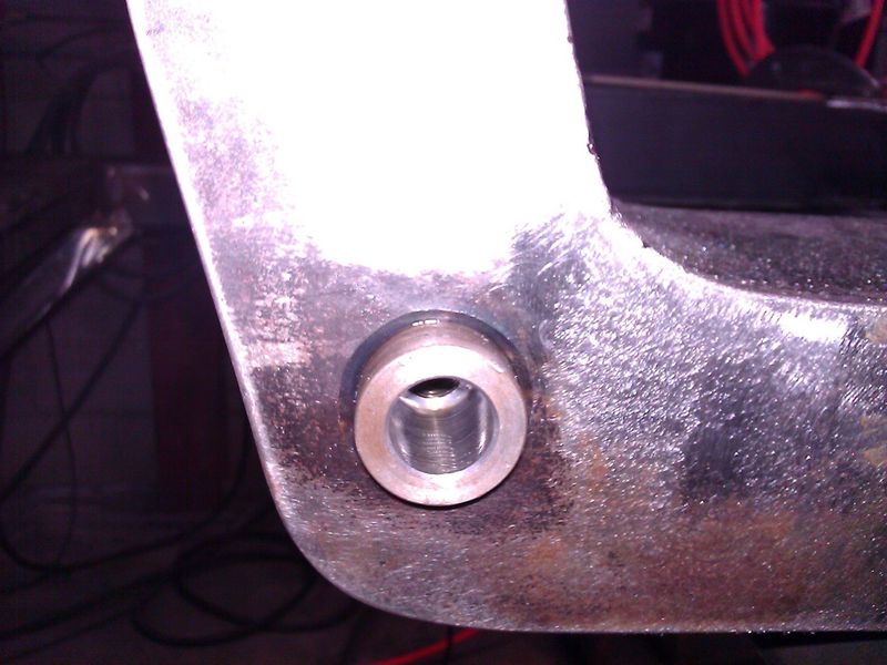

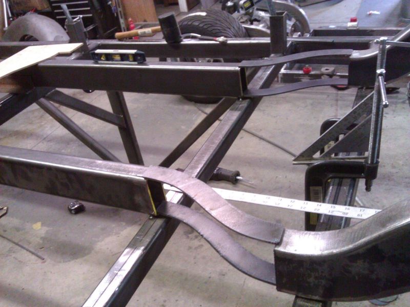

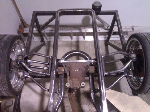

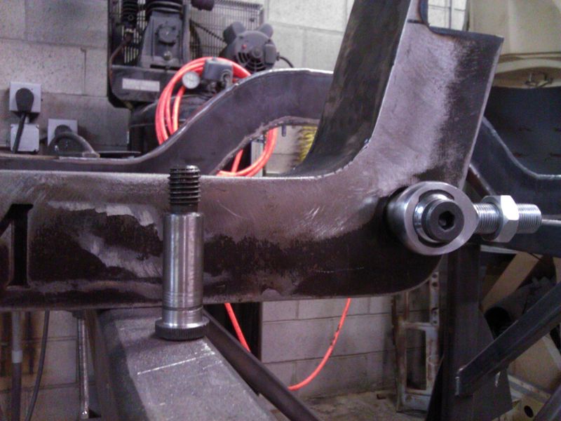

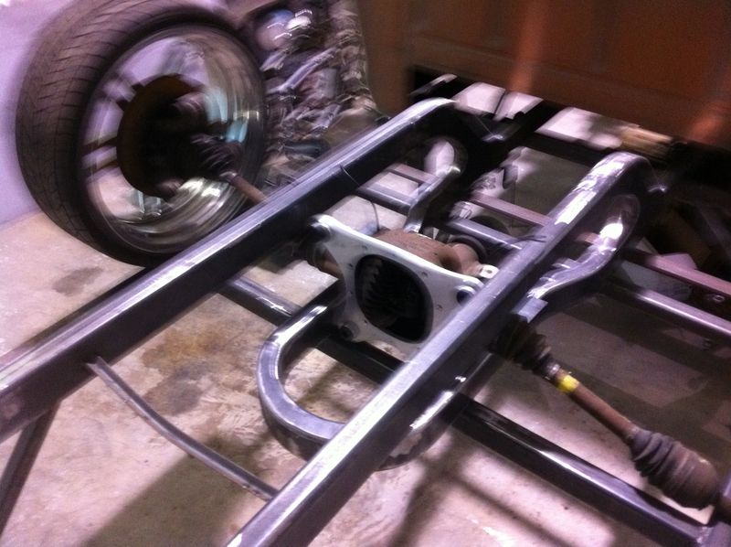

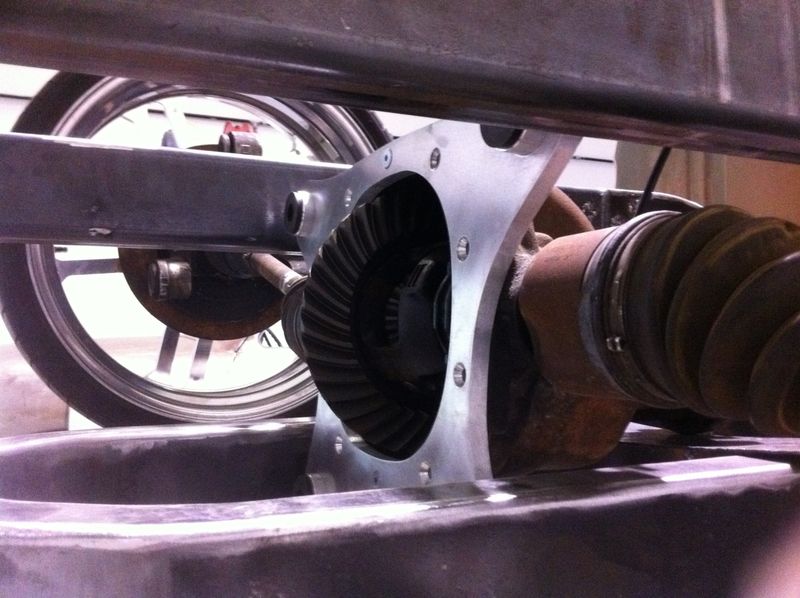

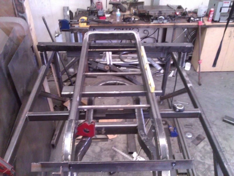

Heres a few pics of the progress on the frame
