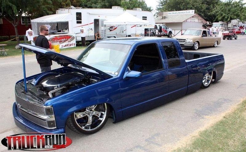

1992 c1500 2wd, Boss 304's 22x9.5 Chrome 5 on 5 +16 mm offset 5.810" backspacing. Tires are 265/35/22. Tuck with no problems
