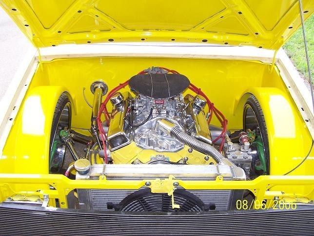

AON-4PumpedCL said:
Edited: 3/17/2011 11:50:07 AM by AON-4PumpedCL
Wow. 22" is really small! I just need it to be about 24.5" tall or less to fit under the hood of my hardbody (cut to the doors). I appreciate all the great info. Side drafts would sure look nice too.
Your going to have a hard time keeping that motor under the stock hood of a doored Nissan. My Nissan is true rocker, I cut the bracing off the hood directly over the air cleaner, and my oil pan (5 qt) is around a .500" off the ground when laid out. I cut about an inch off the air cleaner base as it is and I still have some minor rub marks on the bottom of my hood. I think it could be possible but it'll be tough. Even with a EFI motor the problem will be the slope on the front of the hood. Here's a pic of mine:
