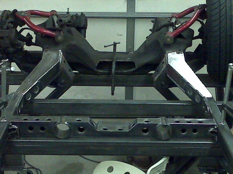

Heres one I did, its a 1st gen though. Shouldn't matter though because I think the chassis' are the same except the bumper mounts in the front.
sparage's avatar
sparage
Looks like a solid frame Chris. That's a hell of a fish plate.
BSGcustoms's avatar
BSGcustoms
hahaha yes it is, you could tow with that mini. It looks like it but it is hard to tell in the picture, does that tranny cross member bolt in?
unusualfabrication's avatar
unusualfabrication
Edited: 3/8/2011 12:41:33 AM by UnusualFabrication
I wanted to beef up that area because the rear section holds the air in the chassis. I probably didn't need the shear plate but it looked kind of plain without anything there and it matches the rest of the shear plates on the rear clip that you can't see in this picture.
The tranny crossmember has four 3/8" SHCS on each side.

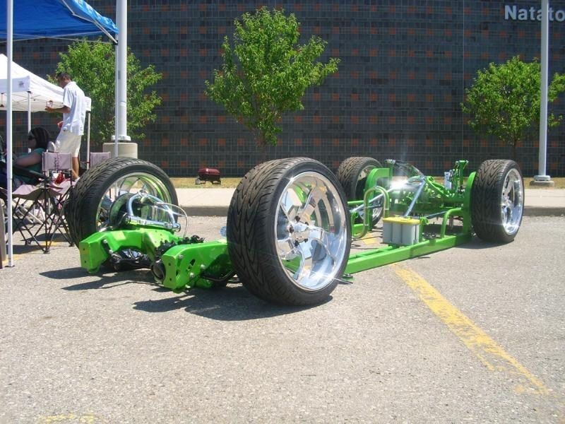

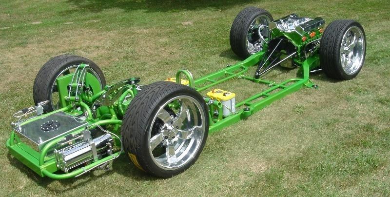

Heres one of mine from the past.
