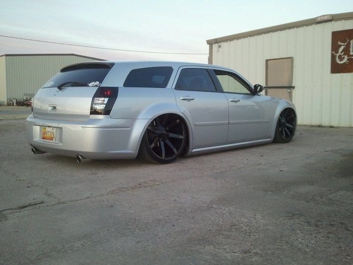

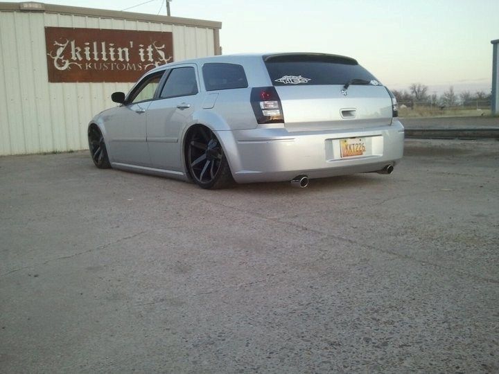

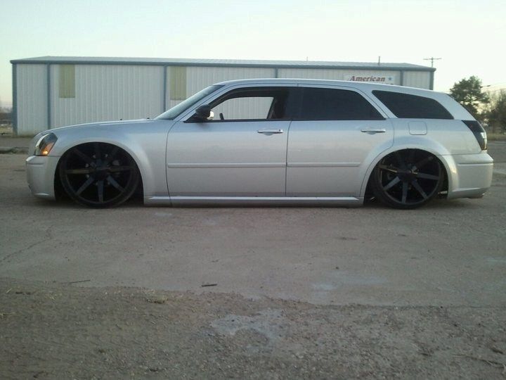

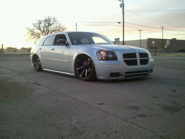

and now the money shots! after getting it detailed and ready to deliver back to jayden.
first, the new windshield logo for the ones that want it on the front instead of the back.
now the sexy shots.
i want one now.....
josh
