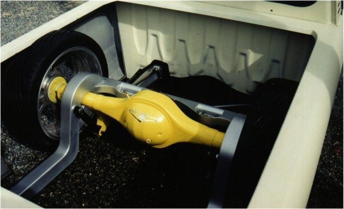

The guys that say you cant run them under the axle is wrong, DMK is correct. Since the tabs are welded to the axle, and the bars are spaced apart from each other, they stop the axle from twisting. He mentioned large wheels because the tabs will need to be of a great length to get enough spacing to keep the axle rigid.
I personally would not run them like that. If you dont have enough room above the axle, then run the upper bars on the front of the axle, and the lowers underneath. This will keep the tabs a shorter length and put less stress on the tabs. Here is a premade tab that shows exactly what Im talking about:

Here you go Cody, i'm assuming this is the one your trying to post.
