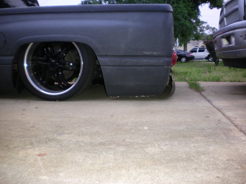

i have a 96 and i did research for a couple of months 2 years ago and i am running 22x9 they have a +40mm offset. but i still had to cut the lip inside the wheel well on the rear end.

my wheels are boss 331 22x9 +40mm offset. i would not go any lower than a +40mm offset.
BigWoodyStyle
20x8.5 boyds with 5.25 backspacing, fenders sit on the edge of the tire. need at least 5.75 backspacing to get them to tuck with stock rear end
