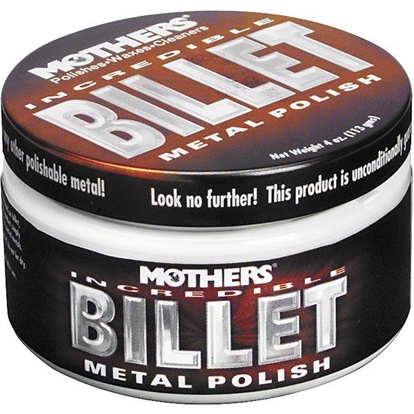

ditch the regular mothers metal polish and get yourself some mothers BILLET polish. night and day difference than the regular stuff.
if that doesnt work get yourself some wet sandable sand paper and wet sand the rougher areas. start with a rougher grit like 800-1000 then go to 1500 and maybe some 2000 then polish by hand. should yield good results.

thanks guys and I do have the new billet polish
