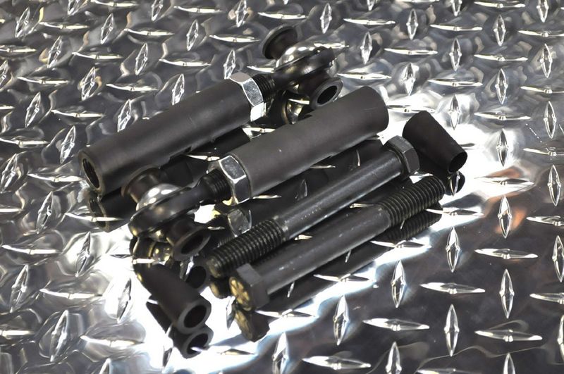

I make tapered inserts that press into a spindle and change the tapered hole into a straight hole, then convert it to a heim joint steering, with whatever amount of drop down the customer needs.
The steering kits i make look like this:
