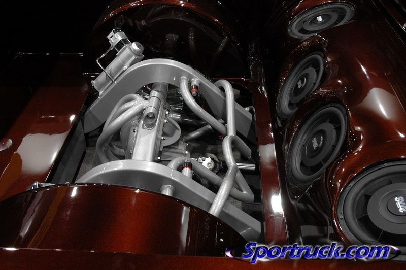

This wishbone is similar to what you are trying. Wraps behind and under the axle.

the only thing the suspension can see is the pivots so you can have the tubing going how ever you want becaus ethe suspension will not know the diffrence
