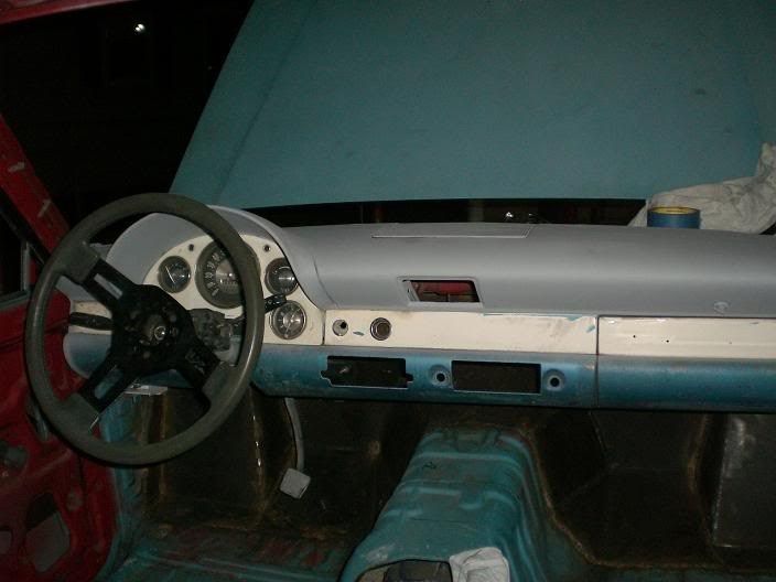

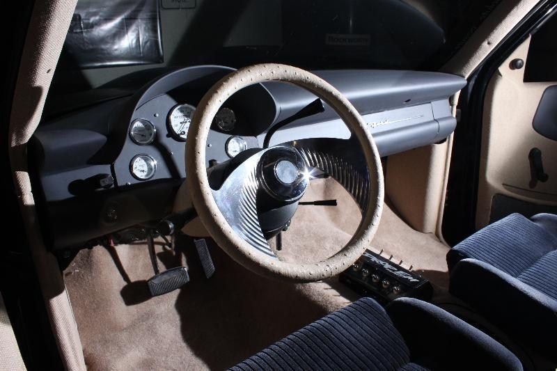

56 ford fairlane dash in mazda
1950 views
15 replies
fuknlow25@yahoo.com's avatar

same dash is going in my ranger

looks awesome

Same dash is in my ranger! lol!

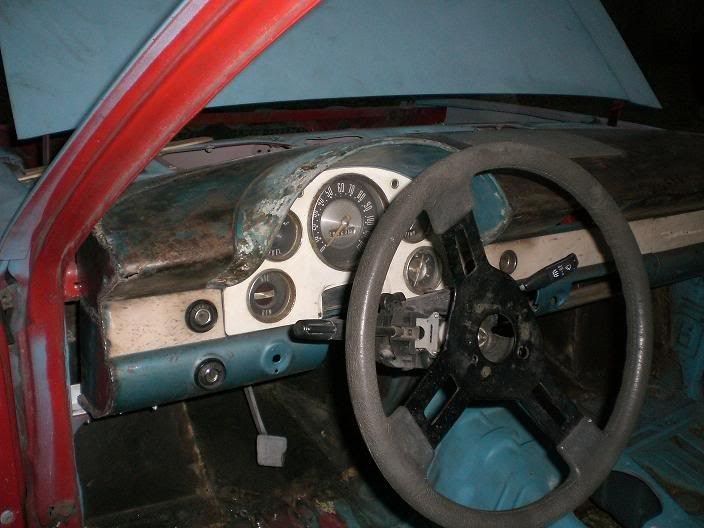

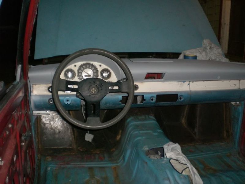

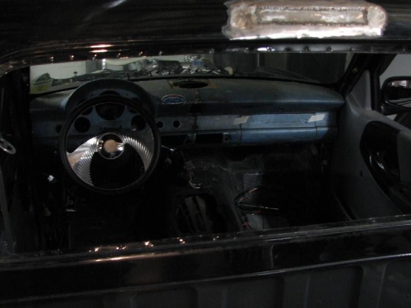

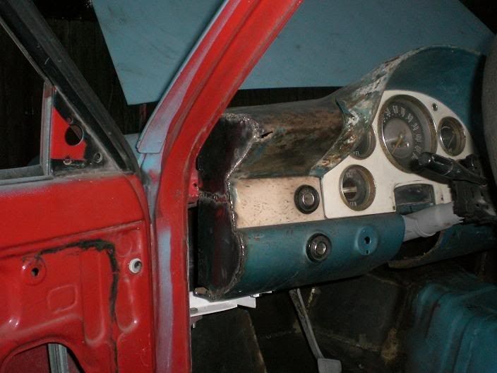

Looks good! Mazda cab must be wider inside, on mine I sectioned 2 3/8" out of the center (right through the middle of the speaker grill and the ash tray opening) and cut off one inch on each side and capped them like you did to get it to fit and line up with the steering column. You can see it here >>>>
fuknlow25's avatar
fuknlow25
yeah i think mazda is wider ... cus it was like 1" of the driver and like 2" of the pass.. ... lucky i didnt have to cut it down the middle

well it is the nicest steel ford dash!

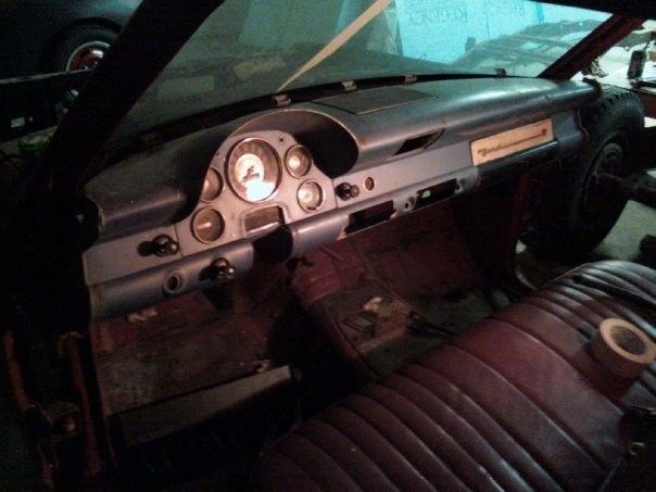

Yes it is, I didnt even know what mine was. Stumbled upon it walking through a swap meet at Charlotte motor speedway in the spring of '07, picked it up took it home and cut it to fit. At that point all I knew was is was from a 56 Ford. Had to dig around online a bit to see what it was from, lol.
