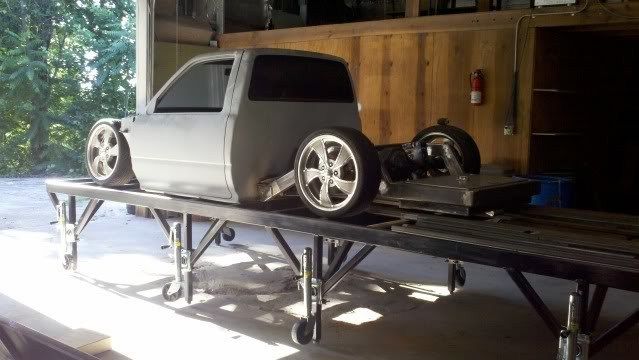

been on here for a long time but don't post a whole lot,thought I'd whore out my truck on here too,lol!here's my 91 standard cab,had this poor thing about 15 years,and been working on it on and off the last 12ish,life,money and time have kept getting in the way,it's had 3 different motors,been body dropped twice,and working on it's 3rd 4 link,anyhow,here goes...I had it bagged&4 linked back 10+years ago,on some eagle 17's,a phantom grille and some 4x4 fenders,lol.
drove it around about a year or so then had it bodied 2in.to the pinch and sprayed flat black
but....wasn't low enough,so cut it another 1.5in. to flat rocker,shaved almost everything,and got in primer

had been driving big trucks about 3 years at this point and had to sell the house,so the truck was put in storage for about a year or so,got the new garage widened and bigger doors,so threw the cab and bed on top of the frame and brought it to the new lean-to shack I call a garage

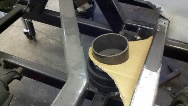

got the truck finally back inside,plan was to just re-do all the air-ride,finish the suicide doors,put the 22re back in it,paint it and interior
14 gallon spun aluminum fuel tank,walbro inline fuel pump,1/2in asco nikel plated valves,8.5 gallon aluminum air tank.al's bed liner

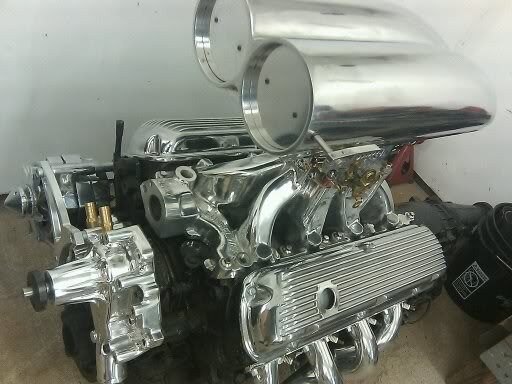

was about a week away from throwing the 22re back in and was hanging out at my brother in law's garage,and my buddy with a mighty max with a 350 small block was doing burn outs and got me wishing I had kept my v8 swap.next thing I know we're standing at the back of the shop looking at this ford 5.0l 302 with a c6 tranny.lol
then that led to this...

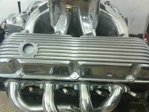

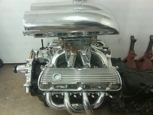

holley lo-rider avenger 670cfm carb,parker racing funnel web intake manifold,tuff stuff 100amp alternator,march performance alt.brackets,edelbrock water pump,finned valve covers and a polished scoop

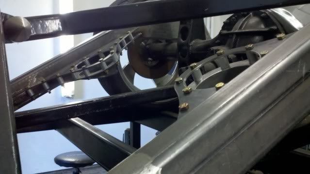

got a ford 9in rear with a 2:75 gear ratio,this truck won't be drag raced,that gear is for interstate speed,cause I plan to drive it everywhere next year show season,maybe even wcn.good thing about the 9in.is I can change out the whole 3rd member for a lower gear if the2:75 is too high.

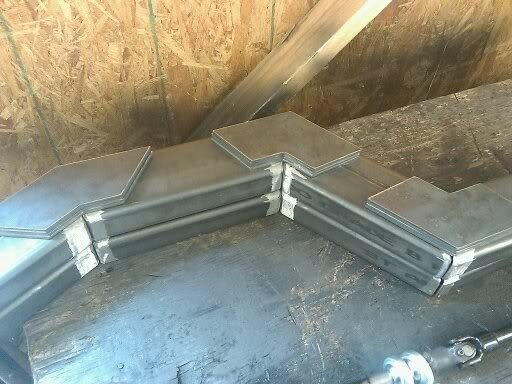

waiting on axle's and disc brakes from moser engineering,then new 2x3 back half,new ALL FORWARD 2x2 4 link,gonna throw the spun gas tank on the taco and go with a fuel cell instead,hopefully a set of air flow research 185cc heads,matched cam,150 shot of nitrous,should put it somewhere around 450hp before the bottle.still got a whole lot of little things to fix,hope to have out for show season next year.

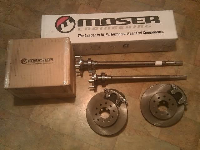

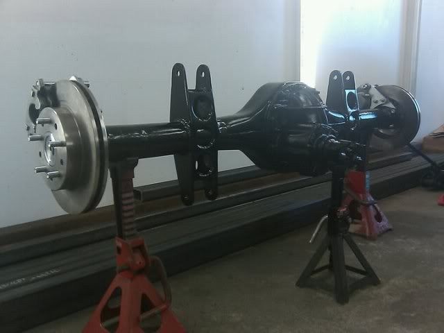

thanks everyone! ryan and bill hit me up fo sho!!lol. well,axles and disc brakes are here :D

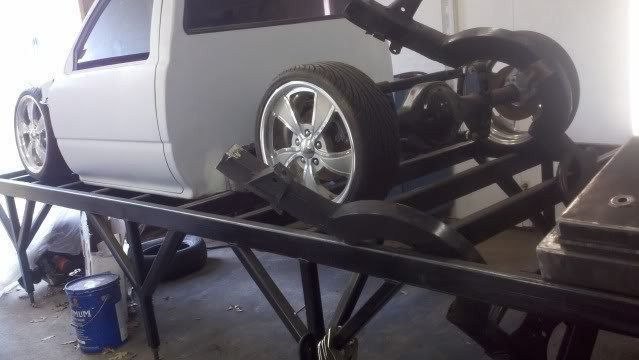

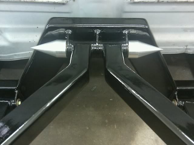

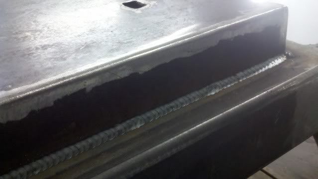

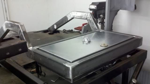

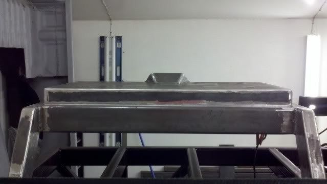

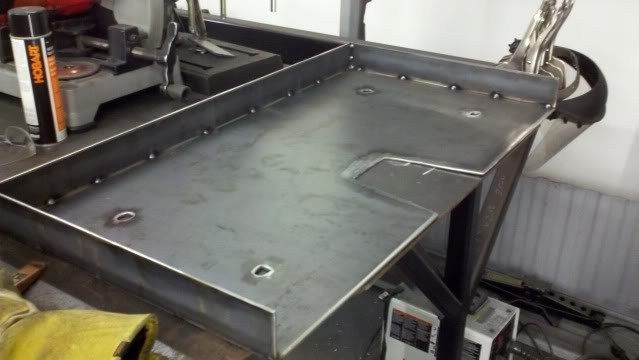

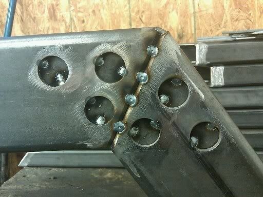

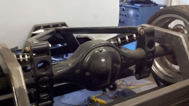

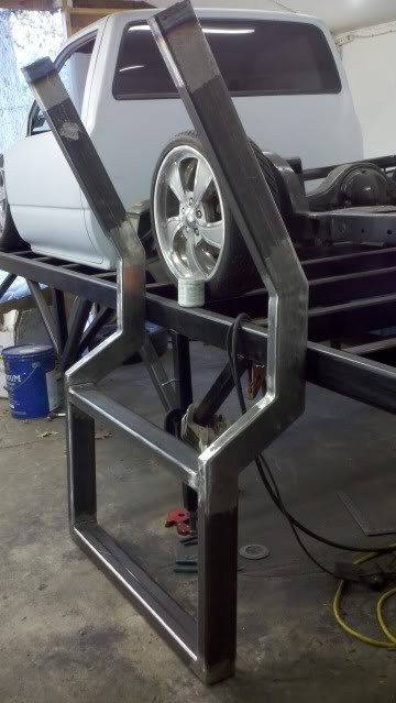

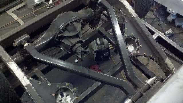

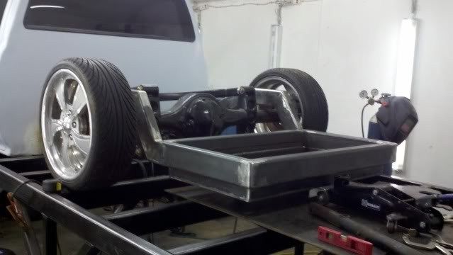

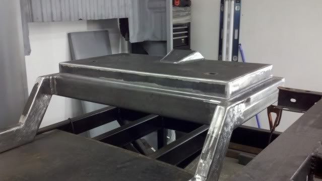

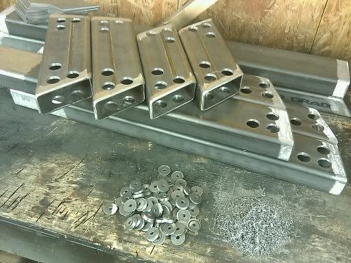

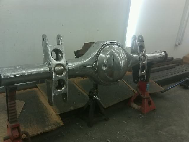

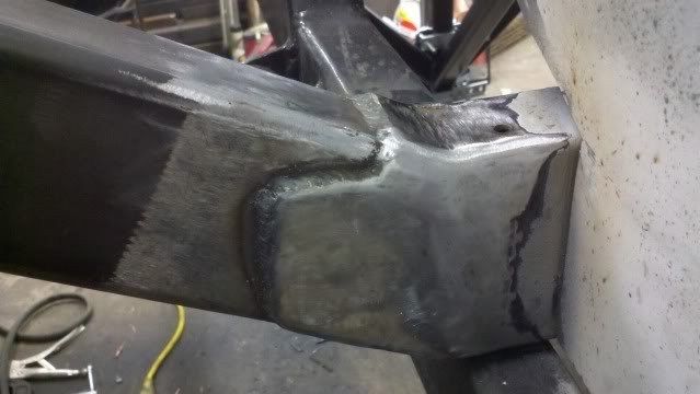

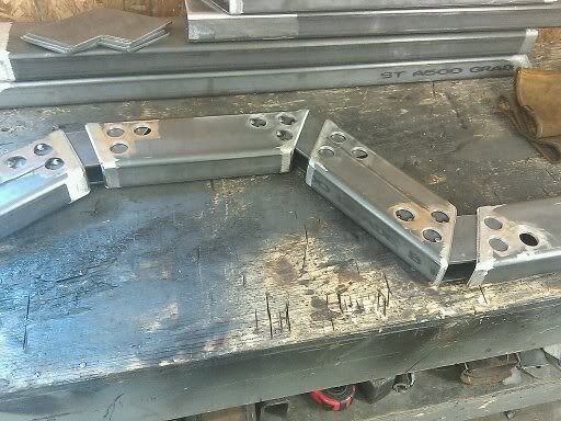

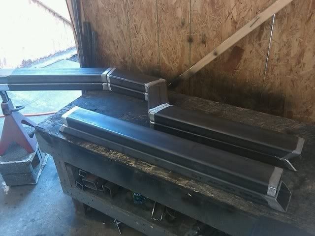

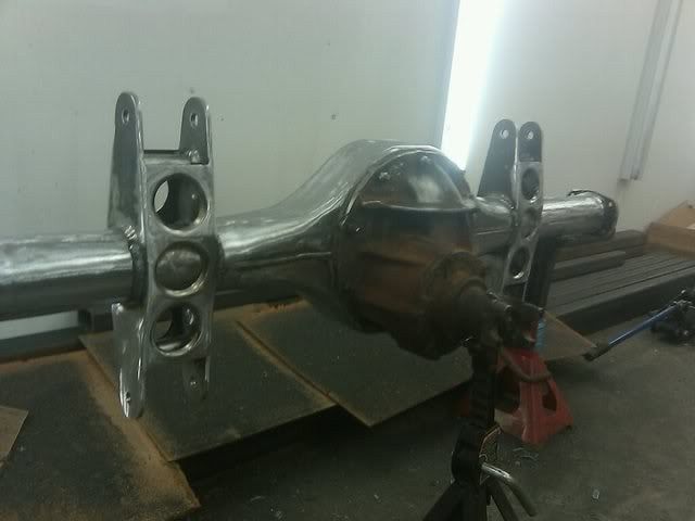

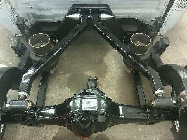

axle done,4 link done,working on the steering & got the backhalf cut.

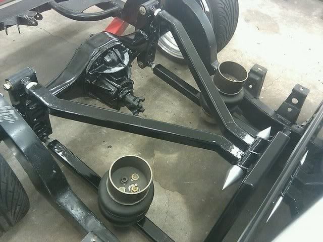

I was so happy to see the reverse 4 link go! Looking through it I couldn't help but admire the amount going in, all ruined by that reverse 4 link.
Keep up the good work!
