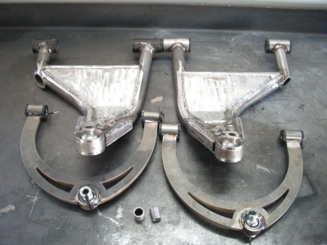

Or you could buy some control arms that will lay out on a 31" tall tire WITHOUT cutting the frame for the arms and will allow you to turn while driving low...

$950 shipped anywhere in the U.S. Comes with an insert for the lower ball joint taper, the upper taper on the spindle needs to be drilled for the new 5/8" bolt through the uniball.
