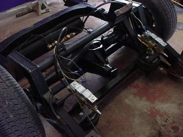

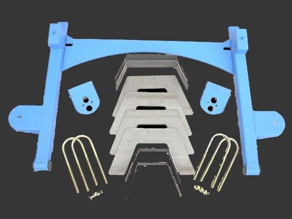

I don't know how Mazdas are set up, but here is a two link set up that Silver Star Customs runs alot, the picture in blue paint. I built mine based off this model, except I ran my bags on the inside of the frame. I used the stock leaf spring pearches near the cab for the pivot point. The system uses no panhard bar, so don't expect any articulation from your axle, I mean any. I used lift blocks and the original four bolt plates to bolt mine to the axles. Its more like a one link, but cheap and not a whole lot of brains needed to do. Probably wouldn't want for a daily driver though, which mine was never intended to be. Mine is the one in black and the the only picture I have at the moment.

aren't the stock leaf hangers are lower than the frame on mazdas?
Also, the great RussD once said that the mazda frame is too low for a panhard bar, so it seems like linking the bars together like the above picture would be better.

Why not just do a mono leaf/step notch/airshock combo on the rear if budget is your concern? By far not the best setup in the world but you will at least get some axle articulation out of it and your pinion angle will be a little better than a 2 link will offer. It will be less work and cheaper for you too.
bumlove_blue's avatar
bumlove_blue
I have a 2link like silver starts too, mounted bags on out side and tied the 2 sides together with box tubing instead of plate steel...only problem is you have 0 side to side so it does do 3 wheels on the rear....and the pinion angle is ok in certain areas...
