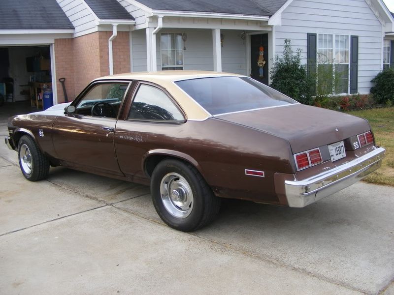

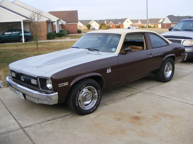

This is what I am painting, 77 Nova.

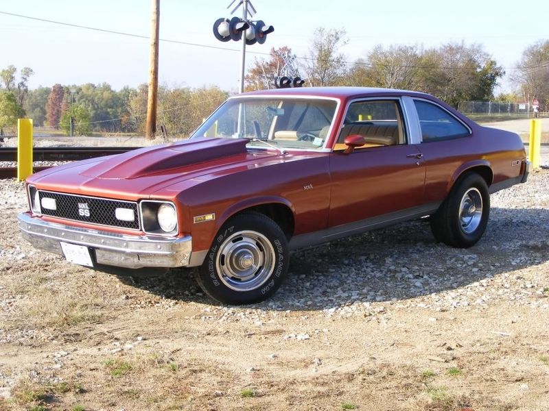

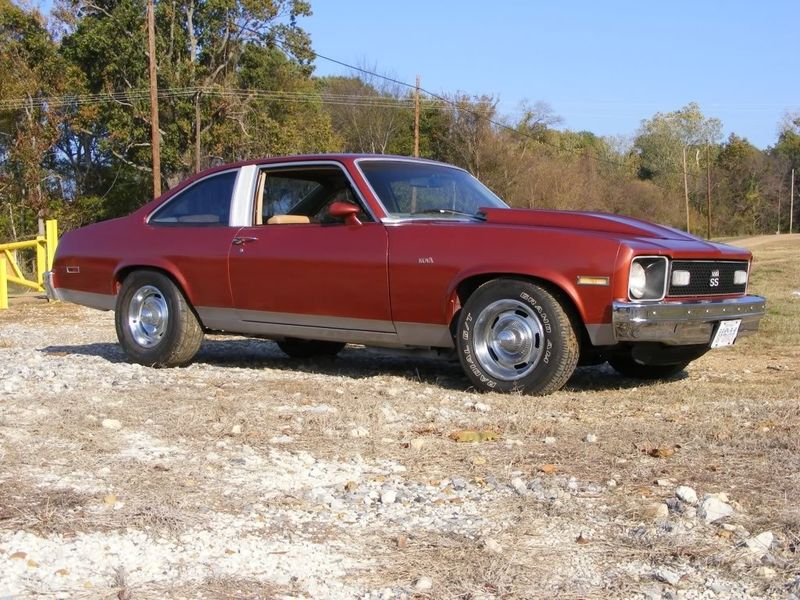

I finished up that car and got it back together, it came out pretty good for a first time paint job. I have to say from start to finish that is a job. I have a new respect for people who paint cars for a living. By the time I got completely done, I was wore out. The customer was super happy with it though.
