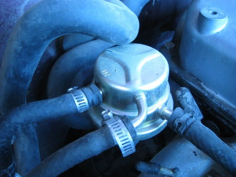

ok so i have 2200 with the weber on it and it has electric fuel pump but i want to run the stock mechanical pump but the lines have all been blocked off exept one to the electric pump but there are 3 lines on the pump anybody got an idea which lines go where

This is about all I got.
kaoss's avatar
kaoss
From left to right in the pic, there is an in, a return, and a to the carb.

yeah its got the stock fuel filter on it and comes out of the metal line to the filter and back to another line back to the tank then a 3rd comes up and goes to the electric pump then to carb so i guess im just gonna start tryin things there is only 3 how hard can it be
