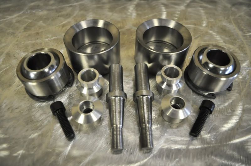

Chevy full size upper ball joints are not the same taper, they are too small and rattle around in side the spindle, which is a terrible idea.
Whoever told you that uniballs make noise, sounds out of their mind. Ive never heard a peap from them before...
This is what I use for uppers.

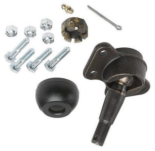

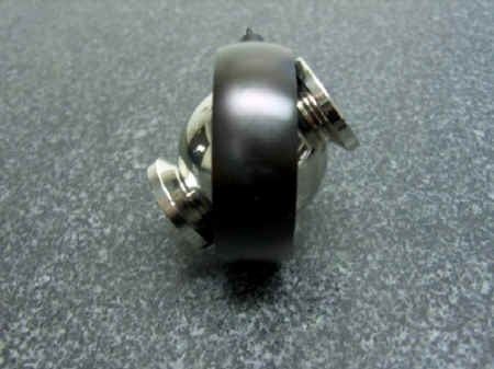

The Chevy ball joints I bought are .860 at the top of the taper and my Dodge joints were .750. My plan was to ream them like I did when I flipped my lowers for the Chevy joints. I do like that set up you got there. What about something like these Jimmy Joints?Here is a pic of the joints I bought.
jeebus @ mmw's avatar
jeebus @ mmw
oo, if you plan to re-ream the spindle, then you can put anything you want up there, it really wont matter. My first choice wouldnt be a full size chevy ball joint, but im not fond of ball joints that bolt into a place. I would use a screw in ball joint.
I personally wouldnt use those jonny joints, to much slop. but to each their own.
